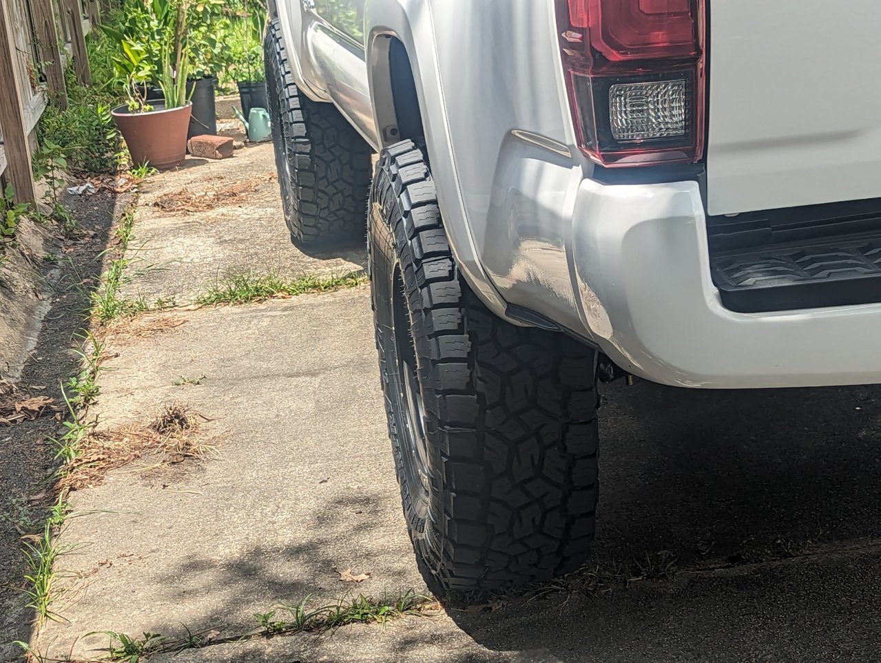

    what size tires?
    I would say cut it away until it clears

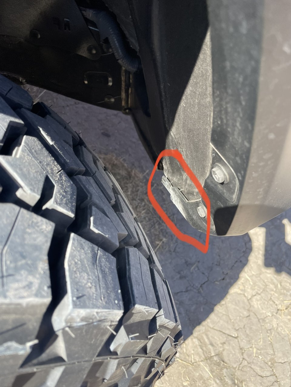

    just 33’s…any tips on cutting? Do I cut just the plastic? What about what’s behind that? I see the metal pinch weld.

    With a -38 you'll need a cmc I barely cleared on a 0 offset and 285's.

    Cut the plastic, hammer the metal. Rinse and repeat until the rubbing goes away.
    If you plan on off-roading you will want/need a CMC as well.

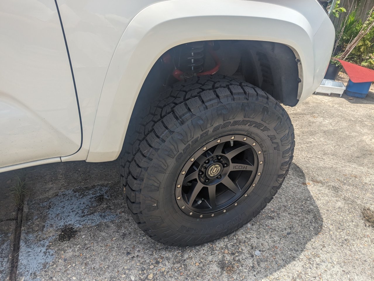

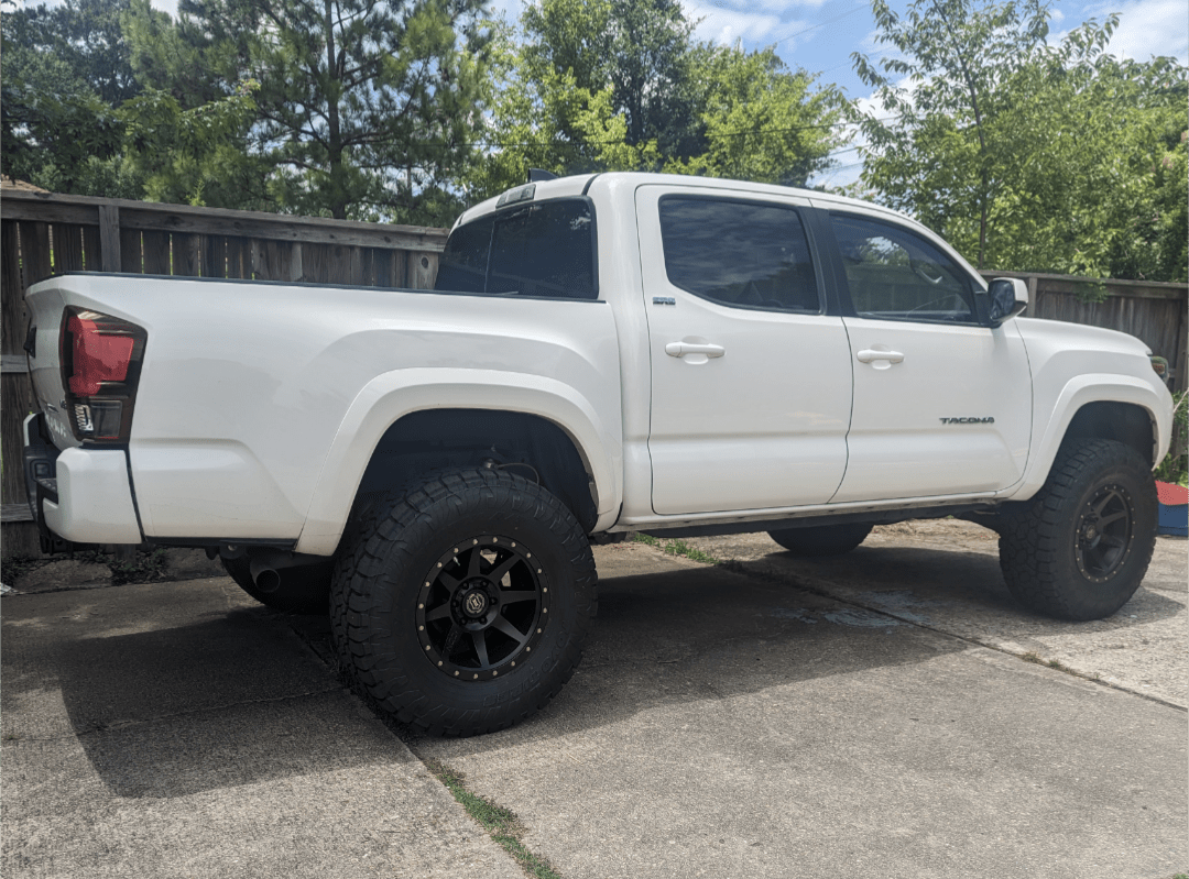

    Freshly mounted Toyo Open Country AT3 35/12.5/17

    What have you done to make them fit?

    JBA UCA, 4" front/3"rear. .75" Boras spacers, CMC, pinchweld, and some plastic cutting. Still rub a little at fulllock on passenger. I might do a CMR later on.
    Toyo's measures about 33.3" mounted 30psi. Unmounted 34".
