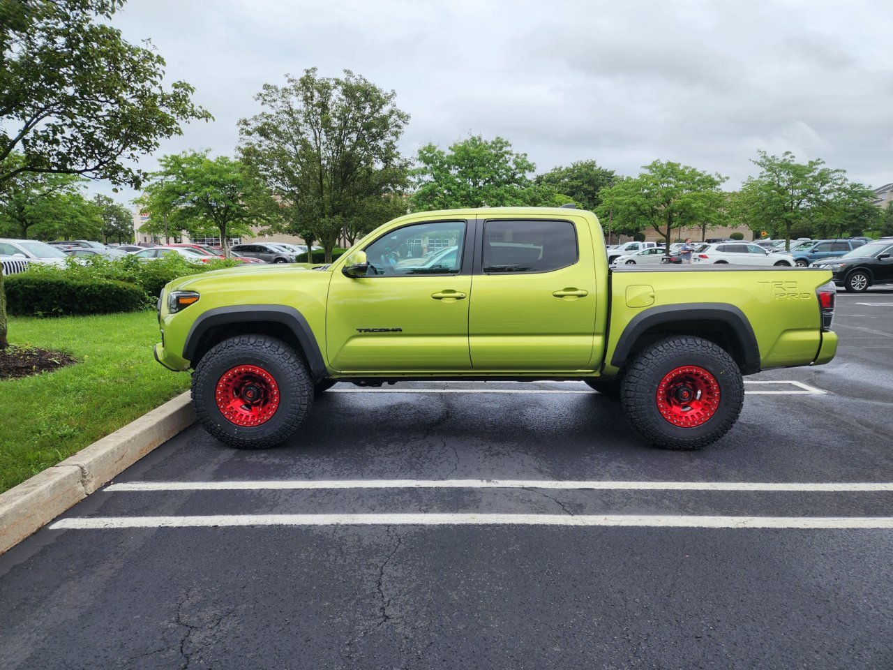

    Just got my wheels and tires on. 17x9 et-15 running 35x10.5 kenda klevers. Still need to flex it and trim more but its drivable around town. 20230716_120929.jpg

    I like the color combo.

    That truck is so ugly that I like it

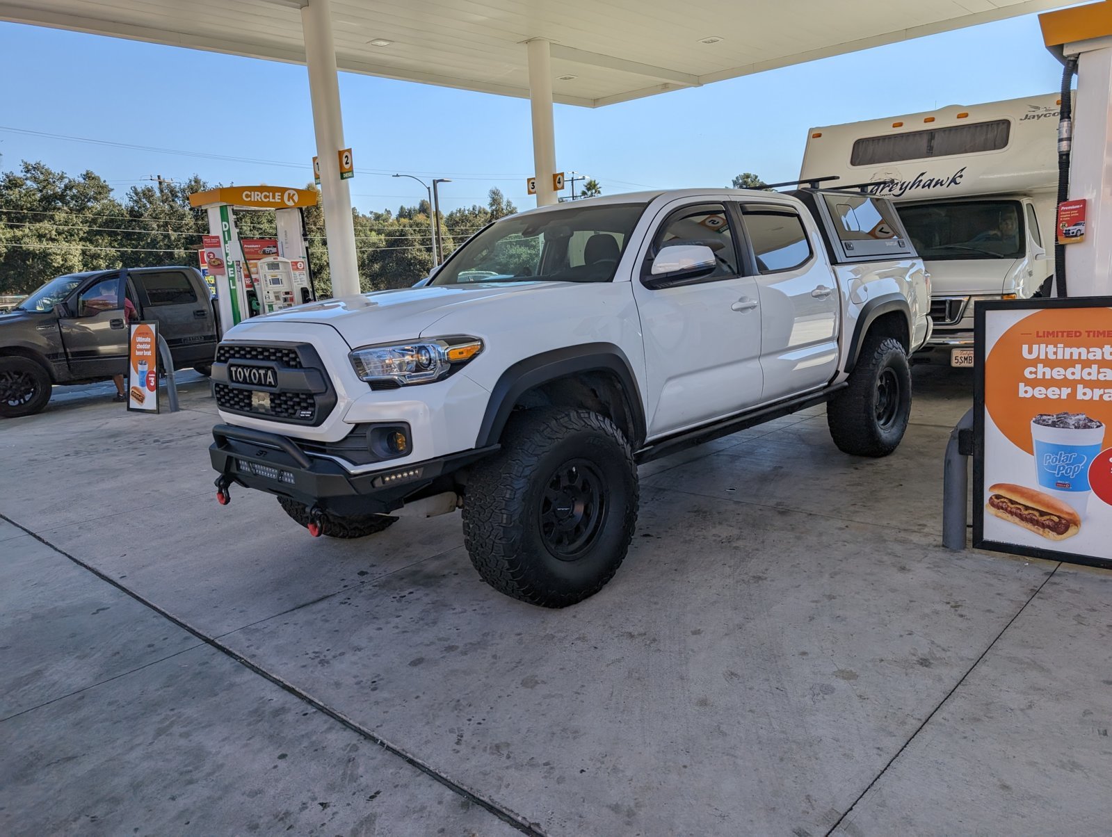

    Prior to making the leap from 33's to my 35" Falken AT's, I had seen enough Tacoma's do so without trimming the rear fenders. Now that they are on, I am thinking that at full stuff, those tires are going to cause some damage. Can someone post a photo of their rear tires stuffed into the wheel well?

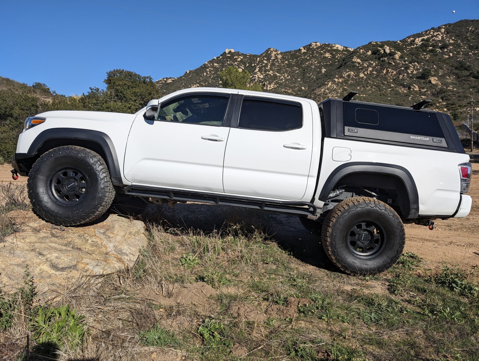

    35x10.5 tire and shock relocation with a 12" stroke shock in the rear. No trimming needed.

    Those Kenda 10.5 wide tires seem like the move. I have 12.5 wide with the shock relocation and it would definitely give me some peace of mind having a little space.
