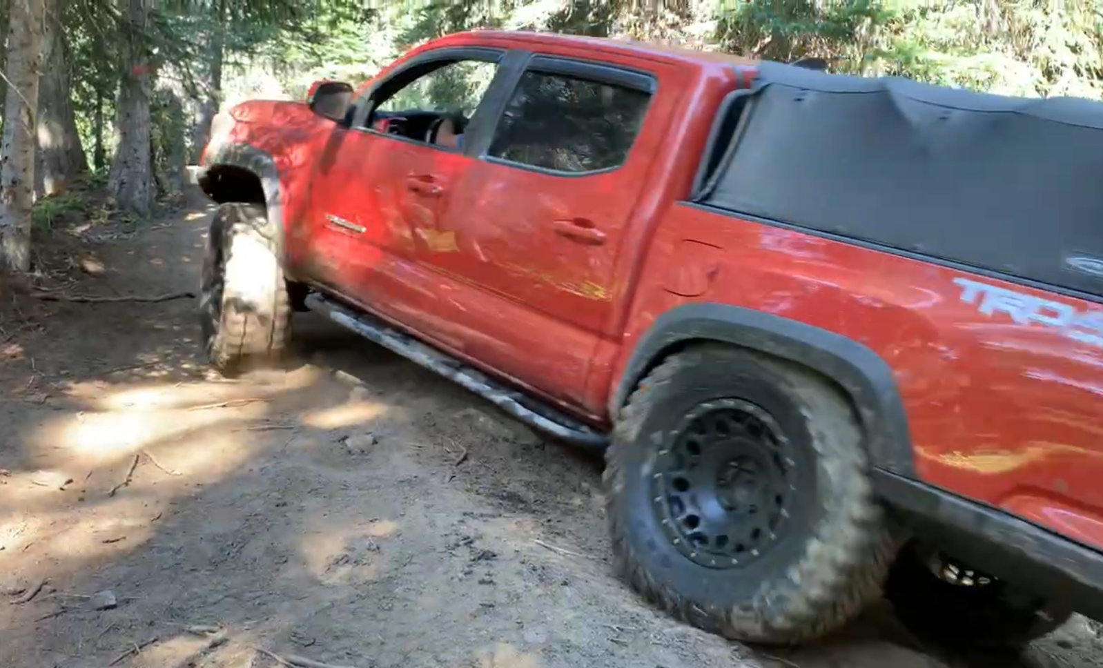

    Depends on the width of the tire wheel offset. Forgot the offset of my wheels but they’re pretty wide and I needed to cut off the bedside supports and a bit from the bedside.

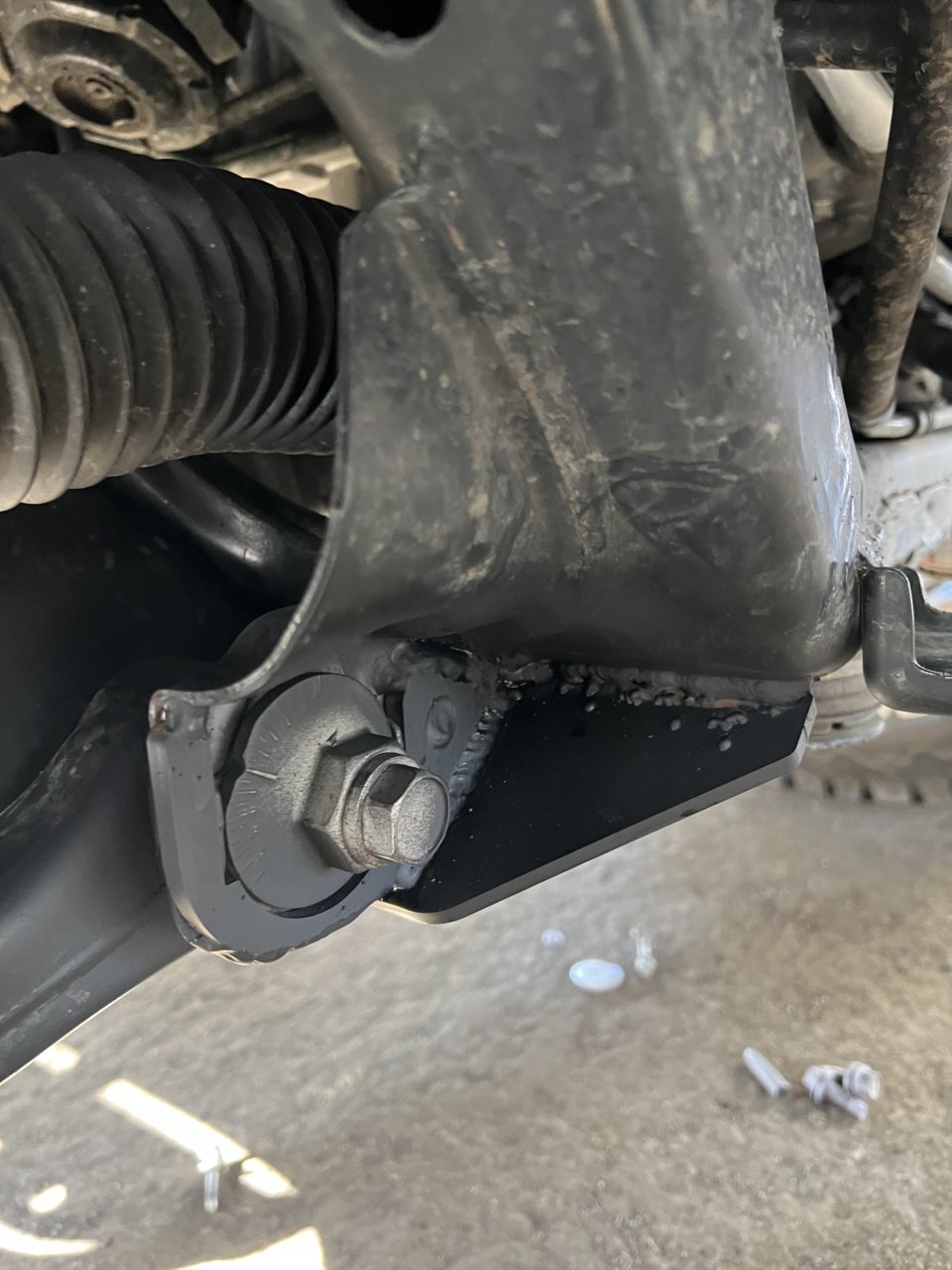

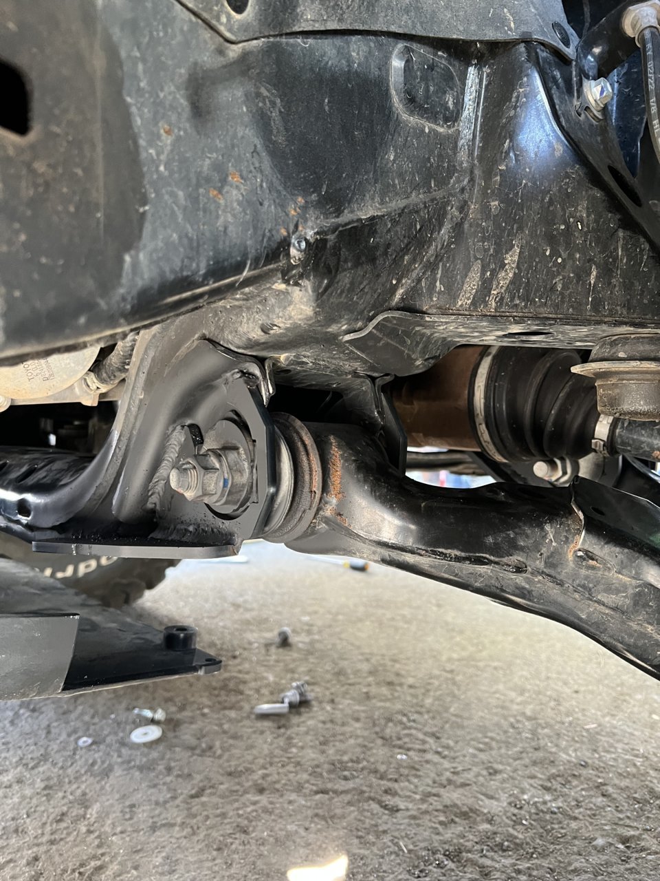

    Real dumb question, but can you weld these on without removing the lower control arms? I'd like to do this at some point, this summer, but my truck is my only vehicle at the moment and I don't know if I can get everything apart, welded up and back together fast enough to get an alignment before I'd need to be able to get back and forth to work. Also, I don't see a 3rd gen version, are the frames the same between the 2nd and 3rs gen trucks?

    You can but you have to be very careful. The LCA bushing are rubber and if you don't take your time on the weld, you'll melt them.
    There's some details in the Marlin thread.

    Plenty of posts there and the marlincrawler board welding them on with everything on the truck. I'll keep wet rags tucked up around the bushings, alternate sides to reduce how much heat in any given area and give it a go.
