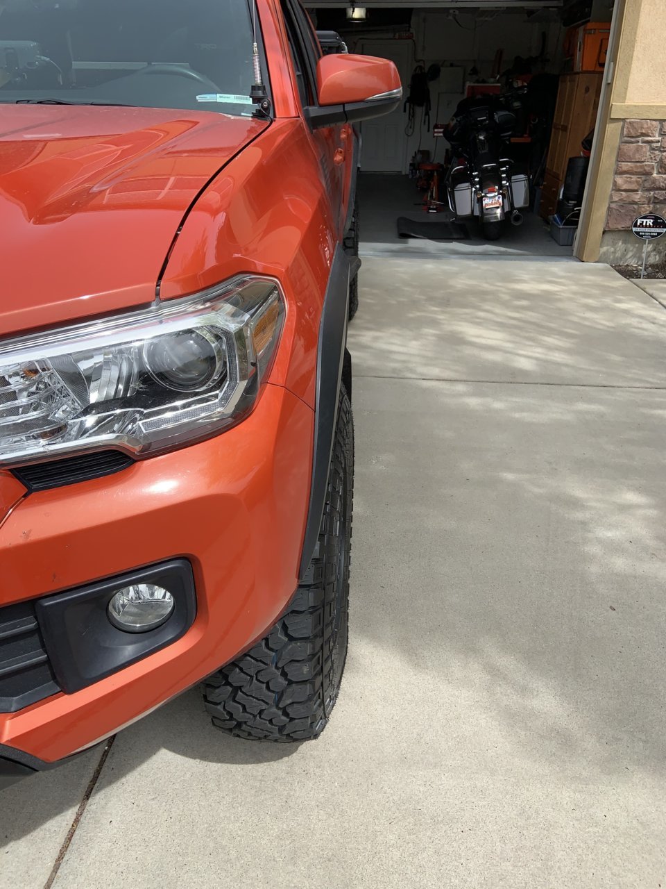

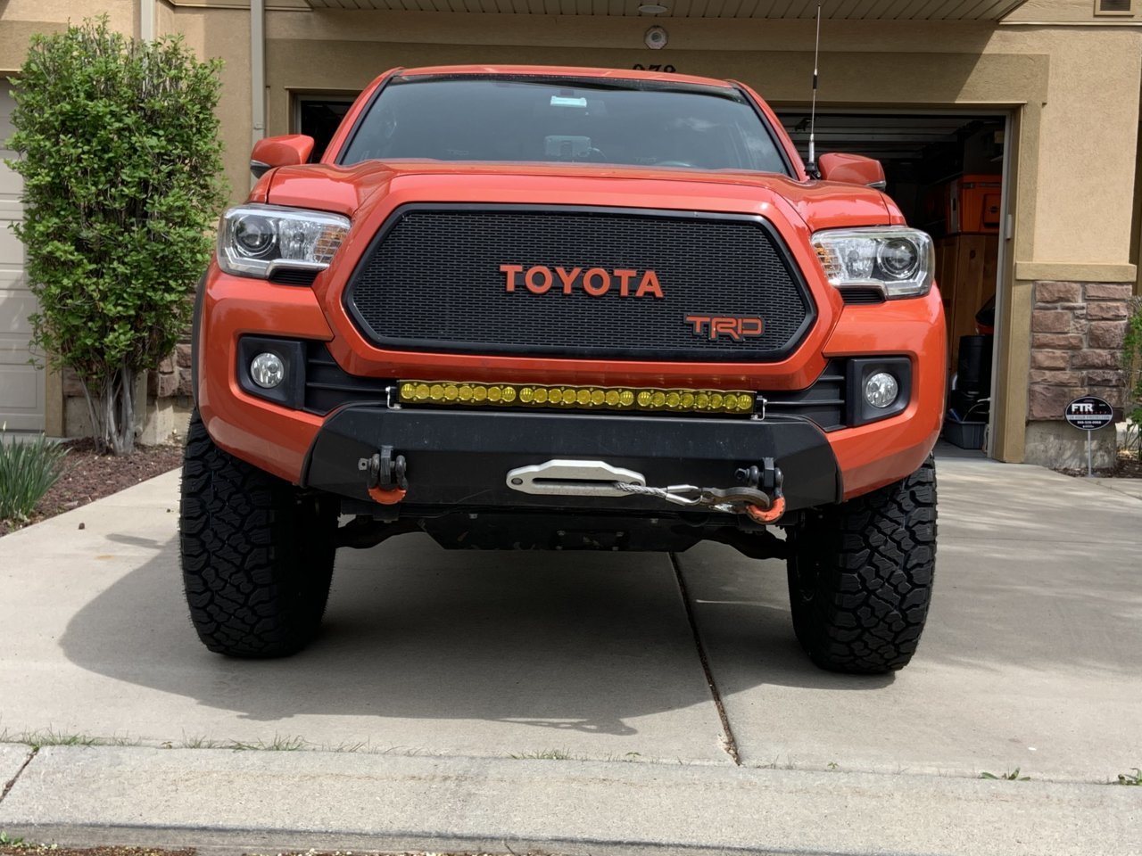

  14. Apr 25, 2020 at 4:22 PM
    #674
    Glenn_R
    Glenn_R The Unicorn Turd Gen
    Nov 8, 2016
    #201874
    1,150
    Glenn
    17 Tacoma DCSB OR Inferno
    Finally got them on. CMC, LCA full forward, seam smashed, and front top fender well beat in. Not rubbing on the street. They will still rub at full stuff on inner front fender well. That needs to be tubbed as I want full up travel for wheeling. Method Race 105s 17X8.5 Offset 0, Tires Kenda Klever 35X10.5X17.

  16. Apr 25, 2020 at 7:19 PM
    #676
    CP40
    CP40 Well-Known Member
    Mar 7, 2020
    #321526
    195
    Toyota Tacoma TRD off-road 2020
    Looks good! I'm getting an icon stage 9 lift, with icon rims (17x8.5 BS:4.75) and the same tires on a 2020 off-road. I was willing to do CMC, quarter panel trimming, and pinch weld flattening. I was hoping to get away without having to do tubing and still having nearly all the travel. How much rubbing is there without tubing?
  17. Apr 25, 2020 at 7:57 PM
    #677
    Glenn_R
    Nov 8, 2016
    #201874
    1,150
    Glenn
    On my truck I had about 1/2" gap between bump stop and LCA when tire contacted the inner fender with the tire turned in. after hammering got to about 1/4 gap and bump stop. If you don't wheel it wont hit. You can also put bumps in that have spacers to limit up travel. I just don't want to limit up travel.
