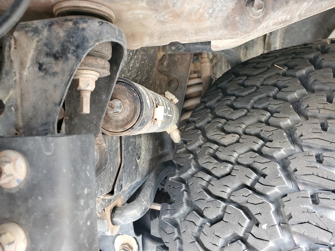

    I just sampled my friend's 315/75r16 on my 3rd gen.
    @JoeCOVA original post says you run 4" BS and -12 offset. I have 4.5" BS (16x8 Method 701) and I clear UCA just fine, but at full lock Im touching the shock resi. So I pulled the wheel and put on a 1.25" spacer i had in the garage and the tire clears the resi but my BS becomes 3.25 and good god that's really poking. At full lock the other way I stuff the tire at the outside of the fender :rofl:
    Anybody run Fox 2.5s with resi that can chime in how you did it? I'm considering ordering a smaller BORA spacer but before I do that I'm posting here.20200823_174921.jpg

  11. Aug 26, 2020 at 7:49 PM
    #971
    PB FAB
    PB FAB Well-Known Member
    Apr 11, 2017
    #215942
    794
    2017 SR DCSB 4x4 v6
    I cut the fox mounting bracket and welded it to the top of frame rail. I was able to rotate fittings and angle them down to get maximum tire clearance.

    Joe
    2019 Tacoma DCSB OR
    Hmm...I can't weld but I can probably have the guy who does the CMC do it while Im there. Might have missed it, but you didn't cut your fenders did you?
