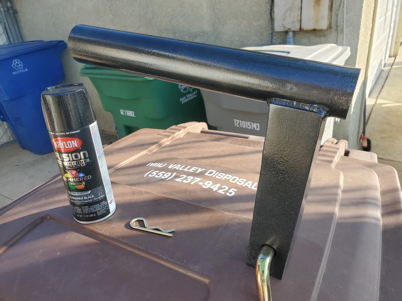

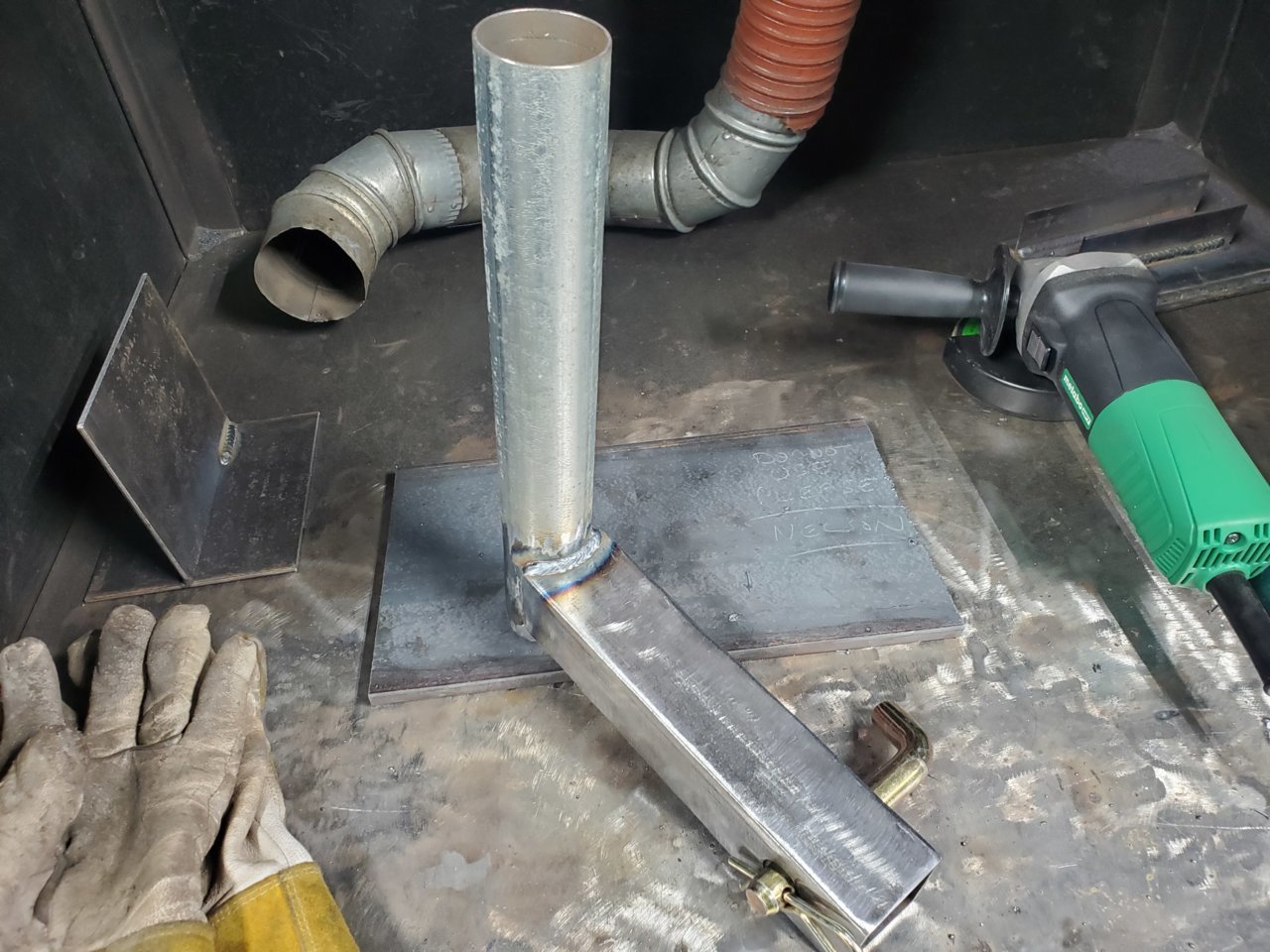

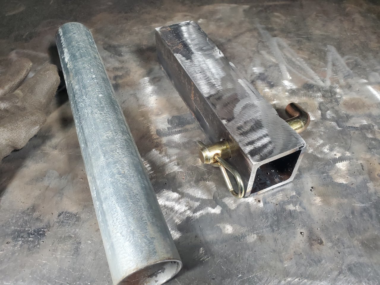

    Well, with this week coming to a close, we're still doing stick welding.
    However, my instructor said I'm allowed to finish that flag pole holder I started last week.
    For those that missed it, here it is -

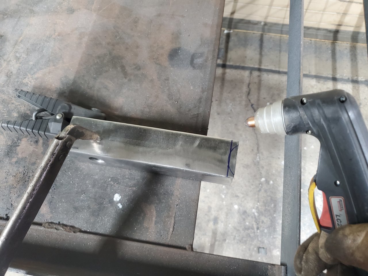

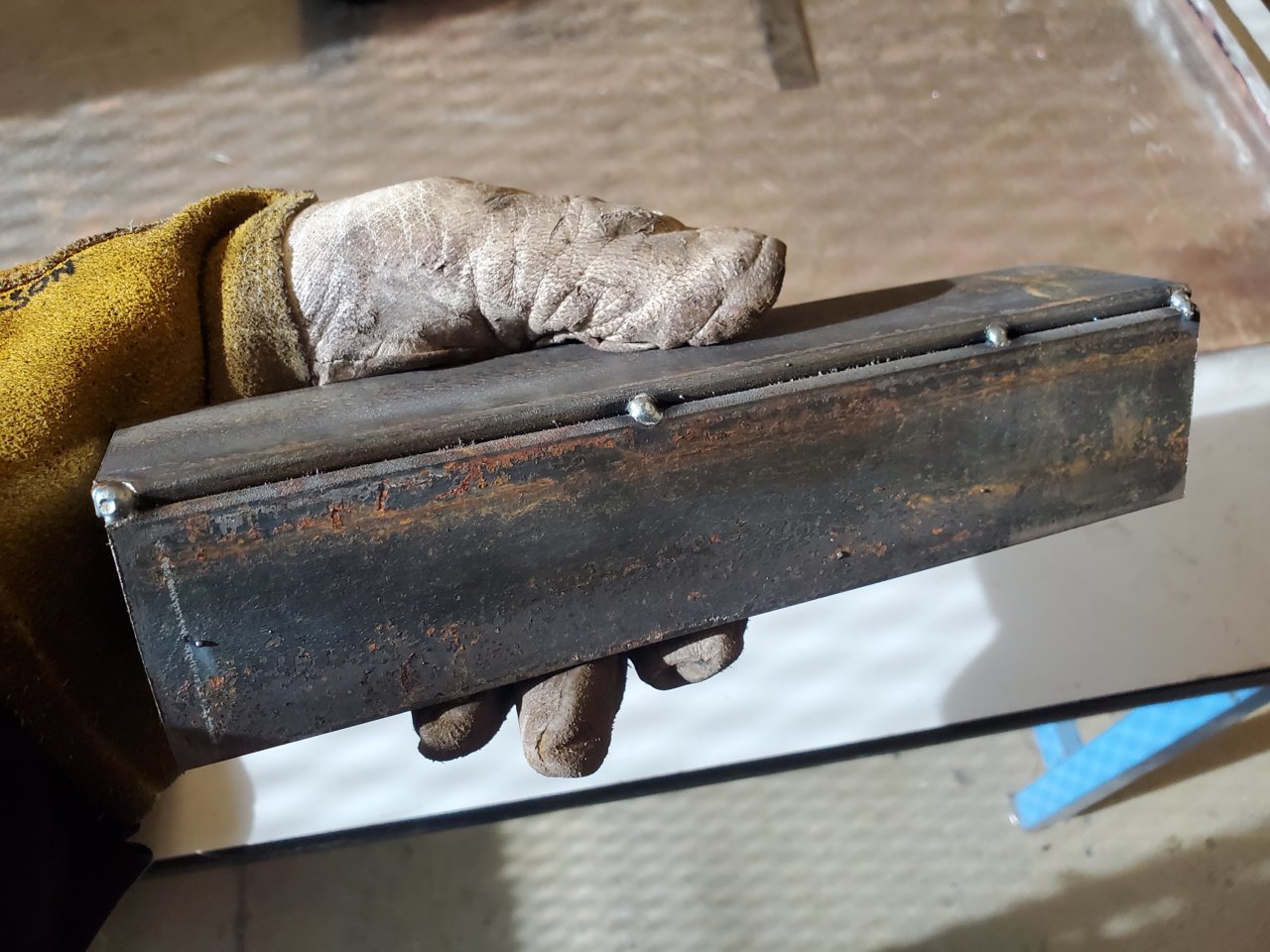

    Started with two pieces of 8" long angle steel.
    Tacked, then welded to make a square tube, 1 and 15/16" square. Definitely a good time to understand heat management.

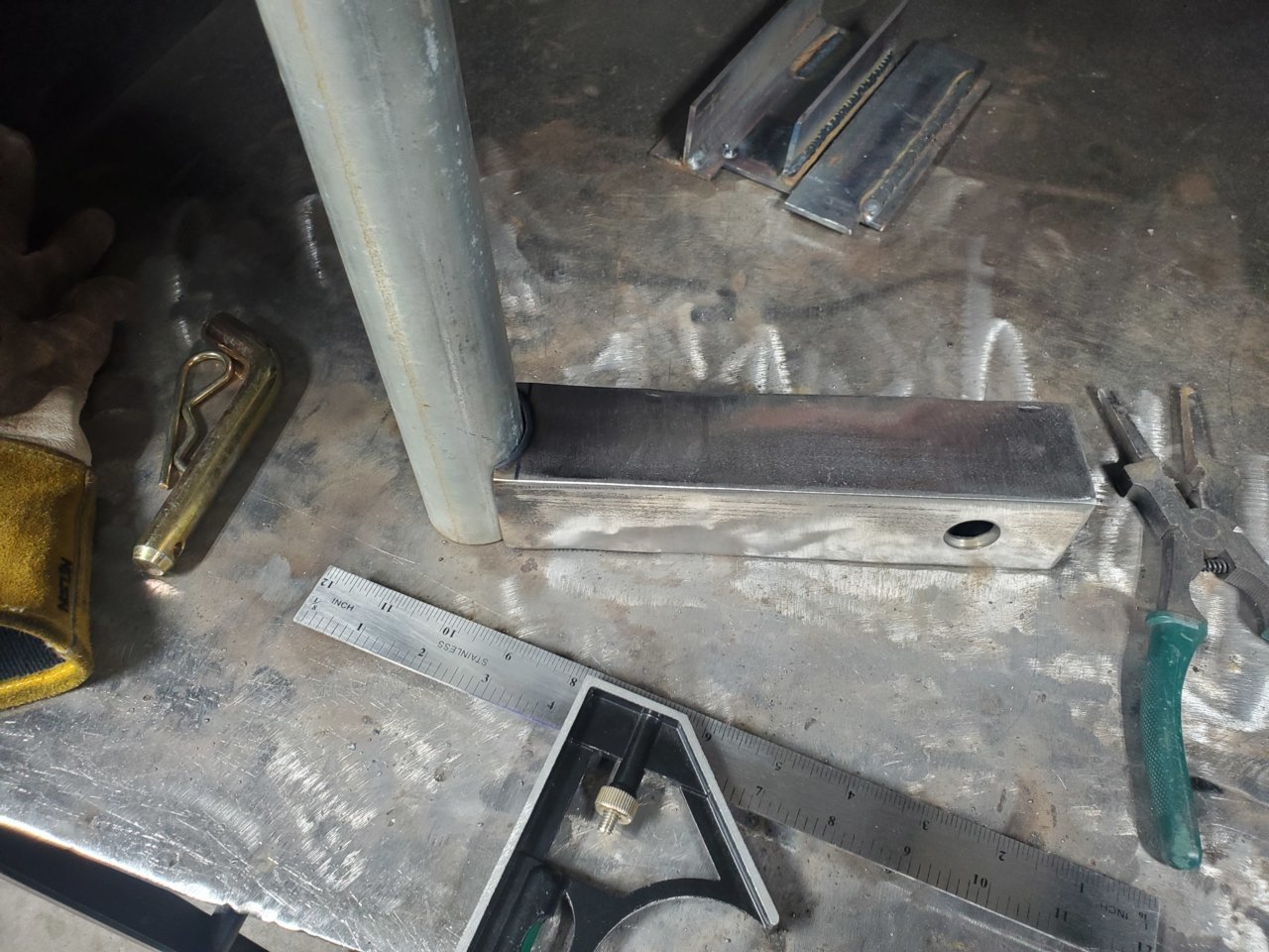

    Ran a 7/8" hole, 1 and a 1/2" from the end.
    This will fit a Class III hitch.
    Took 9/16" OD piece of round tube, 12" long to use as the flag pole holder.

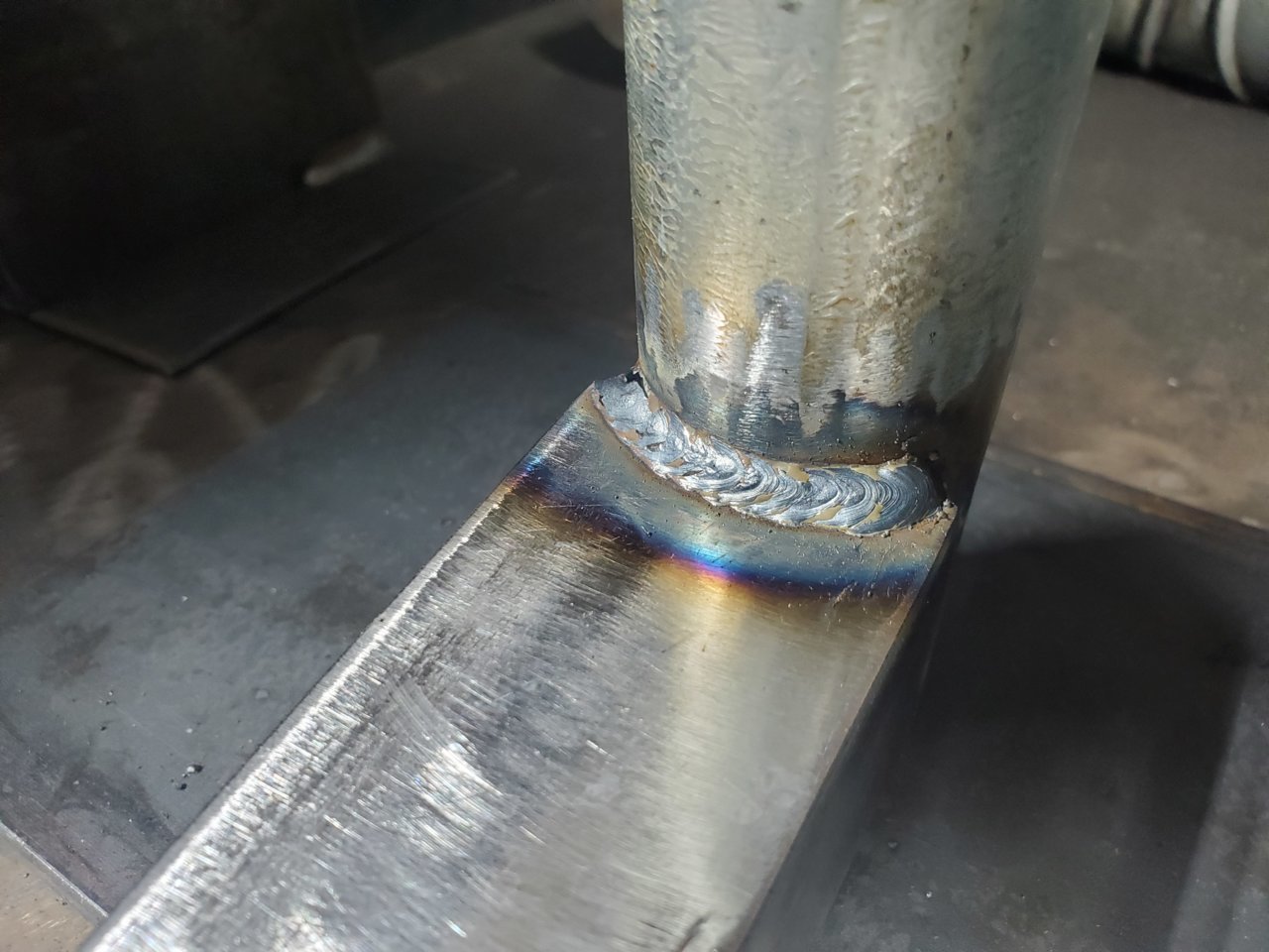

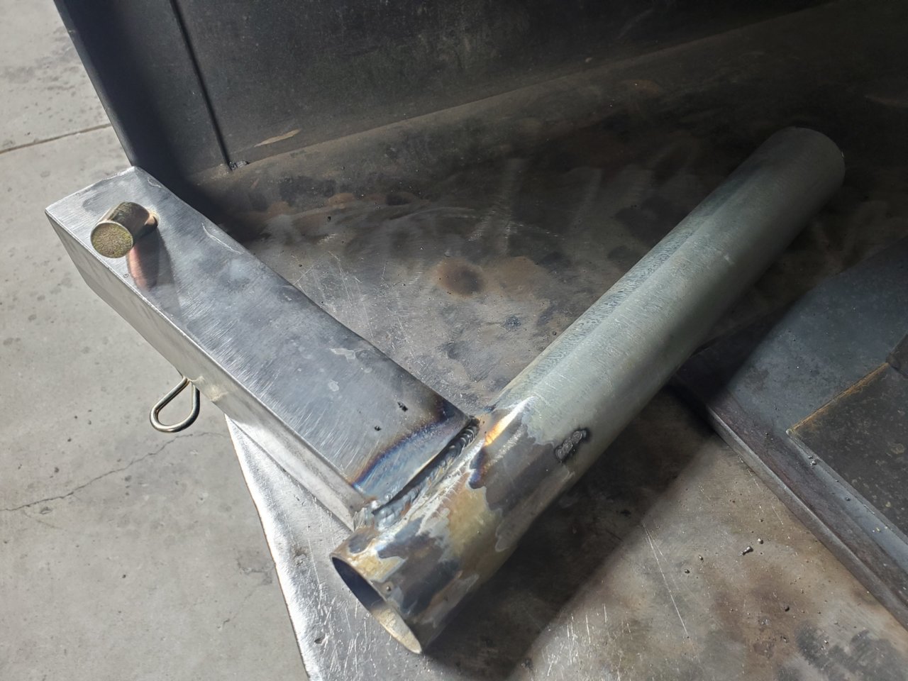

    Notched the other end of the tube 3/8" from the end and welded the pole in place.
    After class and a couple of errands, I'll hit it with self-etching spray paint.

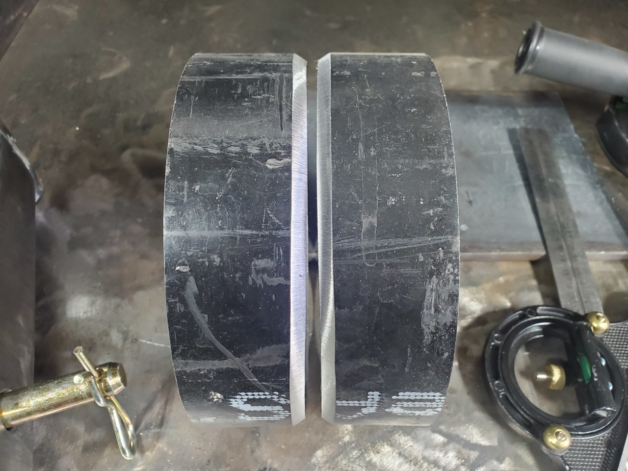

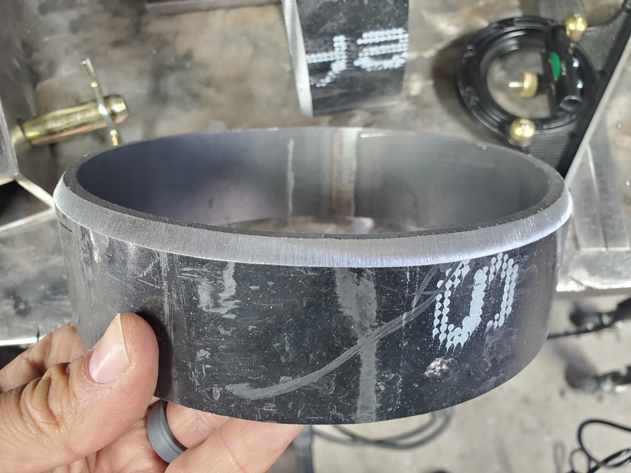

    And, the pipe I'll be running 6010 root welds on -
    I find I'm much faster just working around in the shop and doing stuff now.

    69,769
    Stock
    First coat of paint and it's looking real bitching!
    FIL is going to be stoked as he puts up a flag every camping trip.
    His old one broke (was crappy anyway, plastic?) and he hadn't replaced it since so when he gets home today he's getting a nice little surprise.
    Just in time for our camping trip tomorrow!

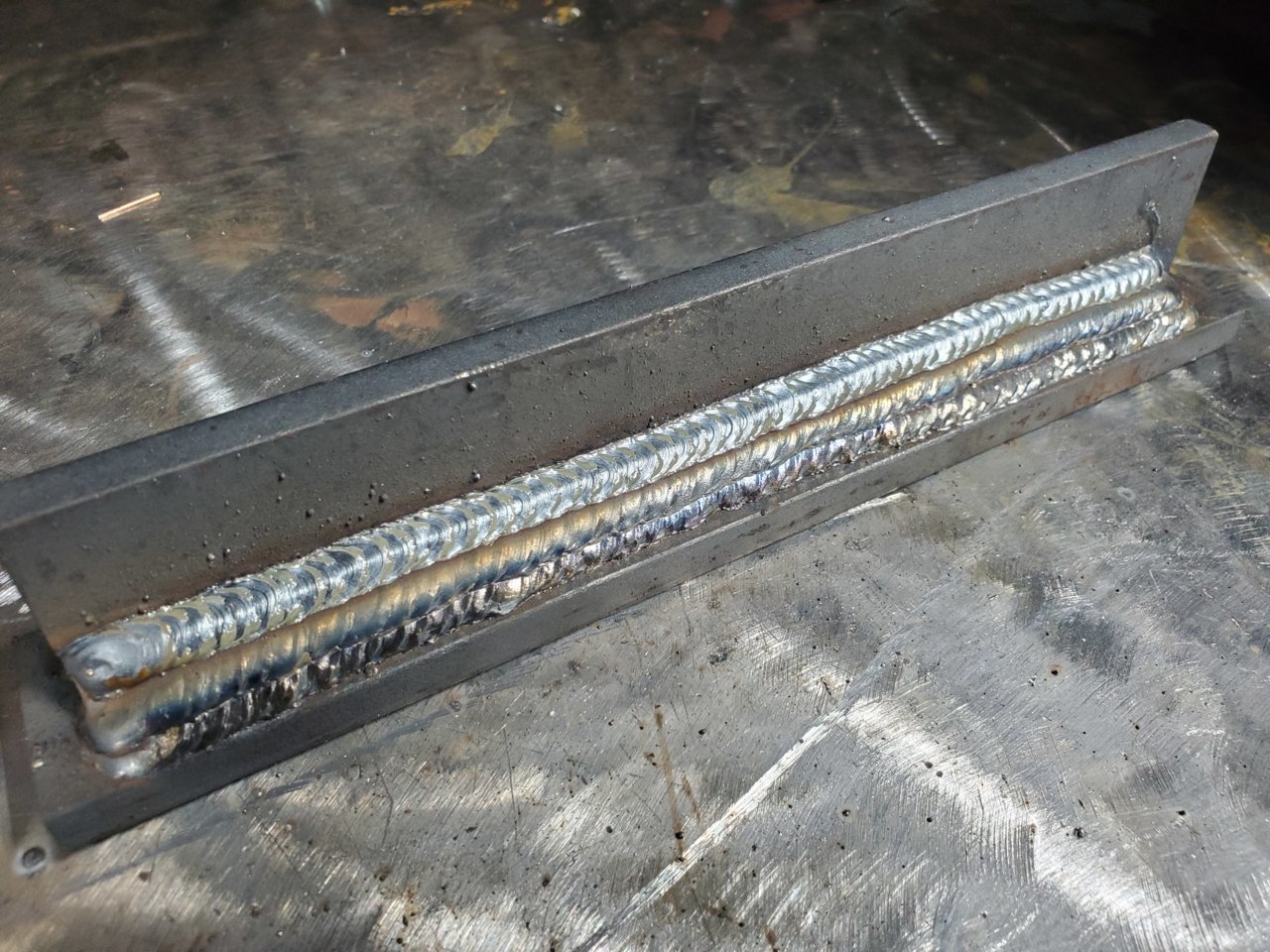

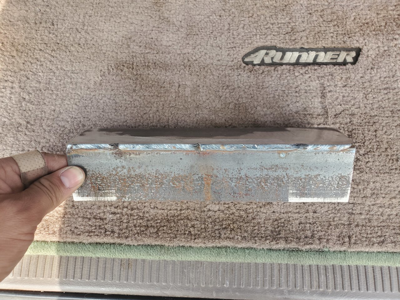

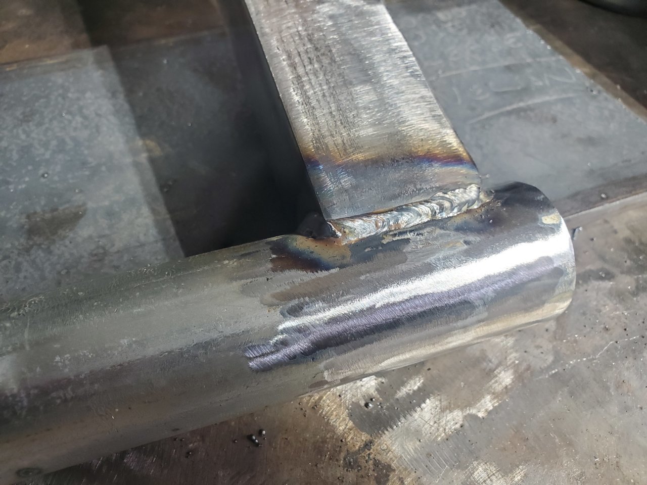

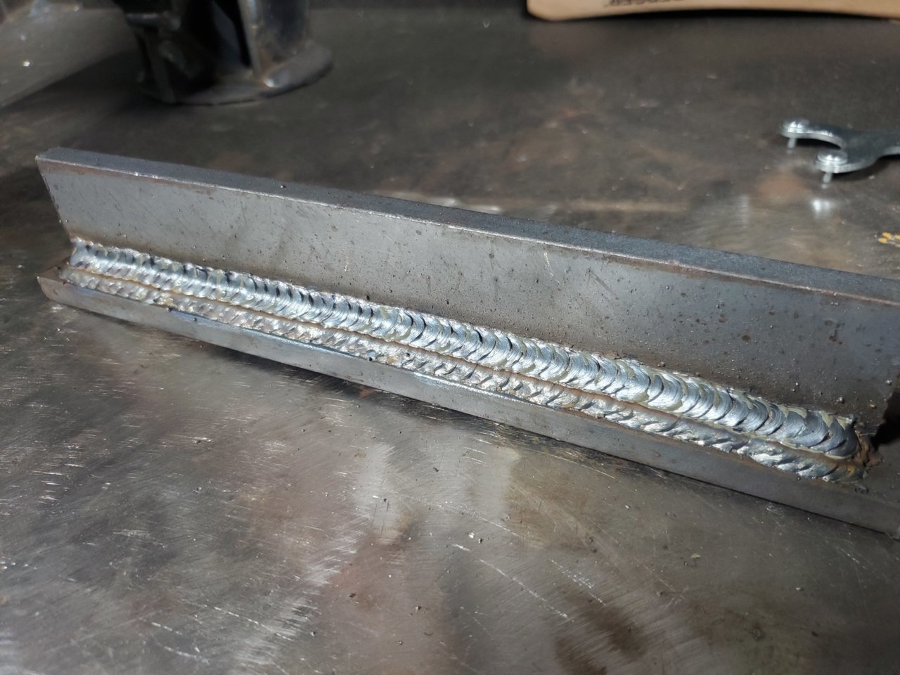

    Oh and, some random T's I did just because I want to remain consistent even if I just got off from doing stick.
    Two beads on a foot long piece -
    Then a third -
  7. Nov 24, 2021 at 6:14 PM

    Your getting acclimatized to being in the shop your getting comfortable .
    I cheated I would use a few1/8" rod stubs till the pipe coupons are tacked together.
    The hard part is welding through the tacks in the root pass so as to not cause defects once that and your tie ins it is pretty easy just practice .
    Kwikvette[QUOTED][OP] likes this.

    You said it yourself earlier in this thread; do what you can to make things easier.
    So I have to say no, you didn't cheat.
    We will use rods to figure our gap, but even our instructor told us how the pipe can shift when you weld through your tacks.
    He recommended putting the initial 4, and if needed another 2 or so.
    We also have the choice to run 3/32" rod for our root weld. I never tried it so I won't attempt a different rod on something that's already new to me.

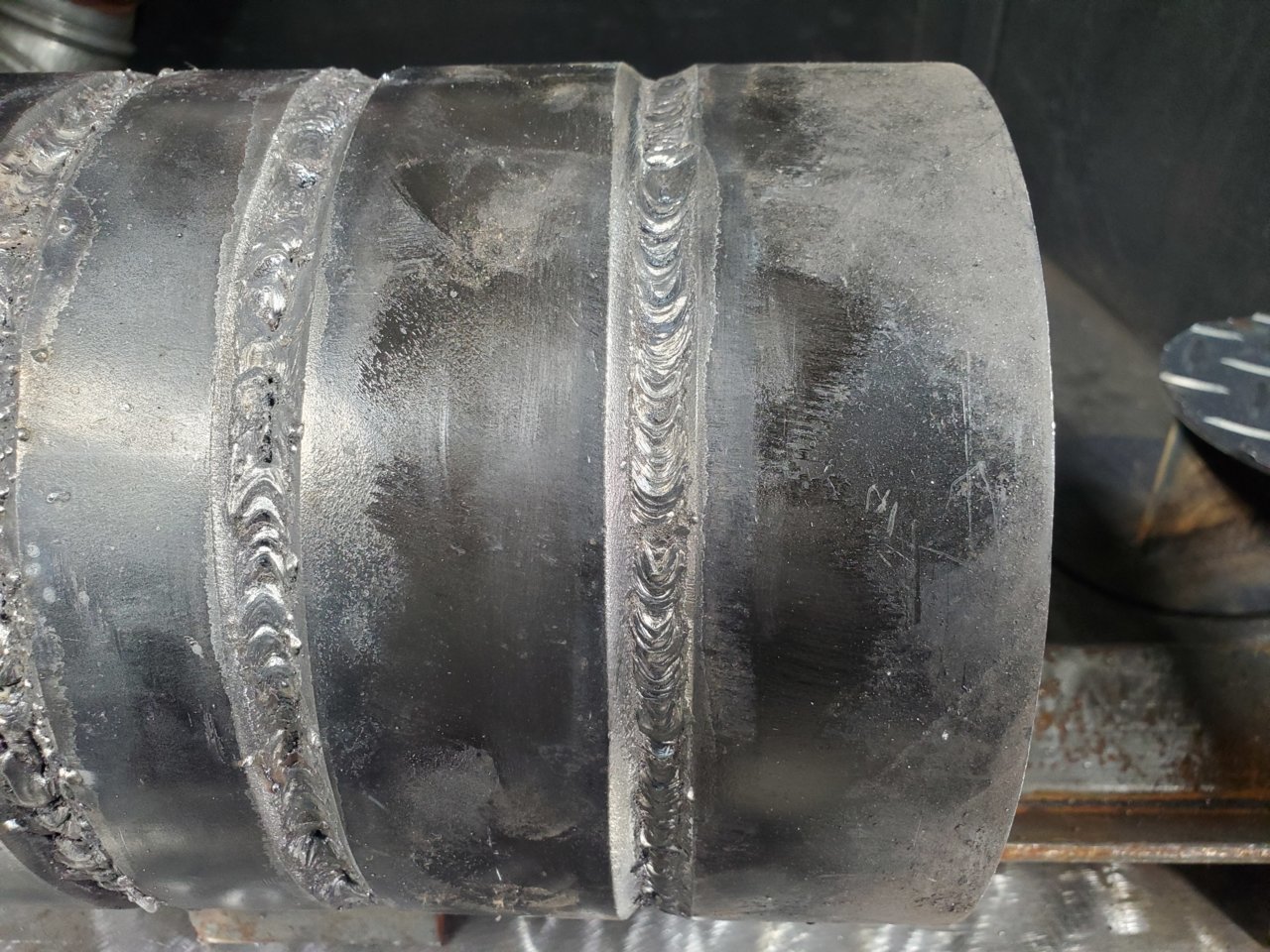

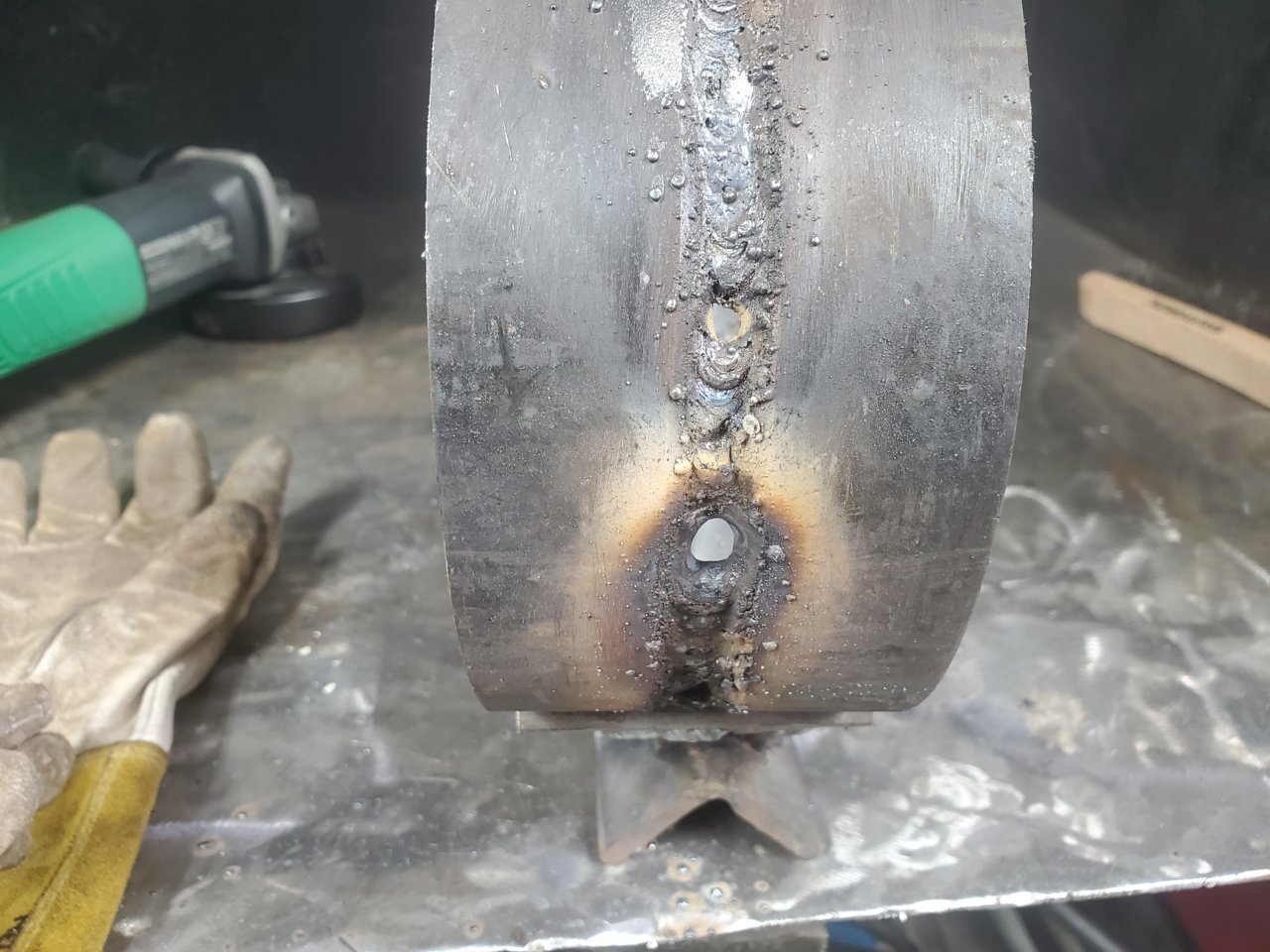

    Week 11 has been a fun start!
    I have to say, I have a newfound respect for pipe welders, not to mention I get a lot of the memes now because of it :rofl:
    Did some out of position stuff with stick running my root pass on this.
    For starters, the first pic is me completely fucking it up, trying to stitch, and applying too much heat and keyholing -
    Then it sort of clicked -

    Dude I have seen far worse on first attempts!!
    That came from people with years under there belt
    Helpful hint #69 always clean off your slag before taking pictures .
    The small grinder with a semi stiff wire brush works wonders slag inclusions are bad .
    Remember in the real world 3 strikes and your out to look forward to fixing dumpsters

    I looked at it and was like wtf, there's no way I'm going to get this. But I do recall the last part of my first run kind of being consistent.
    Pipe welding isn't a career option for me, but I'm still trying as hard as I can to learn as if it was!
    I'll make sure to clean the slag off next time ;)

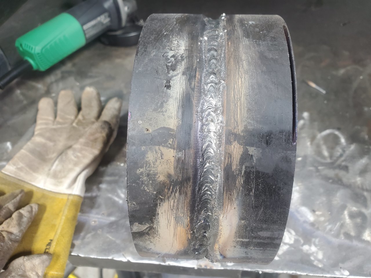

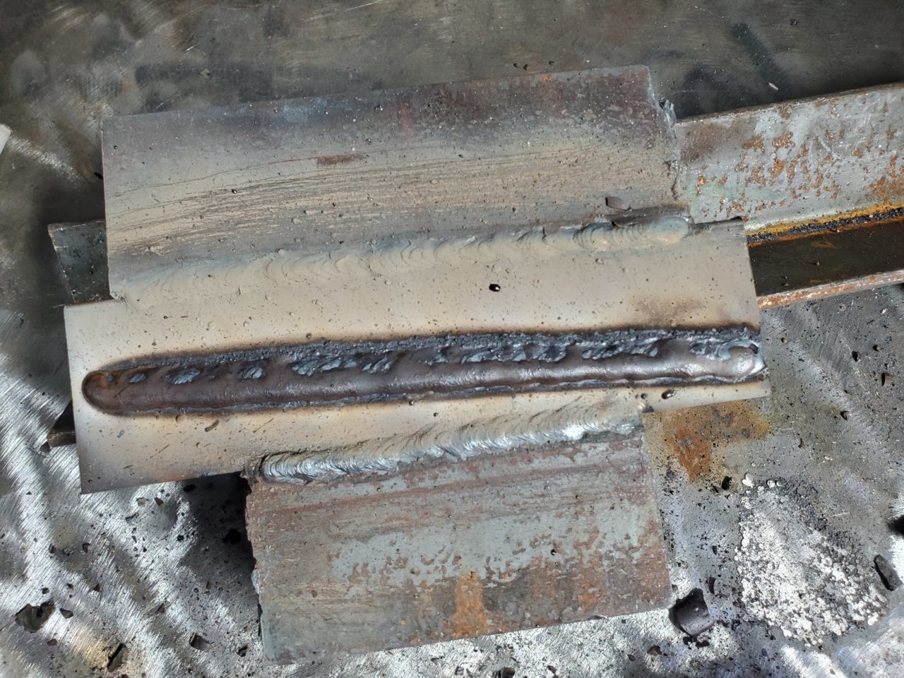

    I ran my hot pass on my worst root weld, for practice -
    5G, so vertical up.
    Apparently it was good for my first time, but with my complete lack of stick-welding experience, I was told I should run it down to try.
    Took me a few times to figure once I got to 3 o'clock, I need to quicken my speed as that puddle gets large and quick. Gravity makes that flux drip all over.
    Also told my instructor, why the hell didn't he tell me about 7024 sooner :rofl:
