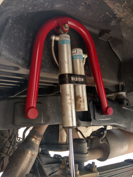

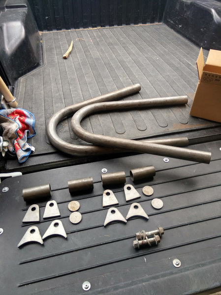

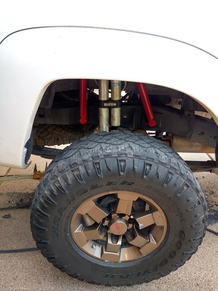

    Ballistic Fabrication Rear Shock Relocation/Hoop

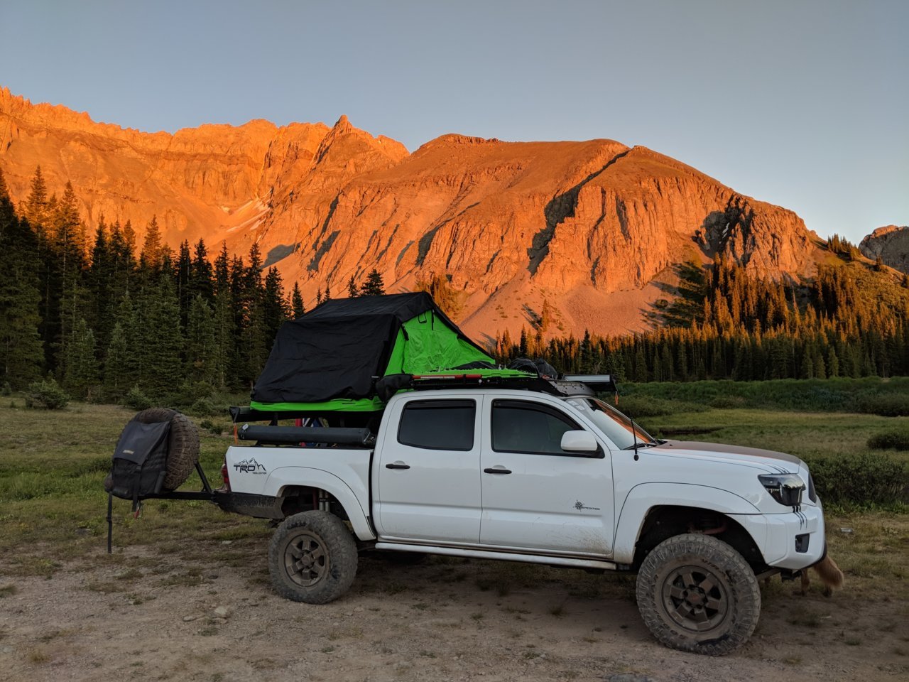

    San Juan 2018
    MVIMG_20180701_122513.jpg MVIMG_20180701_203744.jpg 00000IMG_00000_BURST20180702131000274_COVER-EFFECTS.jpg 00000IMG_00000_BURST20180702153435059_COVER.jpg MVIMG_20180702_152513.jpg MVIMG_20180703_131048-EFFECTS.jpg MVIMG_20180706_080323.jpg IMG_20180706_080433.jpg

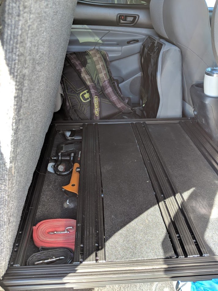

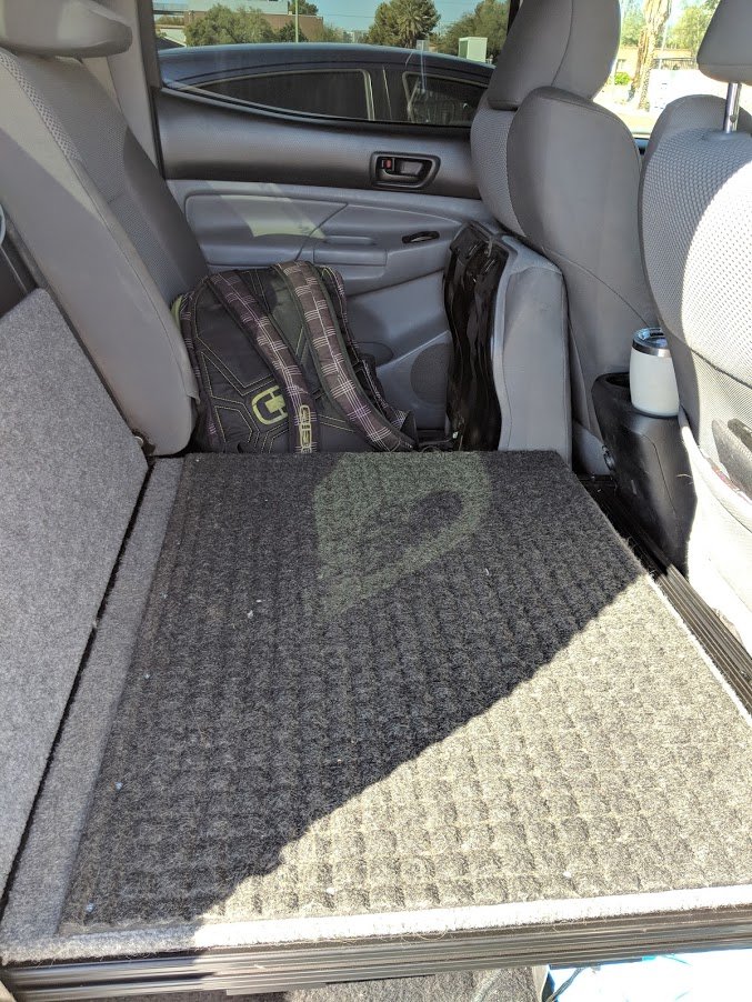

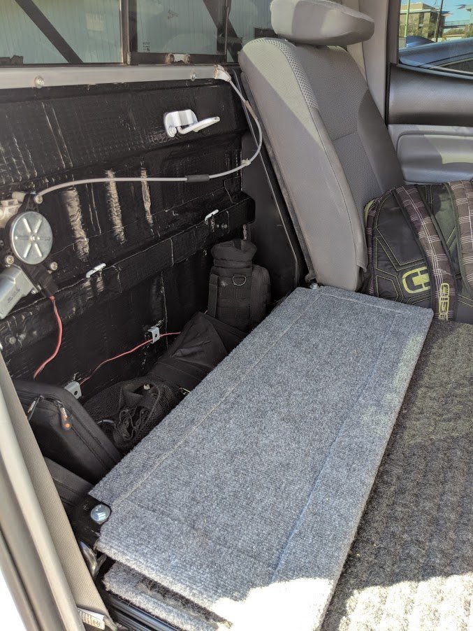

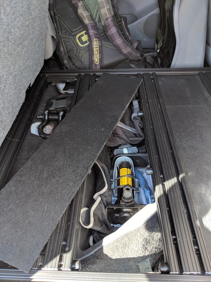

    Bench Seat Platform Details:
    Inspiration and Credit goes to @jbezorg and his thread
    Note: The Double Cab install is vastly different from @jbezorg Access Cab Install. The under seat storage bins are in a different location. The rear is lower then the front by 1-3/4". I used 1/4" spacers in front, 2" spacers in rear. I cut a hole in the storage bins to access/install the nut on the underside to secure the platform to the floor of the cab (using the bin mounting holes).
    The platform is made of T-Slot Extruded Aluminum, 2-1.5x1.5, 4-1.5x3
    Topped with a board wrapped in carpet that folds up. I currently use it to haul my pups around
    The T-Slot Extrutions allow for future proofing the platform, if I decide I want to mount a fridge it'll be easy to mount/secure to the T-Slots, or even install a slide rail

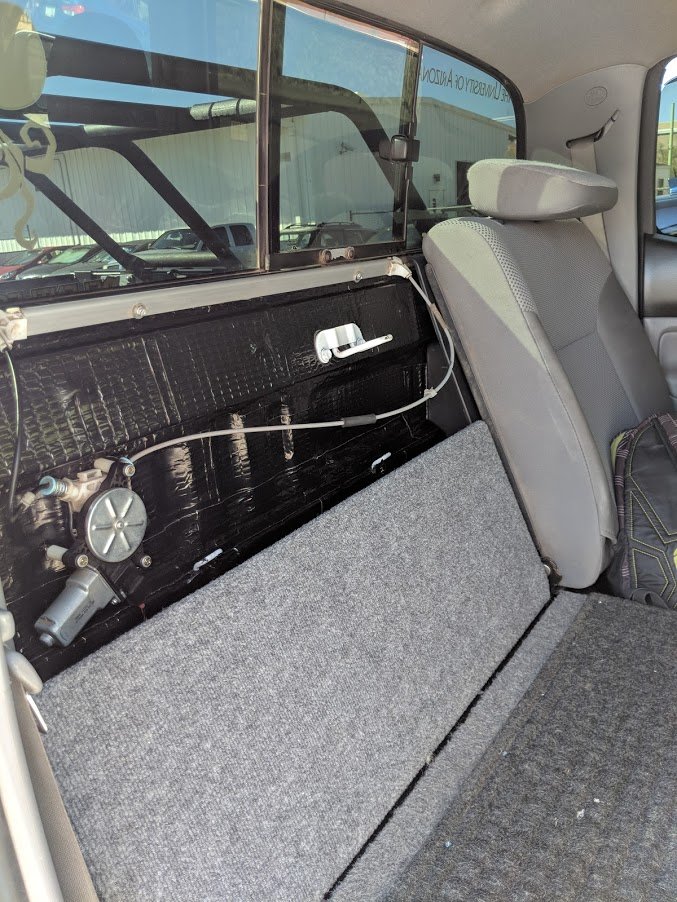

    Also removed the back rest. Highly recommend you install sound deadner if you go this route. With the back rest out, you get a lot of road noise, sound proofing it brings it back to how it was before removing the back rest.

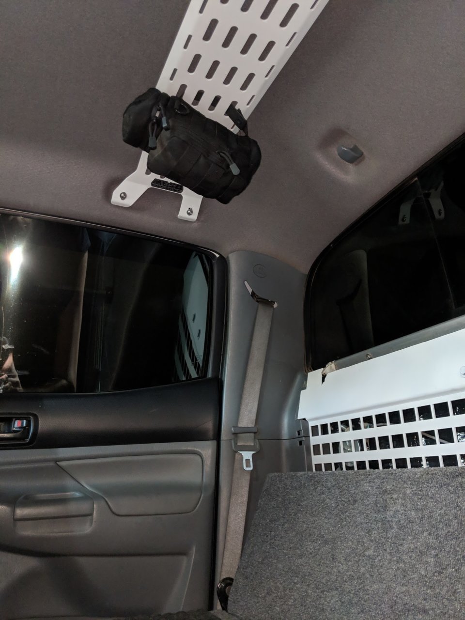

    Currently waiting for the Molle Panel GB to come through to complete the install. This will be my interior gear organizer for stuff that gets used often, air down/up kits, recovery gear, ect...
    The back is mounted to the seat back mount and folds just as the backrest did
    The paneling under the platform can be lifted up for more interior storage
    Final Result!
    Bill of Material

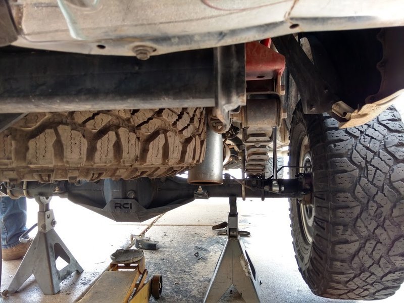

    I know this thread is relatively old but I am curious with the Bilstein 5165's [25-187717] and the Pro Comp Shock Adapter at the stock shock mounts was any issue? On top of that, what other modifications you needed to do to work at the performance it needed? [leaf springs, front suspension, etc].
    I'm looking to add some more articulation for the rear and not destroy the leafs as it feels the current shocks max out in certain occasions with potholes or washouts.
    I currently run the Bilstein 5100's in all four corners with Eibach Pro 2.5" springs with Icon RXT Multi-rate springs at option 3 that gives 2.625" lift over stock unloaded [1.125" 600lb load]. I also run steel skid plates, steel bumper with winch, plan to build a high clearance bumper, roof top tent, and camping gear when needed.
