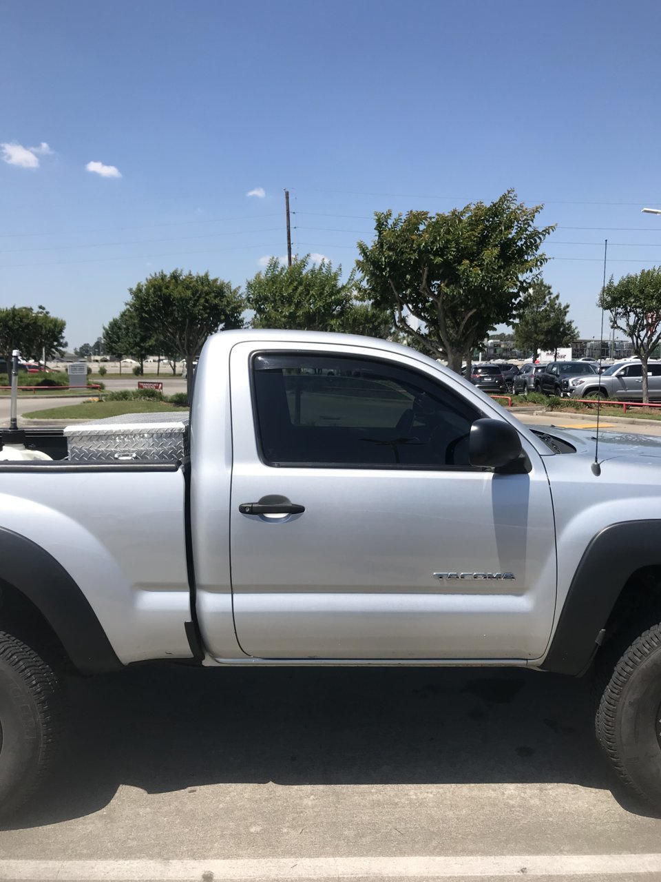

    Nothing new to post till Tuesday, so this was the window tint I got last summer. Went 10 years with the truck without it, and what a difference it made. Huge difference in the ability of the A/C to cool the cab last year in Texas — darkest I could legally go.

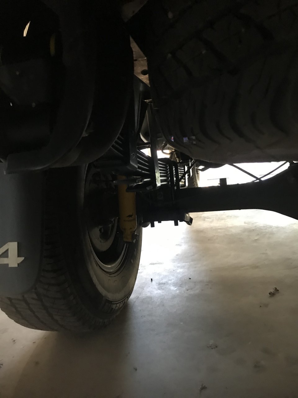

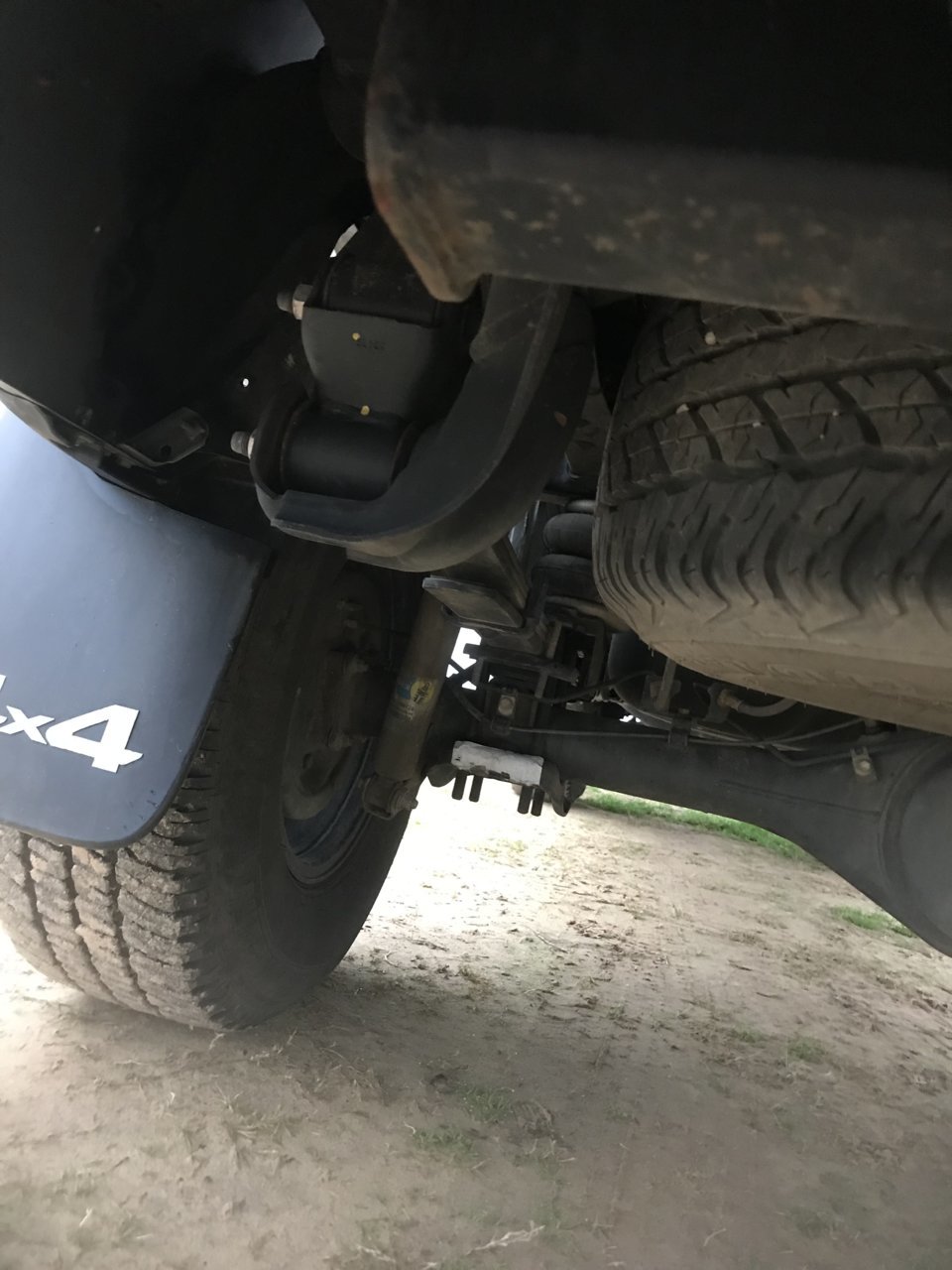

    The old leaf springs with the rear airbags —

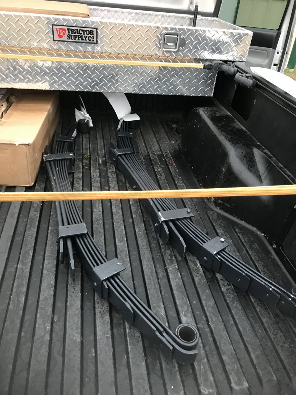

    And what replaced them, yay! —

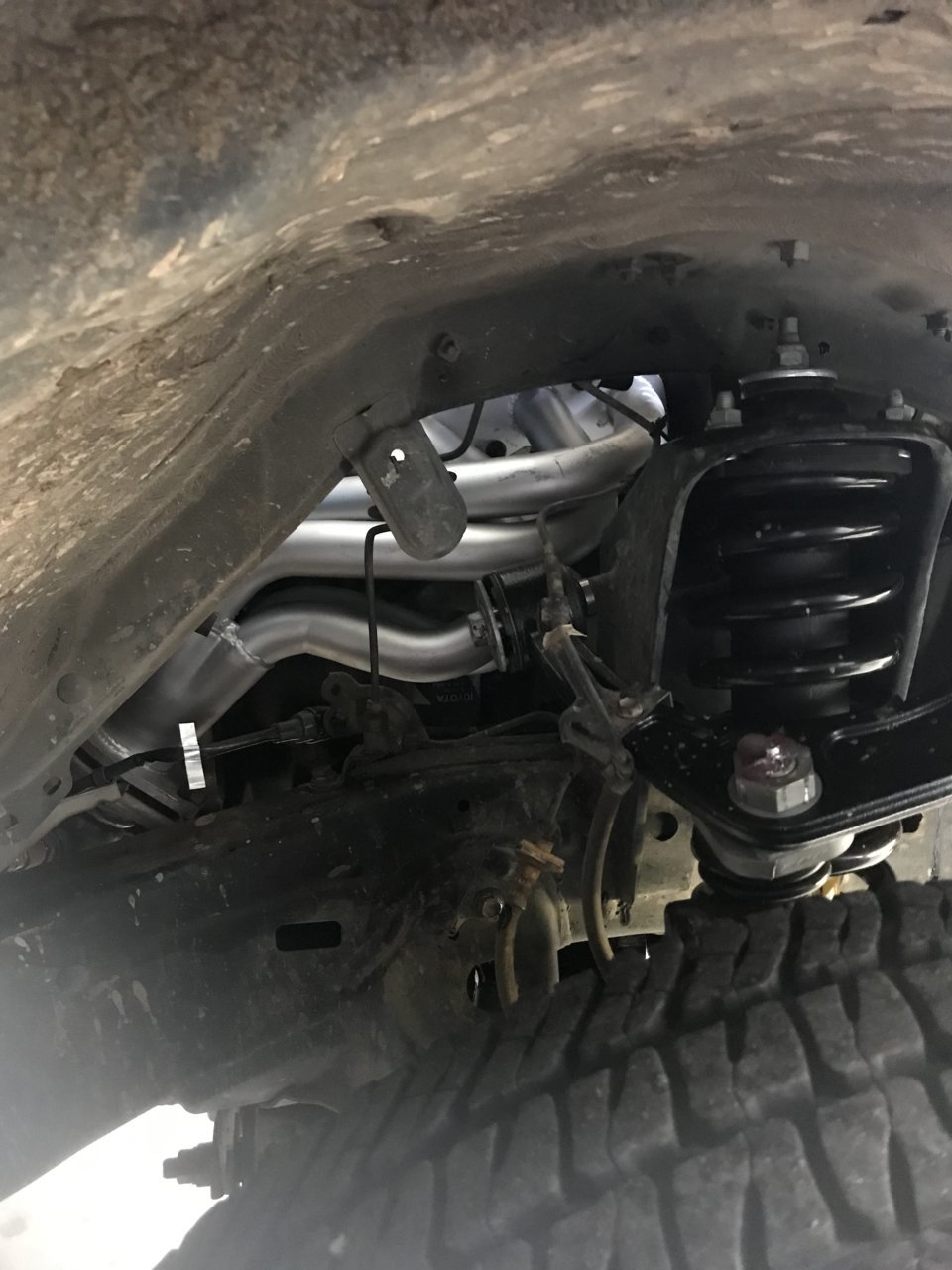

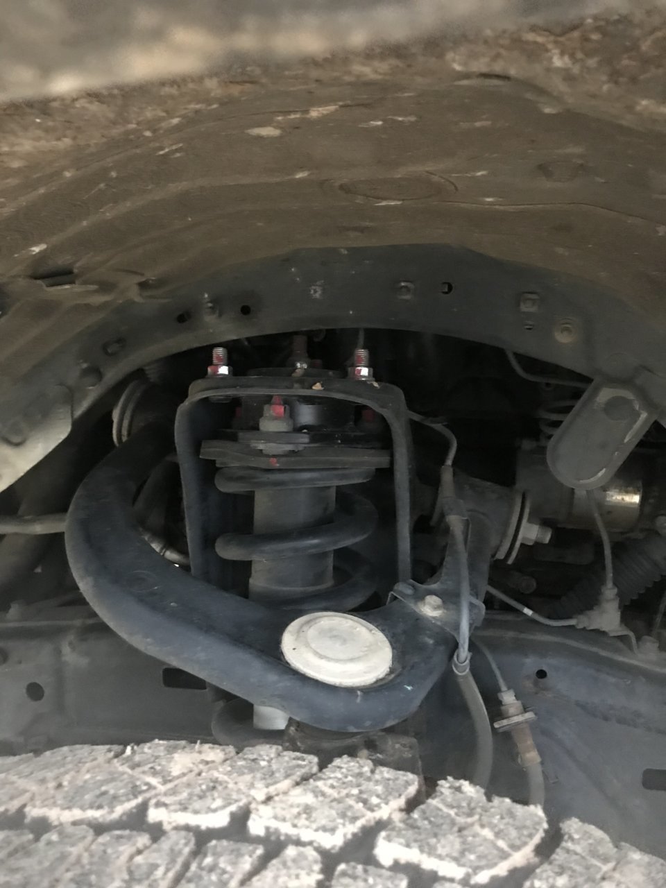

    The old front spacer lift, with 5100’s and stock UCA’s and coils —

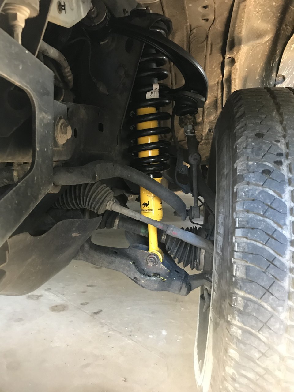

    And the new OME 887’s with soft ride Nitrocharger shocks, and SPC UCA’s —

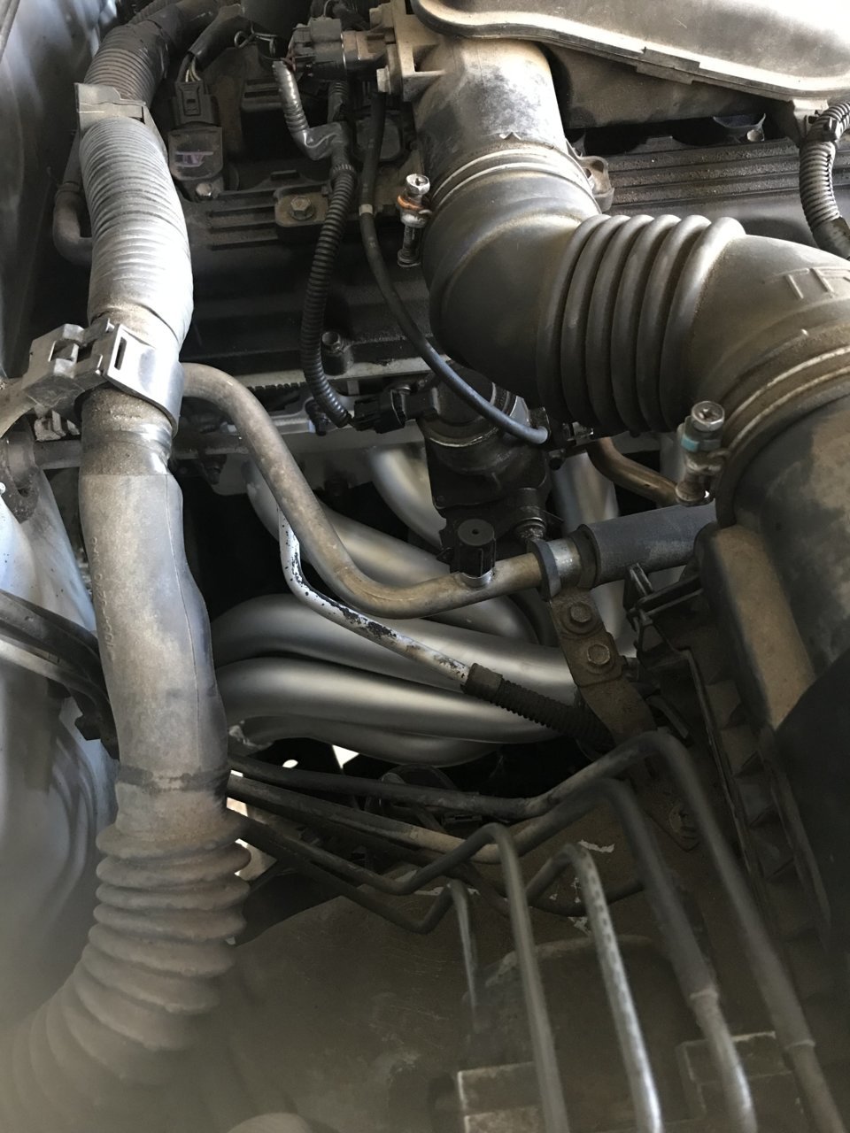

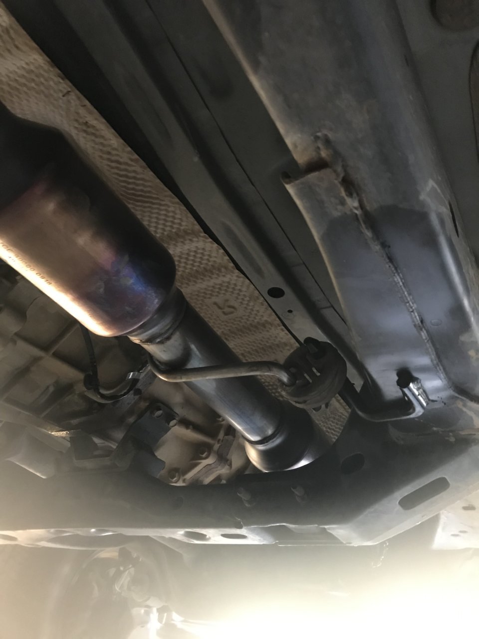

    And my brand spankin’ new LCE Header and Magnaflow Cats —
