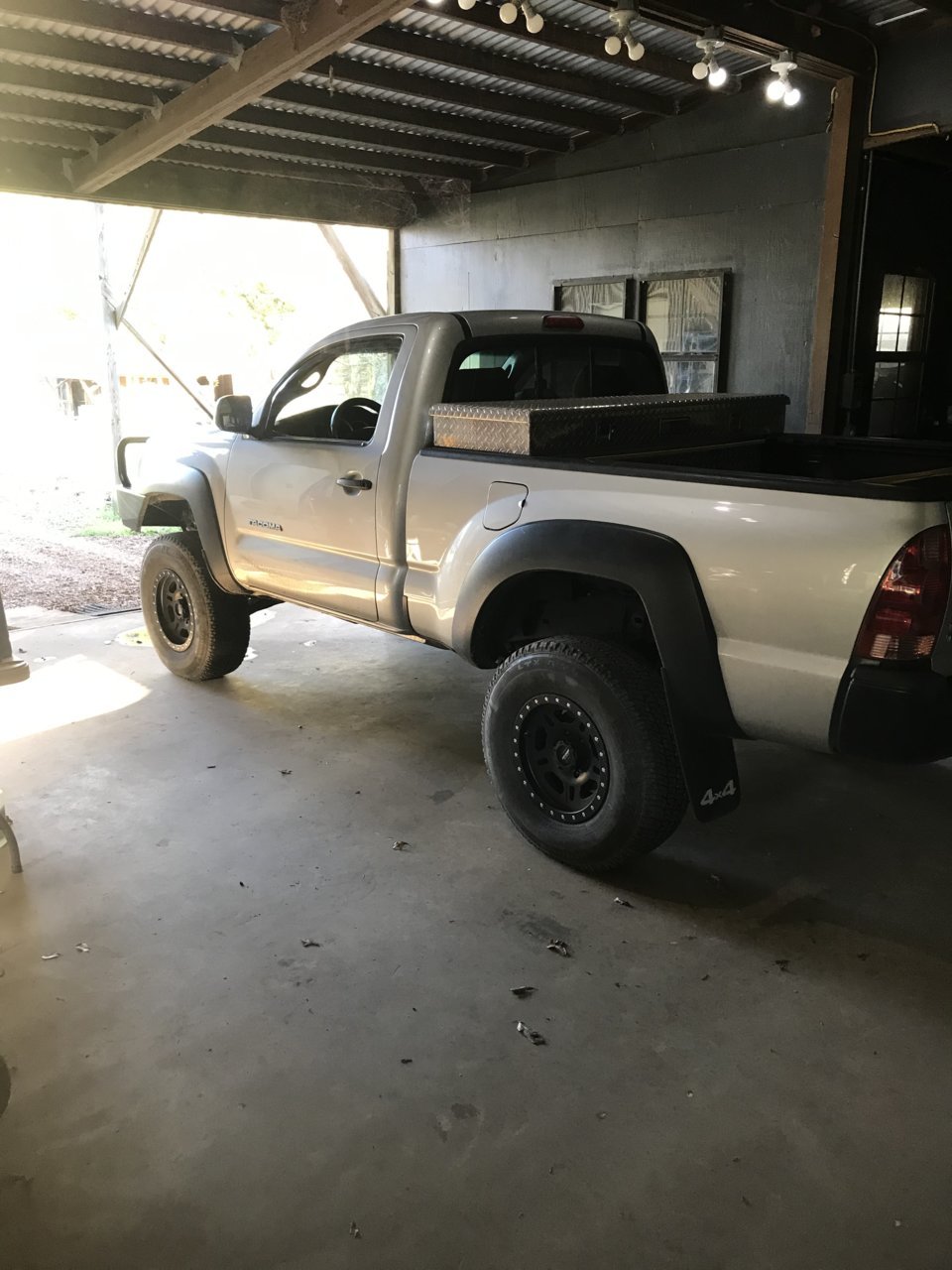

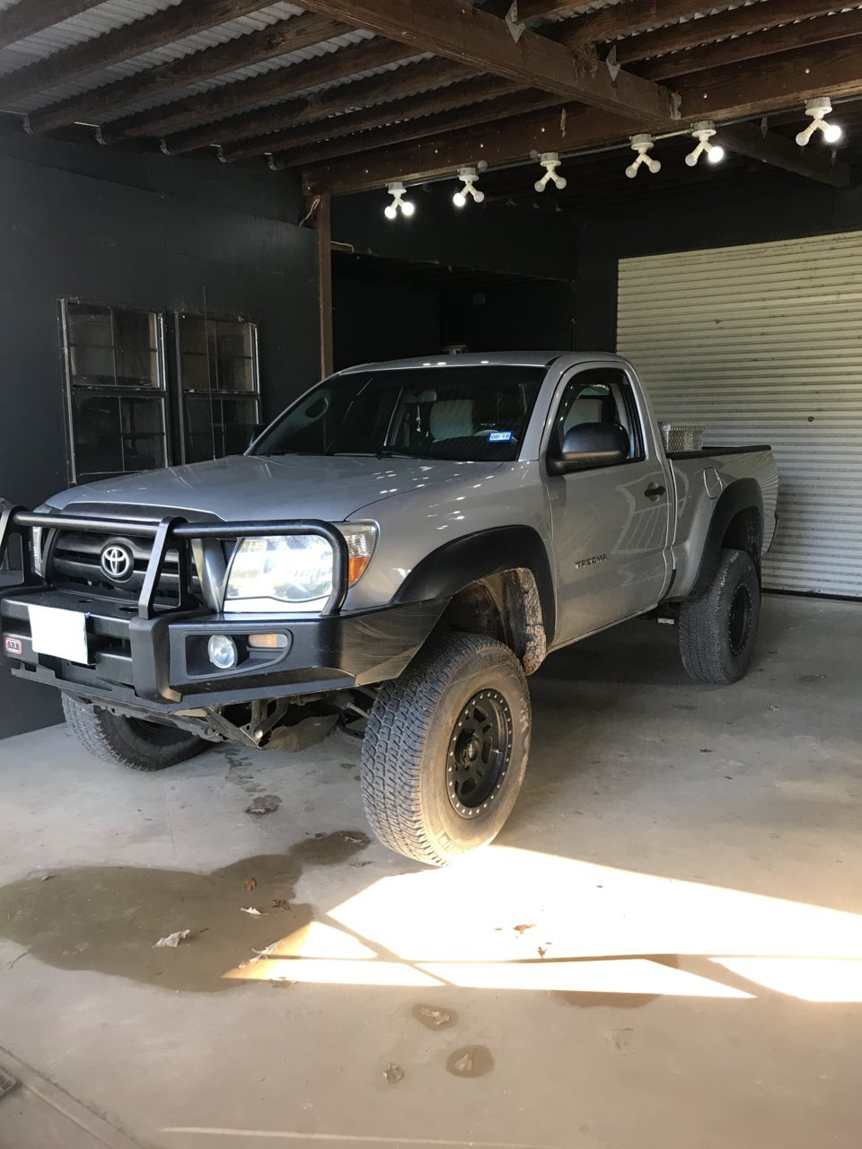

    My initial thoughts are that the new suspension is firmer than stock, but definitely softer than the spacer lift in the front.
    The leaf pack is going to be perfect for my means and uses, however, the truck is very nearly level now, so with a moderate payload I will have some squat. Not an issue, I can deal.
    How Plucky sits this afternoon —

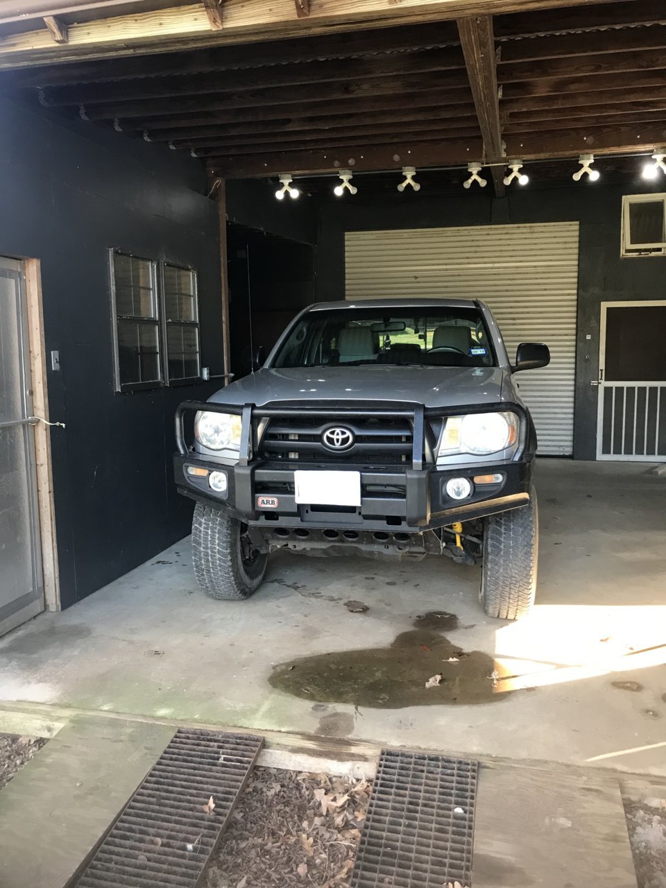

    All that remains is the alignment, which I’ll try to have done this Saturday. I’m out around Central Texas, and one of my only weekend options for having an alignment done are 4 Wheel Parts. They’ve done me good in the past, and this particular store is pretty thorough, so they’ll likely get the job.
    A view from the front —

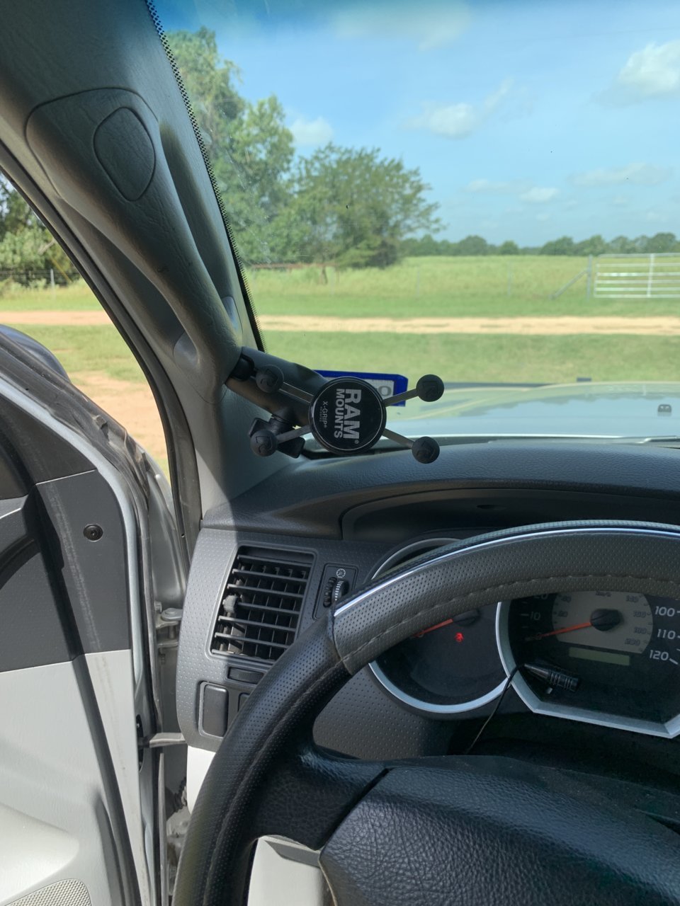

    Ram Mount mod complete. This a sturdy apparatus, to be sure. The X Grip has to go sideways because of the size of both my phone and phone case (sideways allows putting the phone in and taking it out more easily), but this is a very good product. And I still have plenty of space between the X Grip and back of the steering wheel.
