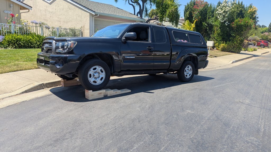

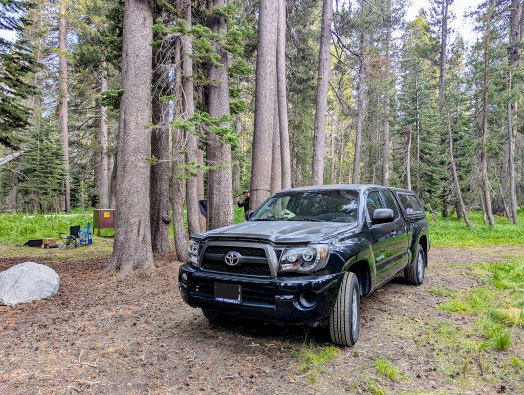

    Hey everyone,
    I'm new, but I've been lurking for a month or so, really appreciate the wealth of knowledge and advice available here.
    I've been lucky enough to acquire myself a 2010 Access Cab and I'm deeply in love (don't tell my wife).

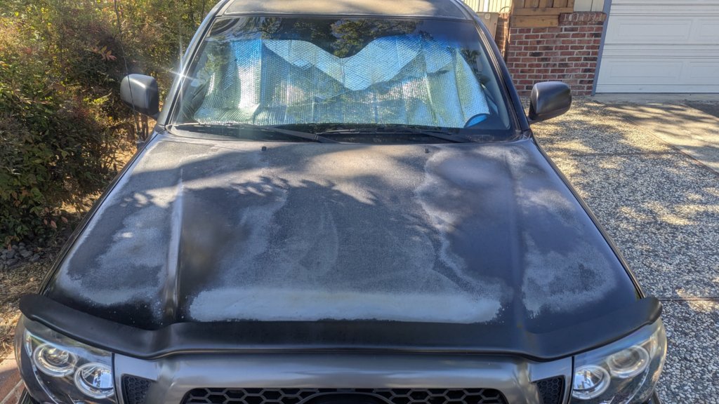

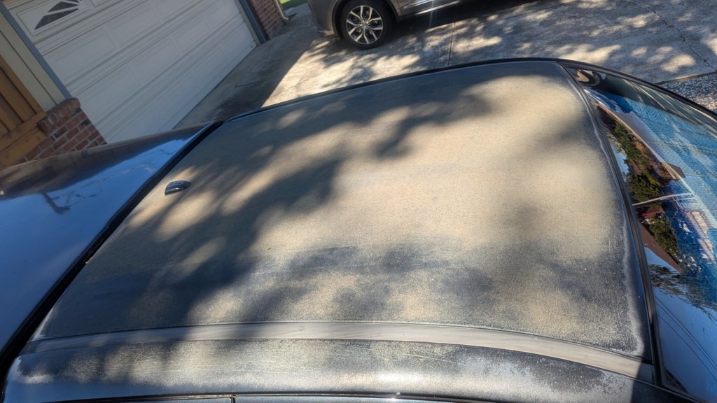

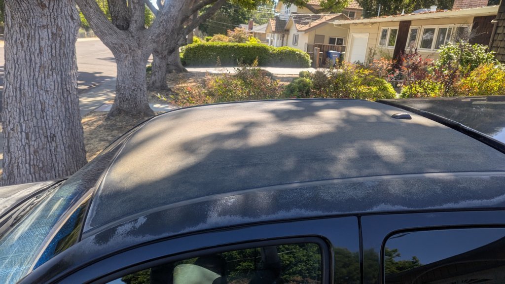

    The only problem I have with her (the truck, not my wife), is the paint on the hood and roof has already given up the ghost and I can see what looks like the beginnings of rust starting in.
    The way I see it, I have a few options -
    1. Get it painted. I've been quoted anywhere from $500-900 range from Maaco. All the way up to ~7000 from a more reputable body shop in the area.
    2. Wrap it. Got a quote for ~$1000 for this, I don't think I want to go with this option for the sake of longevity.
    3. Get it covered in bed liner. Got a quote from a shop that specializes in this for ~$1400 for the hood and the roof. I'm not 100% sure I'll like it but I imagine it'll last a good while and the pictures the guy shared with me of his other work actually look (suprisingly) really good.
    4. Attempt the paint or bed liner myself. I'm no stranger to DIY projects, but I would never call myself a painter. I'm sure I could do a bad job with some rattle cans, but I don't exactly have the facilities to make the job an easy one. I'd probably be doing my best out in my driveway.
    5. Poppy's Patina or the like. I've looked into this and I feel confident that I can sand everything down and apply a wipe on clear, just not sure how it would look or hold up to the sun.
    6. Do nothing, let it ride. Is this a viable option? Will the rust eventually turn my taco to dust? Will I have to change my username if I don't pick this option?
    Anyway, I'd appreciate whatever advice anyone has to offer on the subject. I'm at a bit of a loss and would really like to hear from anybody who has experience with any of the above options.
    If you have an alternative to anything I've listed I'm also all ears.
    Thanks in advance for your input, and thanks again for helping to build such a useful place to find info and experiences.

    Hey welcome to TacomaWorld. If it was me this would be my order. 4,2,1,3,5 or just leave it. Depends how much it bothers you. Good thing is if you decided to paint you could start with the roof of the truck and test your luck. It’s less of a noticeable spot than the hood. It’s a common thing for these 2nd gen’s to lose the clear coat on the hood and roofs.

    Depends on the budget. I would get it professionally painted if possible.

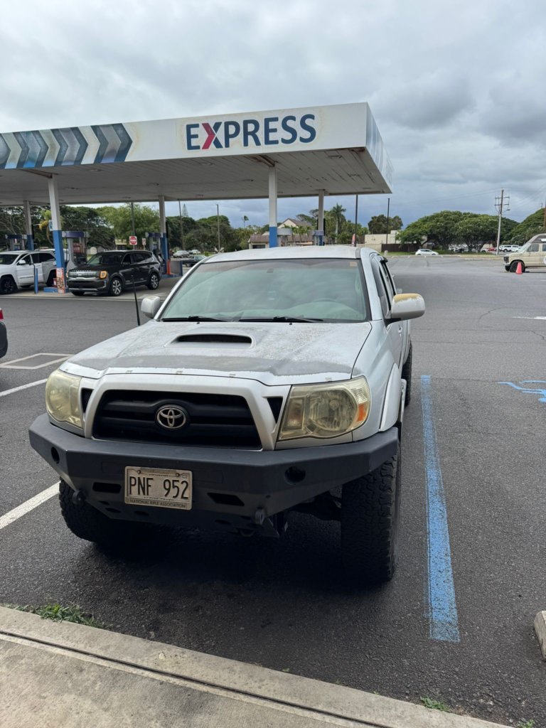

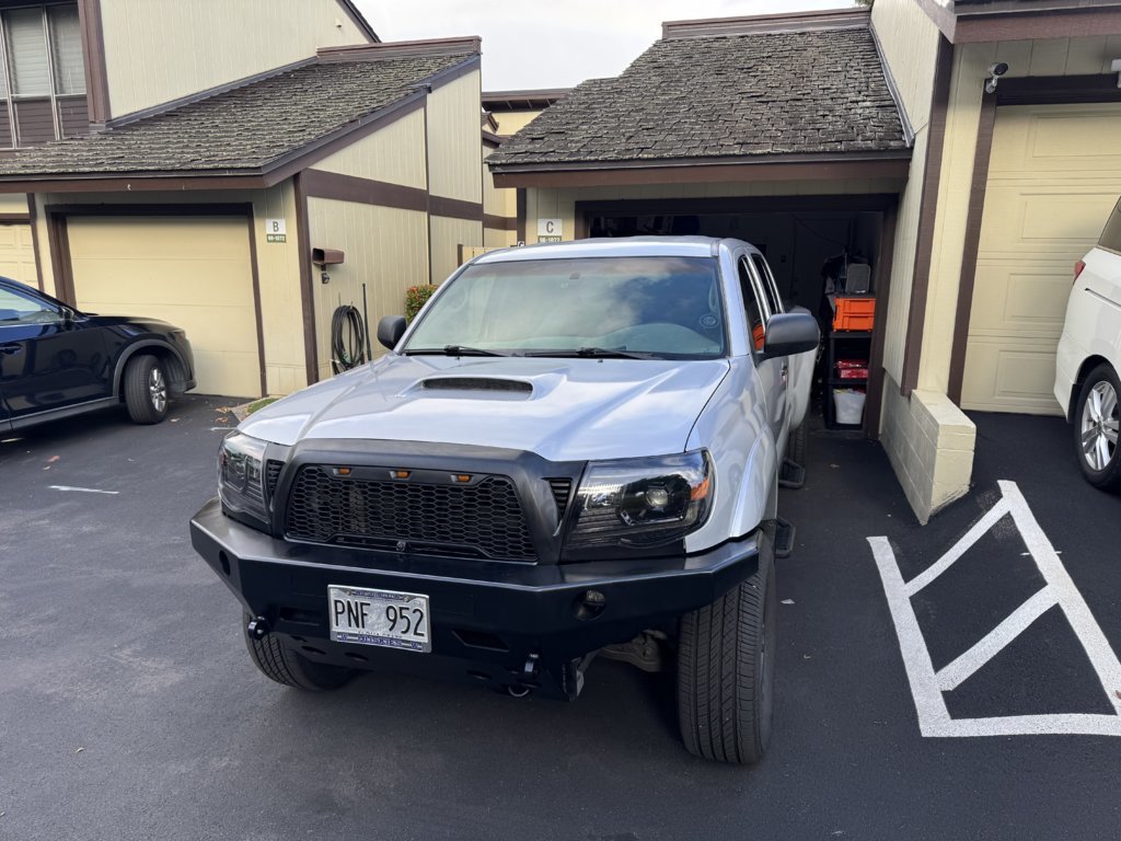

    Hey mate,
    I’m in Hawaii and spent 3k on getting my whole truck resprayed.
    I did all the other work myself, but, the paint was left to MAACO. Was it excellent? No but it’s a hell of a lot better than it was

    WELCOME, nice truck, and ramps

    My opinion is painting it is best (however that's accomplished), but don't rule out wrapping so fast. Wrapping the hood and roof is easy compared to other body parts. Plus your truck is black. It's easy and cheap to find black wrap. Stick with 3M or Avery. I've wrapped my roof and hood several times (different colors and patterns). Just don't leave it more than 2 years (IF in a sunny area). Removal is done in minutes. Don't pay for someone to do it, if you can help it.
    I'd like to add that for the areas I wrap, I just wash it. No polishing, so this saves me a lot of time during maintenance.

    Being black makes it easier, as you don't have to worry about matching jambs, underhood, etc. And Monstaliner can be applied smoother (not paint smooth, but smoother) than traditional bedliner.
    Some folks around here have done it. Doesn't look bad, very durable.

    I pulled the trigger on a wrapping tool set and a couple of sheets of vinyl for the roof and hood. Going to sand them down and then hit it with some primer (maybe) before wrapping. Thanks for the suggestion. I think I'd rather try a fix myself for ~200 bucks before I invest the money for the paint job or the time/effort to hit it with some rattle cans.
