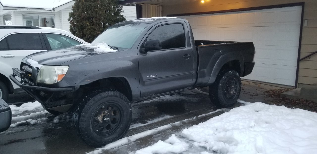

    Hey guys,
    Making my first post here, but have been a member of a Tundras forum for a while. My first taco was a 96' 3RZ with 5-spd, then I went to an 08' DC LB, then I upgraded to a 2017 Tundra.
    So here I am again, but with a 2010 Reg. Cab 5-spd, but with 10psi on cylinder 4. I just picked it up Saturday so I haven't had a chance to get into it yet, as I've got a garage full of motorcycles I'm working on currently.
    I'm weighing my options of what to do with the motor and looking for some opinions from people who may have done the "more work" options. I'm no stranger to turning wrenches, and actually replaced the head in my 96' twice due to a mis-diagnosis by a local mechanic before finally swapping in a new/used motor.
    - Rebuild the 2.7L back to stock (waiting on pricing)
    - Rebuild the 2.7 to handle boost
    - Buy a used 2.7 to toss in
    - Buy a used 4.0 to swap in
    - ????? 2jz, LS, other large motor swap???
    I'll be making a build thread as well once I get started, but here's a pic of the truck as she sits now.
