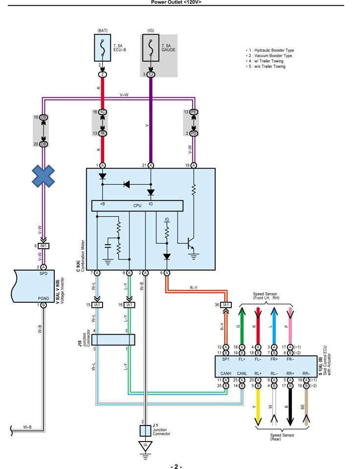

    I just modified the stock inverter so I can use it when the key is not in the ignition.
    It's pretty simple and just involves cutting the switched +12v wires in the switch (two of them) and relay (one), then connecting "always on" wires in place. You also need to send 12V to the clutch input on the inverter and cut the speed sensor wire on it.
    Measured current draw from the battery and it doesn't increase with the mod.

    Hehe, I thought I may get that response. I was in a hurry so no pictures, I more posted this up to answer questions if people actually wanted to do it. I do have a modified wiring diagram I could put up.

    The stock inveter will shut down once the batt voltage drops a little below 12volts. I have been wanting to do this mod for a while, just haven't gotten around to it yet. for anyone who's questioning how long you can run the inverter on the stock set up, I have run a fan and a soldering iron on it with the ignition on and it ran for about four and a half hours before the inverter shut off and I was still able to start the truck. Write up would be awesome, but even just posting up the wires you tied into would be great...
