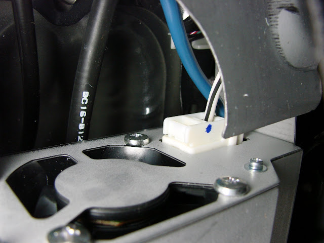

    Attached is wiring diagram for the inverter. It is for the 2007 model but should be relevant and useful.
    Also, I have modified my inverter to operate at 400W all the time by grounding a wire in the harness that supplies signals to the inverter.
    While working on it I took this photo. The fat blue wire supplies the +12V to the inverter. It went inside some split wire loom and disappeared in the general direction of the passenger seat.
    I hope that helps you.
