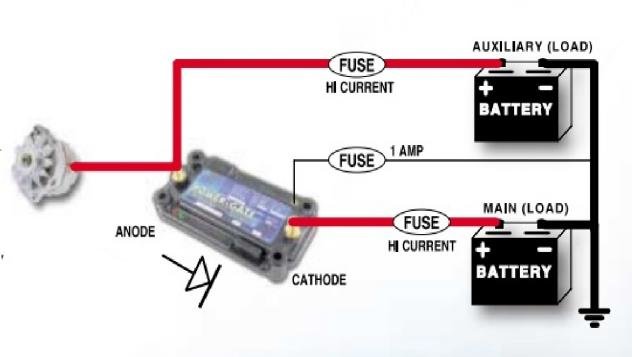

    I used this schematic to wire it all up and put 200A fuses close to each battery. I chose 200A because the alt puts out 130A, but the wire can handle up and over 300A.

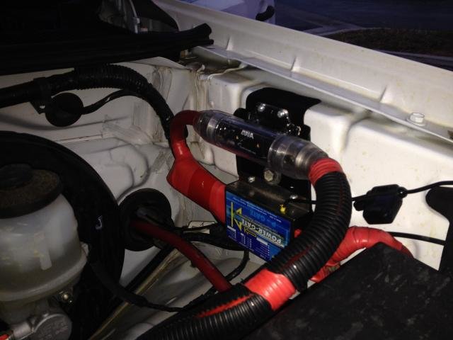

    Heres mine and the 200A fuse on a little mount that I built.
    I ran the 1/0 gauge positive wire from the anode side of the isolator through the front firewall down behind the kick panel and along the door jamb. You have to pop all that plastic off. Theres a thumb screw behind the plastic pedal for the kick panel, and you have to take out the seatbelt to remove the plastic column.

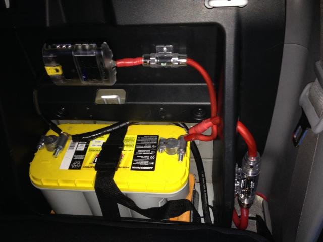

    To fit the type 31 Optima in behind the rear passenger's seat, I first removed the passenger seat in the rear. 6 bolts and the seat comes out. Then I pulled out the black plastic cubby and chopped it up. I just basically used a dremmel to cut out the back and bottom of the cubby below the middle ridge where the two bolts connect it to the rear of the truck. You can see the white of the cab around the battery in this picture. That's what I cut out. If I didnt have the JBL sub, I might have placed the battery on the other side for weight distribution.
    I mounted a size 27M battery tray from Amazon on the bottom of the cab where I wanted the battery. I tried to make sure the battery was pushed as close to the center as I could. I used size 12 1" sheet metal screws with 1 inch washers and drilled through the floor. Be very careful, your gas tank and all sorts of wiring is up under there as you get closer to the center of the cab. You can reach up under there before you drill to make sure you dont hit anything.
    I chose to mount everything in one spot behind the rear passenger's seat so I fit the 200A fuse on the outside of the plastic cubby and drilled through the side. For the negative battery terminal to frame ground, I ran 1/0 gauge wire back along positive wire path behind the rear kick panel and underneath the carpet behind the drivers seat is a rubber plug. I drilled through that plug, ran the wire through it, and grounded that wire to a bolt on the upper outside of the frame. it should be out of the way enough, but you may be able to find a better ground if you are a serious offroader and think it might get hung up.
    I added a blue sea fuse box with 4/0 gauge wire and a 100A fuse so that I can run my accessories. There is another plug in the rear middle of the cab under the bigger seat that I will run the wires for my accessories.
    Put the rear passenger seat back on and you're done.
