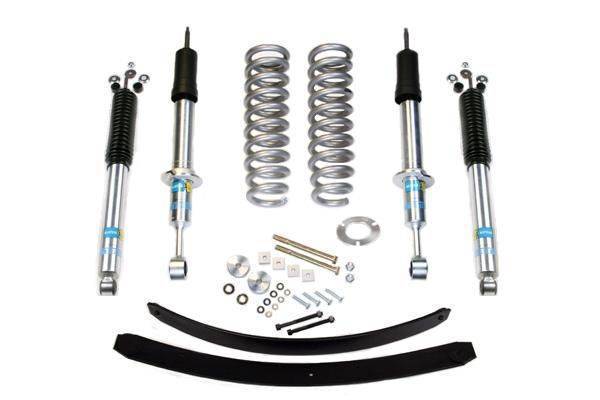

    Option 4: Complete Lift Kit: Eibach 1.6" Lift Springs, Four 5100 Bilstein Shocks, 2 inch Add-A-Leaf, Front Differential Drop, and 1/4" front spacer for leveling.

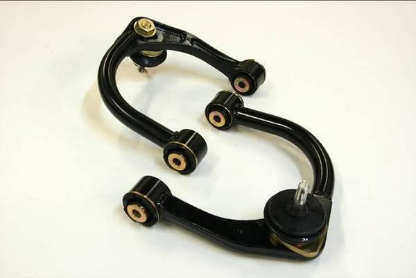

    Option 5: Light Racing Upper Control Arms: This upper control arm provides an additional ±2° of caster and 0° to +5° of camber change. Built with an OE style ball joint and bushings, this arm is designed to correct alignment angles while maintaining factory ride quality. The hybrid tubular and forged steel design is tough enough to race - on or off-road. These remove and replace arms are available in pairs for lifted and off-road applications or individual left and right arms if just one corner needs adjustment.

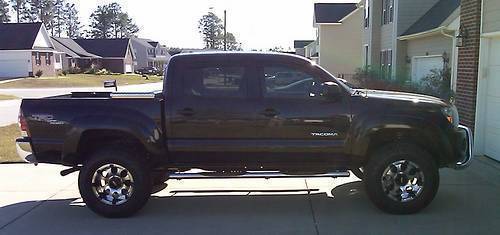

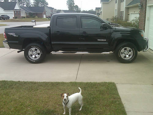

    [/FONT] Before and After pics of the Passenger Side

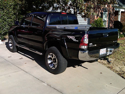

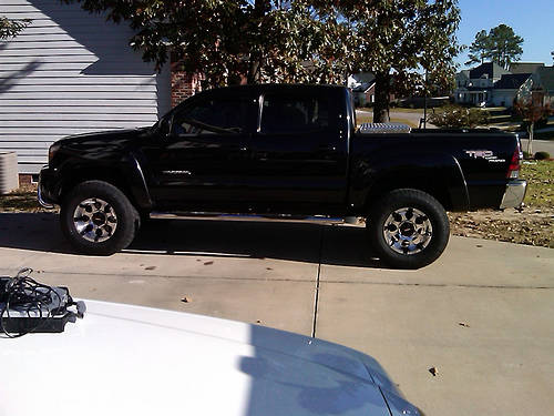

    [/FONT] Before and After pics of the Drivers Side

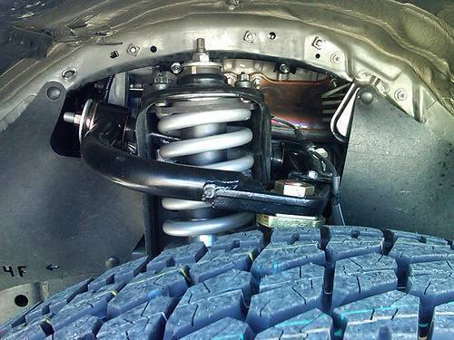

    [/FONT] Some additional pics

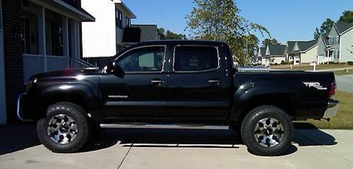

    [/FONT] Tire Profile on the Passenger Side. Tires stick out about an inch.

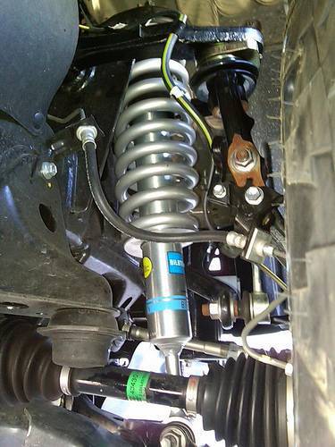

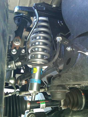

    5100 Bilstein’s set at .85, Eibach Springs, ¼ inch Taco Lean Spacer on the Driver’s Side, Light Racing UCA’s
    [FONT=&quot]

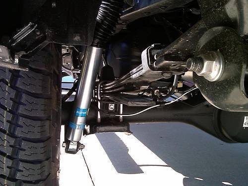

    [/FONT] Driver’s Side – Bottom View

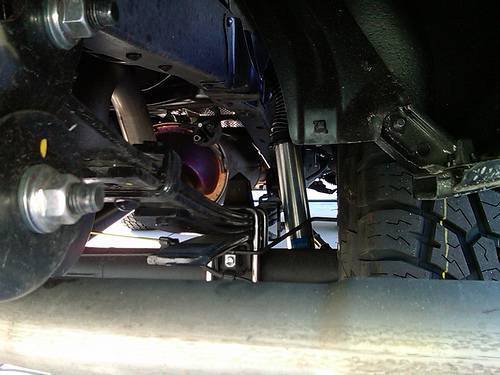

    Passenger’s Side – Bottom View
    Driver’s Side - Rear View
    5100 Bilstein and 2 inch AAL

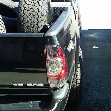

    Passenger’s Side – Rear View

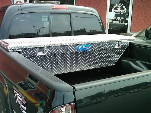

    UWS Toolbox
