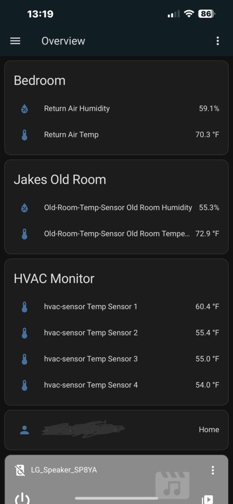

    I'm breaking into the world of HVAC controls and IOT devices so I figured might as well start a thread for us that are into this.
    I recently got my home server setup and will be getting home assistant setup therefore I will be adding little projects to justify having home assistant. I think my first project will be building my own BAS for the house to monitor the HVAC system and automatically alert me if there are any alarms (such as my condenser fan motor dying on me the other day) without me having to be home to catch it.
    Tenative plan is to have supply, return, condensor, and evaporator temps, exterior temp, room temp, CT's on the compressor, condensor, and evaporator fans to ensure they're running when called and that amperage isn't higher than expected, and I would really like suction and supply line pressure and temp so I can auto calculate superheat/subcool, but I'm running into issues finding a pressure transducer that isn't obscenely expensive.
    Plan is to run a Rasberry Pi in the air handler for the brain, the exterior sensors will be hard wired off the 110 on the unit but data will be wireless, and then I have the option to tie it into my home server and home assistant.
    I'm hoping that this is compatible with refrigerant as it's somewhat reasonable
