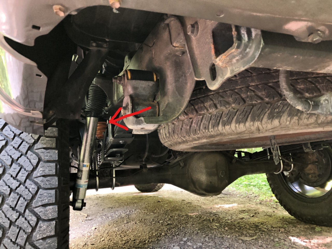

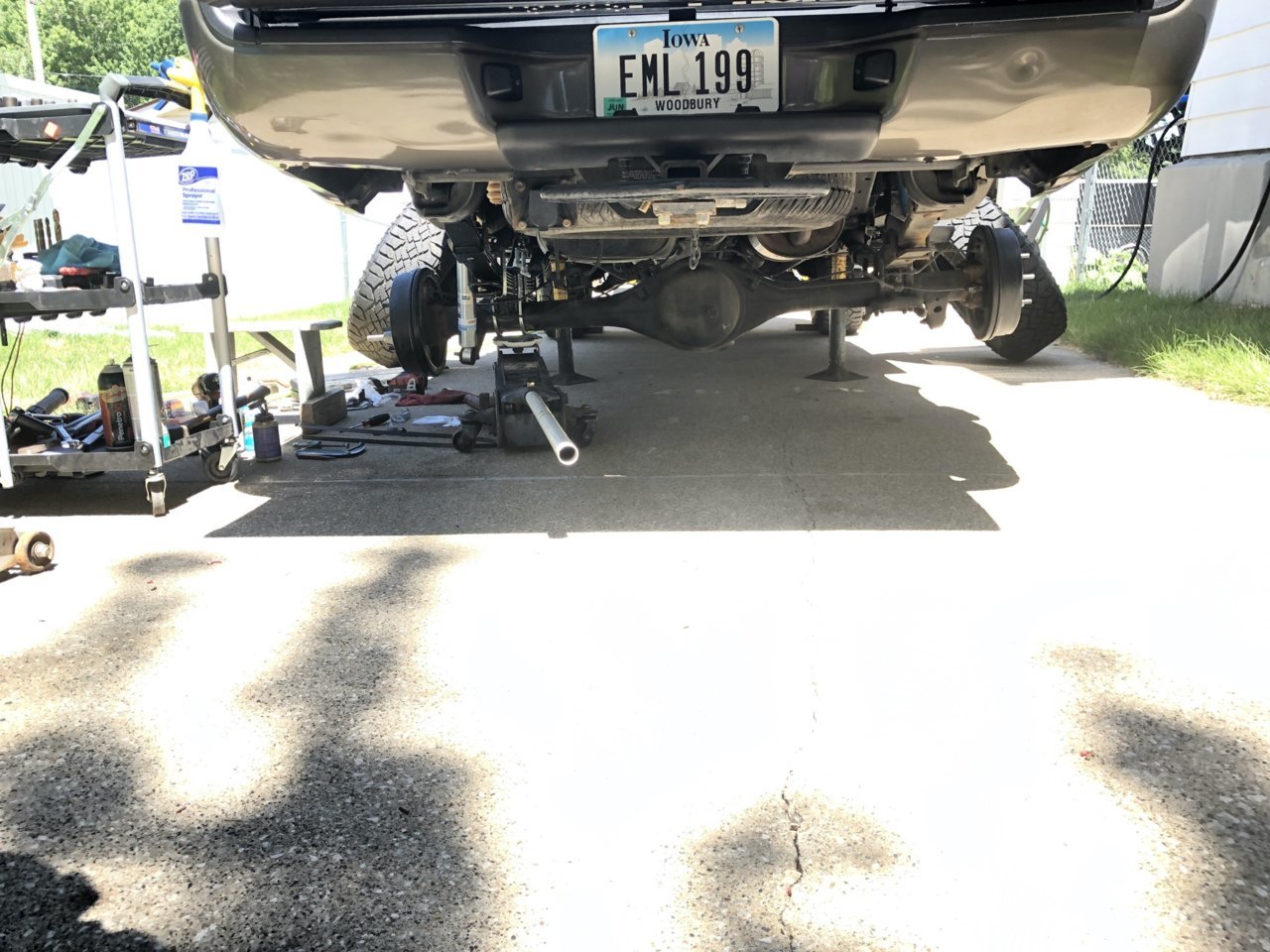

    Rear - OME Dakar Medium leaf springs, Bilstein 5100 B110 shocks, extended brake hose and GM bump stops (pn 15712438). The rear rides much better than when I had the stock leafs and TRD OR shocks, which those shocks were a big improvement over my TRD Sport shocks. The 5100's aren't the best compatibility with the 6112's as far as damping capability. But for the price and the extended travel that I wanted, they fit the bill. There really isn't a perfectly paired rear shock for the 6112's up front. There are some that have tested other rear shocks from both Bilstein and the other big companies. The one that I have seen that is a great match is the Bilstein 8100, but those are around $2k a pair!!! The B110 5100 (16.34" collapsed/27.28" extended) is just an extended length 5100 (14.02 collapsed/22.94" extended) with the same valving/damping ability. As you can see you get 4.34" more down travel! However, there are a couple things you MUST do to use B110's. Extended rear brake hose and extended length bump stops due to the longer collapsed length and you don't want shock to be your bottoming out point. The bump stops I used were the GM ones listed above since they are progressive so it's not like your just hitting a solid poly bump stop. Plus the price is much better than using "performance" bump stops, usually $250. I can get more pictures if you're interested.
    This is just a difference of the fully extended B110 on the left and the stock TRD OR shock on the right. The jack is not actually touching the axle BTW.
    Here is the best picture of how I installed the bump stop. There is a thread somewhere on here with more details I think. But if you want more info or pics from me, just ask.
    Here are the bump stops I used - https://www.amazon.com/General-Moto...al+Motors&rnid=2528832011&s=automotive&sr=1-1
