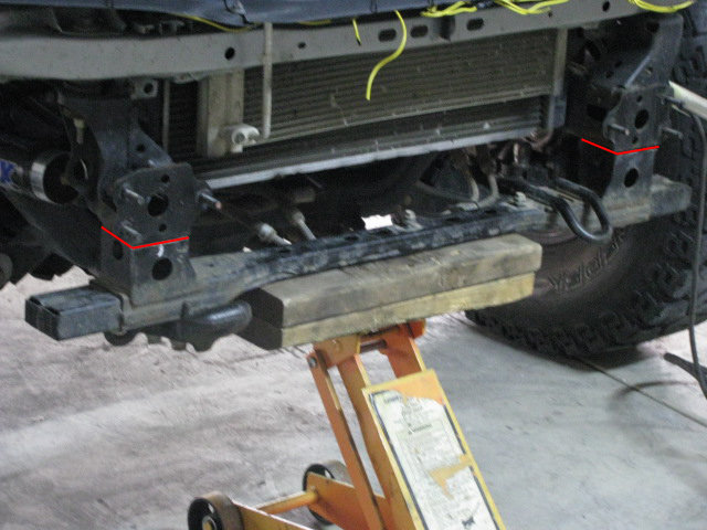

    Sports come with a cheap ass little loop thingy, either way, not good enough for a recovery, the offroads have a hook. I want to take off the trd skid, and cut out the drop down cross member and weld in a replacement that offers higher clearance. At that point I can drill and mount 2 shackle mounts with backing plates that should be pretty stout. Just need it to warm up so I can practice my welding!

    This is the crossmember I want to cut down and replace with a piece of 3/16 or even 1/4 and then add the shackle mounts.

    Looks do-able. Flat stock would probably want to twist or bend, but angle iron could work well.

    A couple gussets couldn't hurt it.
