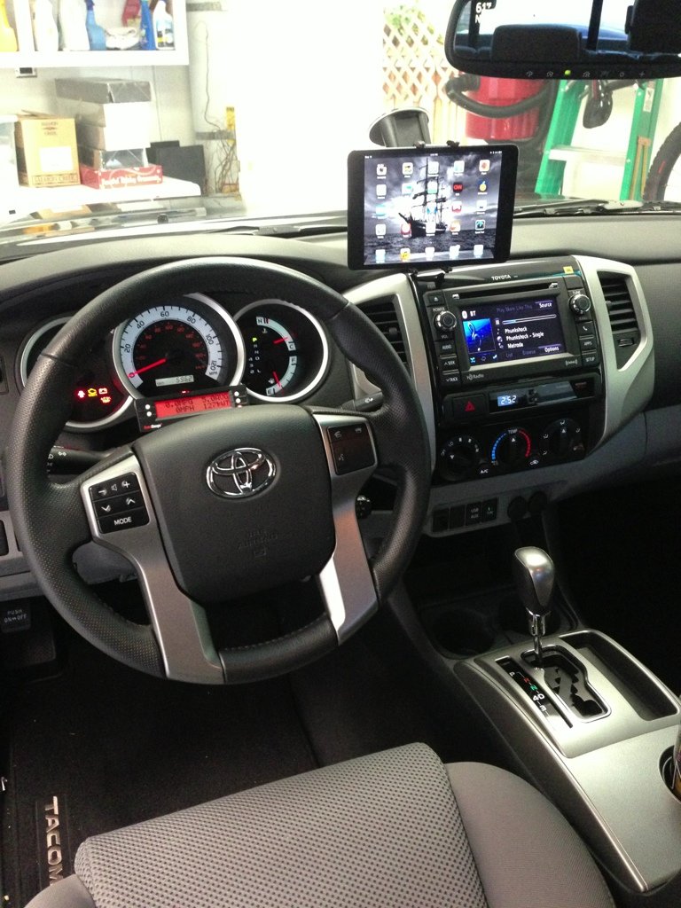

    Is there any way to still have bluetooth audio for phone calls when using an iPad mini? I cant see how. My iPhone is in my pocket, normally that's BT to my 2013 headunit (or any headunit like Pioneer Alpine etc that supports this) and then on the screen "Call from: Bob Smith" but not sure if this is possible with the iPad setup?

    onepremiere I Tinker
    Jun 23, 2010
    #39359
    358
    Jeff
    Left Coast
    D11FFF07-E856-42C3-AC3F-CD731828884F-629_78d419b716edb1e69d7654f0ab9047ec4cf807c9.jpg
    Windshield Mount for iPad Mini for long drives, don't use it all the time.
