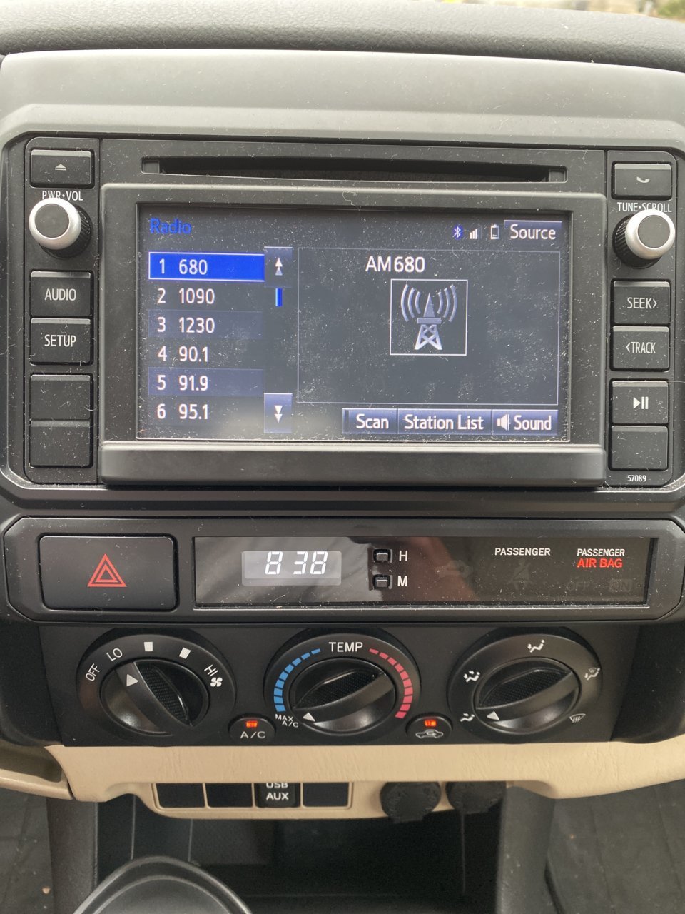

  12. Oct 3, 2019 at 5:40 AM
    #72
    Assists21
    Assists21 Active Member
    Aug 16, 2019
    #302360
    28
    2014 Black Tacoma
    Ok...yeah I don’t have entune in this 2014. Just wish I had a fix for this BT issue. I’m convinced it’s compatibility issue with the iOS 13 software and the software in my HU. My BT is fine for playing music, it’s just the phone call connectivity I am having problems with. Here is a pic of my HU.
  13. Oct 3, 2019 at 6:15 AM
    #73
    TFly
    TFly Well-Known Member
    Mar 6, 2018
    #246489
    864
    Travis
    Richmond, VA
    2018 Cement DCSB OR
    That looks like Entune to me

    I thought entune was only on gen 2
  17. Oct 3, 2019 at 8:15 AM
    #77
    johnnyroid
    johnnyroid Well-Known Member
    Mar 26, 2017
    #214424
    1,780
    John
    Vine Grove (Fort Knox) Kentucky
    2017 Black Tacoma Sport TRD
    All Gen 3s up to and including the 2020 have some version of Entune.
