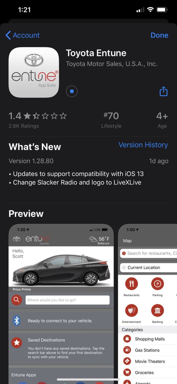

    That’s just a phone app update. Nothing to do with the software on the head unit.

    After I updated the app all works as it should
