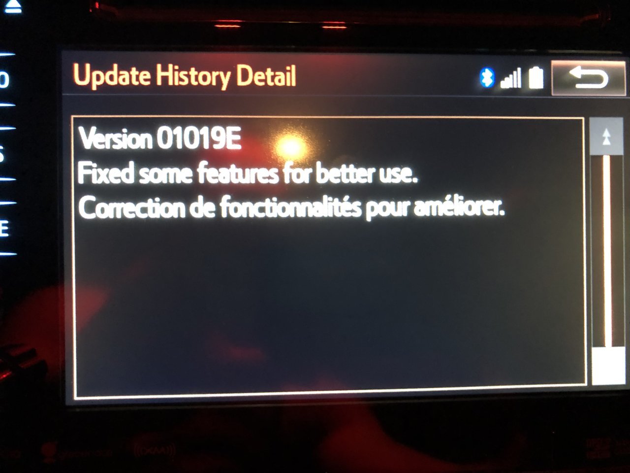

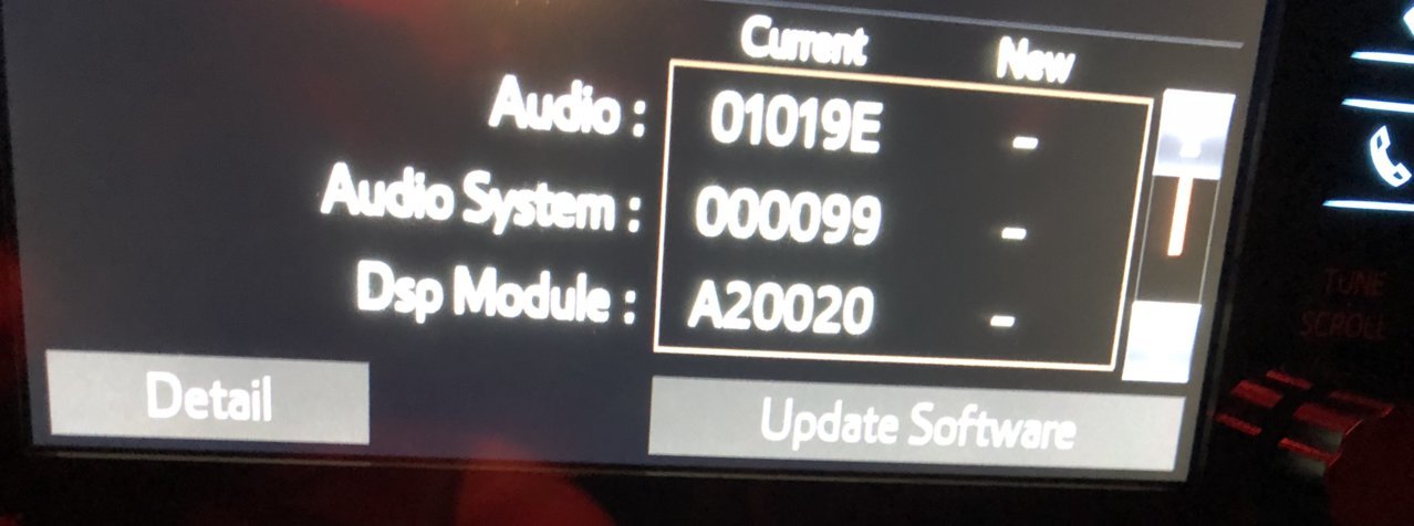

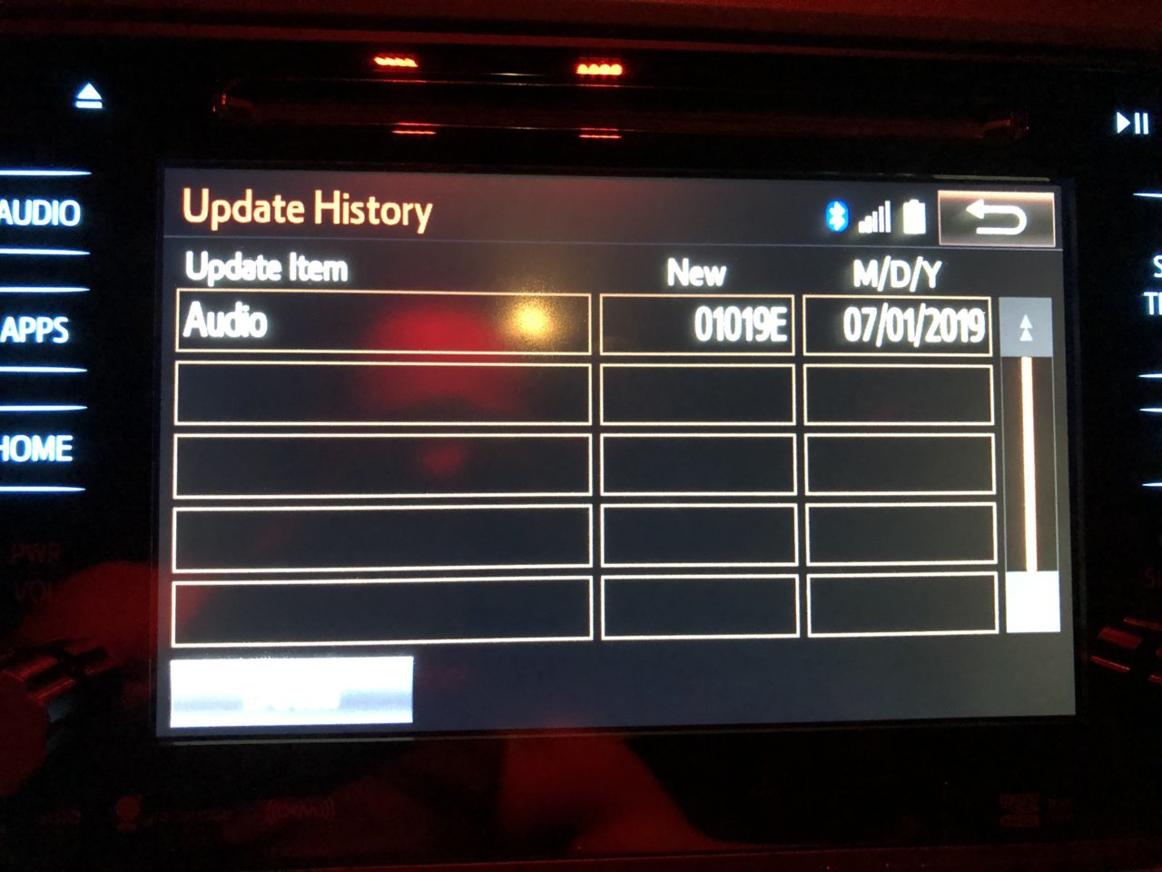

  13. Jul 3, 2019 at 10:57 AM
    #33
    Lateralus01
    Lateralus01 Well-Known Member
    Feb 12, 2018
    #244223
    346
    2018 Cement Tacoma TRD OR DCSB 4x4
    @R_Dub5 whats the latest regarding the audio connection? I took my truck in this week for another issue and asked them to check for any updates for the head unit. There was a newer version than what my '18 had.
    Full disclosure. The update was applied on Monday this week. Since then I have restarted the truck about 15 times and its been solid every time. I don't want to get anyone's hopes up. I will report back in a few weeks with results over that time.
    I am not sure if this will help you to determine if mine matches yours or is newer but here is some info for you to check on your head unit:
  14. Jul 3, 2019 at 11:13 AM
    #34
    R_Dub5
    R_Dub5 [OP] Well-Known Member
    Jun 7, 2019
    #295706
    66
    Rob
    2019 Tacoma TRD Off Road
    That's good info! I'm going to to the dealer next week so I'll ask about the update. I've actually been better for the past couple weeks.
    Problem did happen only once but pushing power button in (resetting) did the trick. Happened only that one time in at least 25 or more starts.
    So I'd say the problem has gotten much better, it was happening quite often before.
    I'll check my version next time I'm in the truck to see if I'm current. Thanks for the reply!
  15. Jul 3, 2019 at 11:24 AM
    #35
    Lateralus01
    Feb 12, 2018
    #244223
    346
    @R_Dub5 no problem. And to be fair no details to share regarding what this update fixes. So who knows long term.
