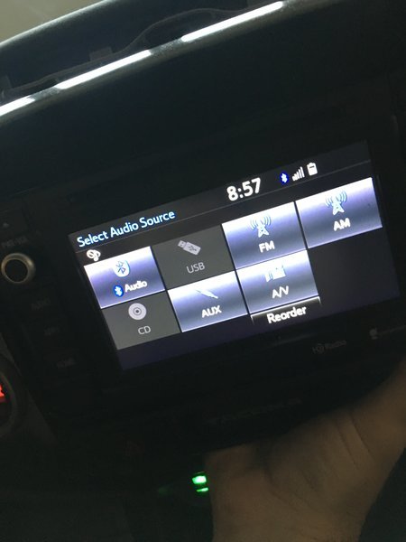

    Yes, it makes one of the buttons on your steering wheel a kill switch to override the whole "vehicle must be stopped..." I know a lot of people here don't see the value but with how absolutely shitty the entune navigation is, this device has been a life saver in our 2015 Toyota Highlander (Google maps, waze... whatever you want). The killswitch to allow video in motion is also awesome for the passenger to have FULL access to the touch screen while you are driving. Stuff like Netflix and movies on the screen are all just bonuses. I was so impressed with the features of the the Crux solution that I bought two kits, one for our 2015 Highlander (installed) and one for my 2017 Tacoma (which I hadn't yet purchased yet).
    One great moment I had with this device was wanting to watch a football game on the way to our a family gathering. My wife was driving and I streamed the game in the car with full video on the display. Win.
    Also, I bought TWO full kits for a total of $256.96 (not including the HDMI to Lightning adapter). So this comes out to $128.48 per kit. I'm sure you can find these kits that low if you search a bit.
    Just to be clear, I went with the Crux AVITY-01 KIT and bought the Apple Lightning Digital AV Adapter separately. Haven't installed this in my Taco yet but seeing how it has the same unit as our Highlander, I'm sure I'll be enjoying it just as much. Just need to find an easy way to route the cable to the wireless iQ phone charging tray area. Good demo of the system here: https://youtu.be/srIRBXpu5aA?t=102

    Crux was easy to install. Same type of installation as the Beat-sonic if I'm correct. The crux adapter basically goes between two connectors on the back of the unit. Unplug stock connectors and put the crux in it's place and then install the stock connectors to the other end of the crux. You then have to figure out how to route the composite/hdmi cables to where you want them to end up (you're going to have this challenge with any kit you buy). So installation was not hard at all. The hardest part is figuring out the cleanest look for your truck. Chromecast does use wifi so I'm assuming you'll use your android as a wifi hotspot or something?
    You can mirror your phone so anything that shows up on your phone shows up on the display (with audio). I literally streamed a college football game from the PAC12 app while my wife was driving. I also use the Google Maps app instead of the one built in to the nav system. As long as you understand this kit does nothing more than mirror your phone (touch screen does not work on the stock display to control phone functions), then this might be the kit for you.

    Totally understand. Just an FYI, though. Your factory unit is still accessible. It's simply the audio input method that you select (A/V). You still have access to you all other apps and screens on your factory unit when your iPhone (or whatever) is plugged in. It doesn't hijack your factory deck. Just want to make sure that's clear.
