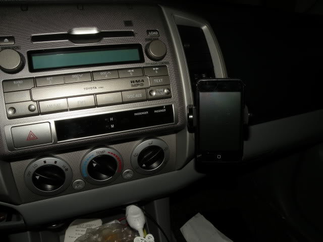

    OK...I tried 2 ways of mounting my Itouch and both were flimsy and I got tired of messing with them.
    I went to Walmart and
    1) Purchased one of those cheap cell phone holders in the auto section. It's the cheap one with the suction cup and bend-able pole. About $7
    2) Purchased a pack of "Bulldog Hardware" corner braces. The package shown is part# HI-978....1.5". I didn't use these, but used the same brand in 2"..part #HI-979......$2......Also used some bolts I had laying around the house
    3) Pulled out the removable black piece below the vent.
    4) Bent the metal corner brace to get the correct angle
    5) Drilled a hole through the center of this removable piece, as well as a 2nd hole lined up with the hole in the corner brace
    6) Drilled 2 holes in the cell phone plastic base.
    I did it in about 20 minutes and could have done a cleaner job, but I was in a hurry. It is very sturdy and the plastic cell phone base keeps the condensation off the A/C vent off the Ipod. I had planned on cleaning it up a little, ubt haven't got around to doing so. I also had thought of mounting it to the left of the radio, but it seemed better to the right. Easier to reach over and change songs. Hope this helps:)
