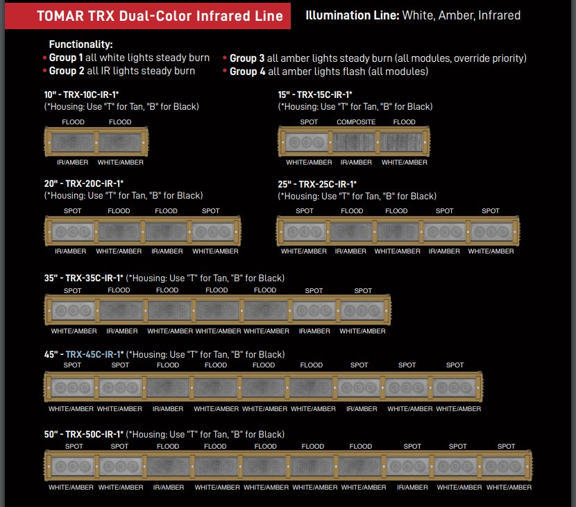

    Im about to pull the trigger on the Tomar TRX-35C-IR-1B. I really like how its modular with white spot/flood, IR spot/flood, and amber all-in-one. Also has flashing amber and dimmer control wire. The control wiring should be interesting to figure out...
    red/white - supply feed
    orange - white
    blue - IR
    brown - amber
    brown/white - amber warning
    green - dim
    https://tomar.com/shop/vehicle-syst...lack&attribute_pa_with-quick-disconnector=yes

    It sounds impressive, but beware. Every other lighting (or other) product I've ever encountered that promises to be everything to everybody - rarely does. All season tires (which are merely average in all seasons), one size fits all anything (which really fits no one), all in one car waxes (which really do nothing well) and universal anything come to mind pretty easily.
