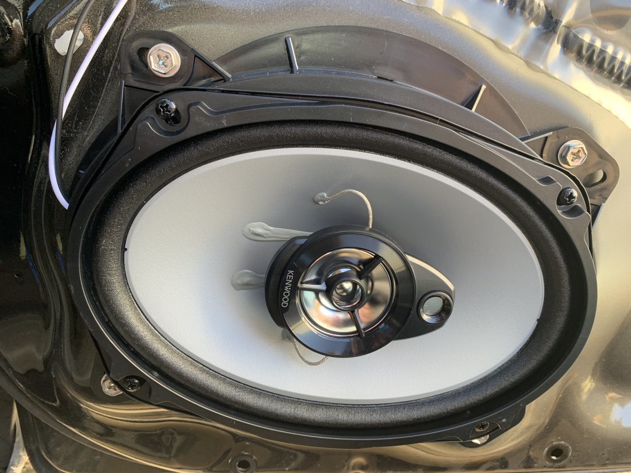

    Installed new Kenwood speakers today. I used Metra mounting and wiring adapters, and they made it a simple plug and play job. Took about 15 minutes per door.
    They aren’t any louder off the stock head unit, but they are much cleaner sounding and way more bass
    Kenwood KFC-6966S Speaker 3-Way Automotive Speaker https://www.amazon.com/dp/B07B6FP8PW/ref=cm_sw_r_cp_api_i_wUoeEbFD4D4JE
    Metra 82-8146 6" x 9" Front Speaker Adapter for Select Lexus and Toyota Vehicles https://www.amazon.com/dp/B00IIC6CPE/ref=cm_sw_r_cp_api_i_-UoeEb1S8XBWV
    (2) Pair of Metra 72-8104 Speaker Wire Adapters for Select Toyota Vehicles - 4 Total Adapters https://www.amazon.com/dp/B01GEIP7RW/ref=cm_sw_r_cp_api_i_rVoeEbXAE110V
