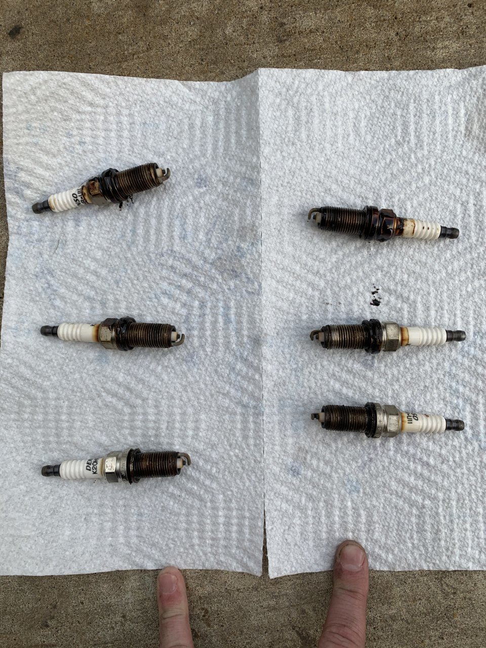

    Just did 90k spark plug change. Spark plugs were covered in oil, so now I’m looking into replacing the valve cover gaskets :annoyed:

    :frusty: Are those the OG plugs? It may just be they’ve lost some spark and got build up. I’d also take a look at your pcv valve that’ll cause build up as well.

    No, this is the third time I’ve changed plugs. Once at 33k when I bought it, then 60k, and now 90k. Everything I’ve seen so far is pointing to tube seals on the valve cover gasket

    Shouldn’t be to hard just getting the wiring moved will be a pain.

    Seems to be pretty straightforward. Although I can’t find a good right up or video on the 4.0. Everything I’m finding is for the 2.7. But it shouldn’t be too hard to figure out
