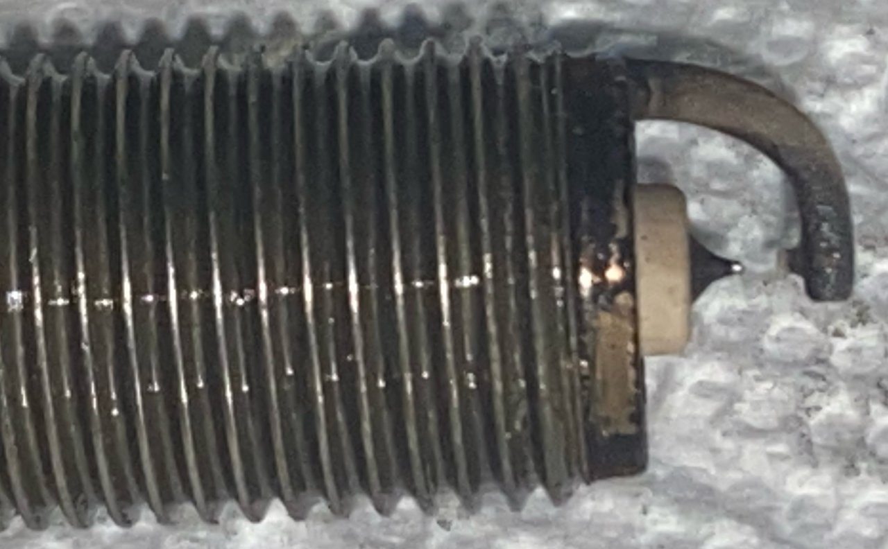

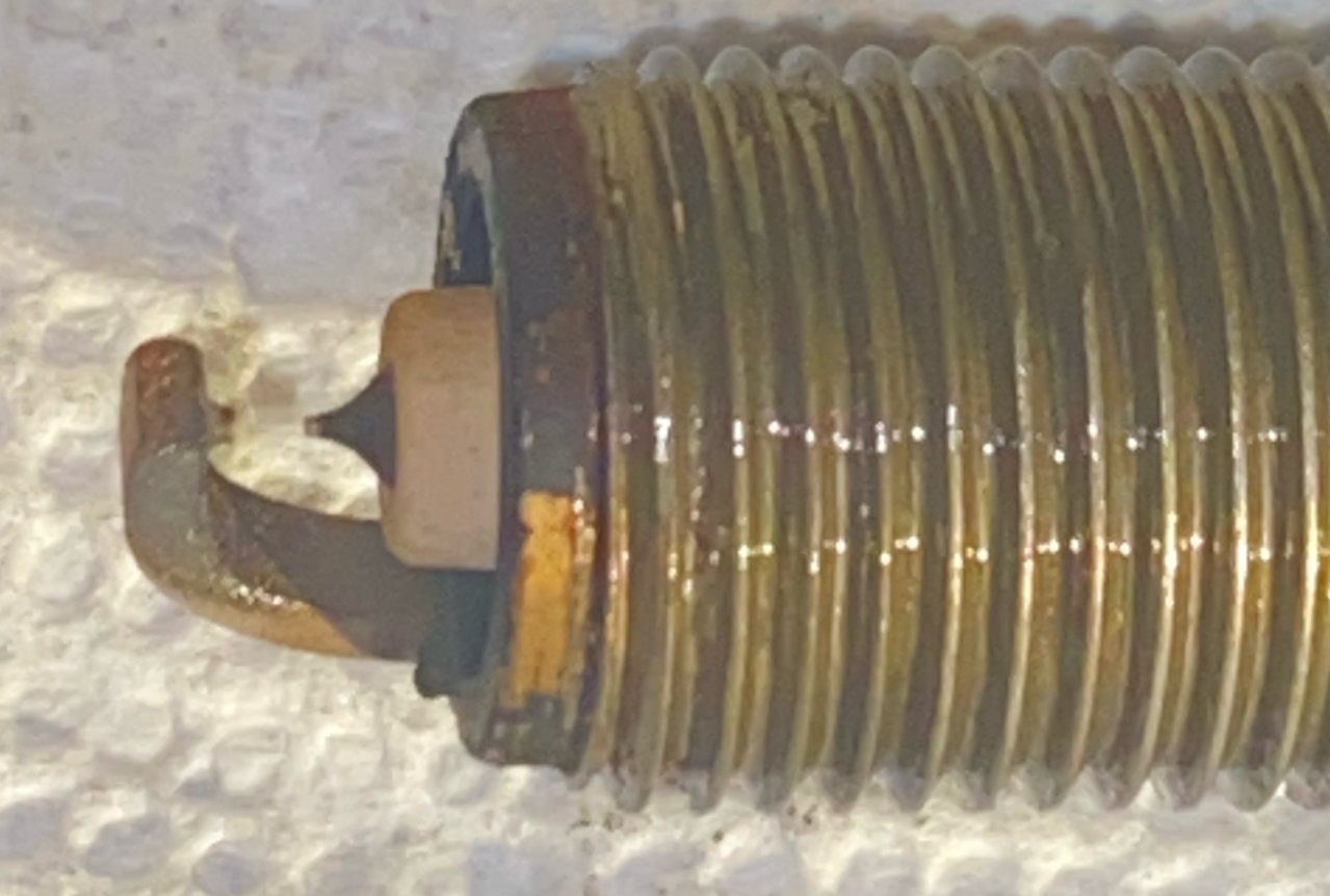

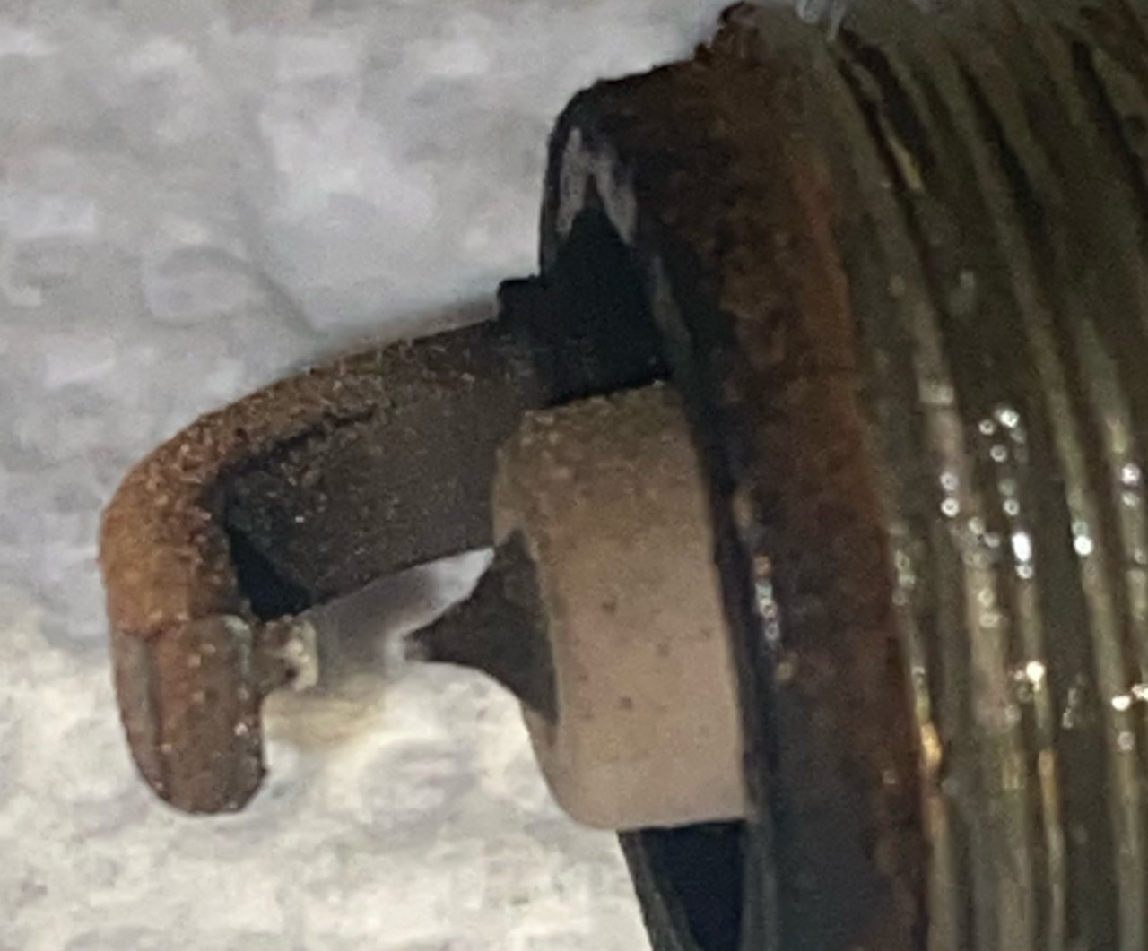

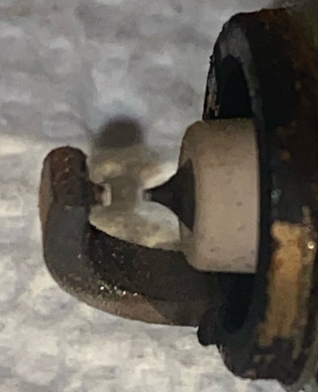

    It was a beautiful spring day and what better way to spend some of those daylight saving time hours than pulling spark plugs :rolleyes:. Gents, the following pictures show the reason why you install iridium plugs. I only pulled one because there is no point whatsoever to pull the rest. Here are the numbers: 88,900 miles on the plugs, gap was set to .040 and still measures .040. Nice tan color on the insulator, and it came out as nice as you please. (I did use anti-seize when they were installed.) I don't know what more to say. Pushing 90K miles and they look brand new. I might pull them at 180K miles on the plugs, but realistically I probably won't keep the truck that long.
