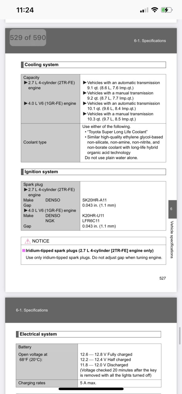

    Hi all. I heard somewhere that I shouldn’t use iridium plugs in my 2011 4.0 Tacoma. Wondering if this is true or false? Somewhere I heard they get too hot? I dunno. Let’s hear what y’all got to say. Thx.

    No iridium or anything stupid like that it's in your manual

    I'm of the belief that you should use the plugs that the engine was designed for. They calibrated the system to be using specific components

    Some have had misfire issues running iridium. Not worth the headache. Run what Toyota says is best.
