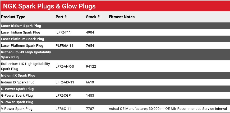

    These are the plugs NGK states will perform in my 2010 4.0. I currently have the copper plugs. I did have a set of iridiums in it for about 50,000 miles and had no issues and I'm not sure what I'll use next. I'll admit, I succumbed to the fear. I think those that had misfires with iridiums had other issues going on, like a bad plug, coil, or connection issue.
    Denso has a similar breakdown.
    https://ngksparkplugs.com/en/part-finder
