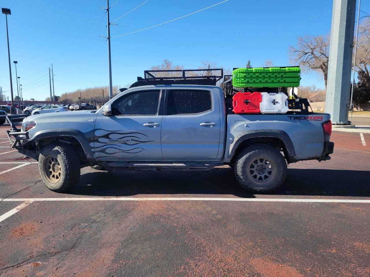

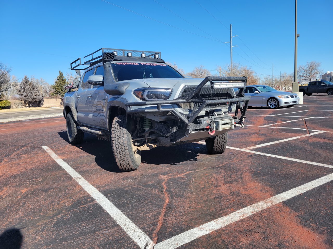

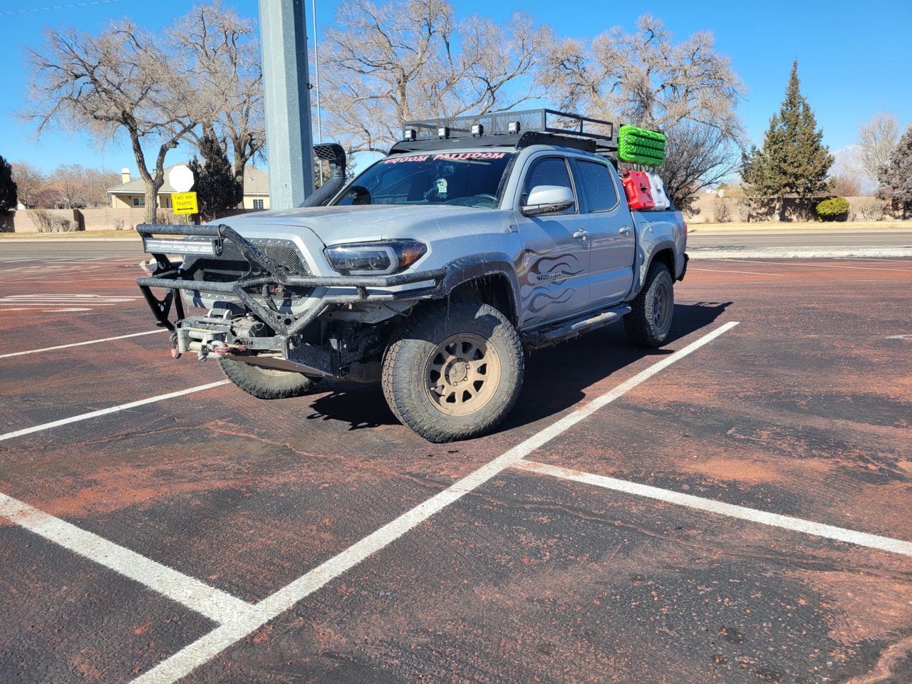

    Ok, finally! PICS!20220204_141221.jpg 20220204_141200.jpg 20220204_141213.jpg 20220204_141249.jpg

    Was your rig used on the set of Mad Max?

  6. Feb 4, 2022 at 1:59 PM
    #26
    weeksz
    weeksz Well-Known Member
    Jul 18, 2018
    #259753
    248
    Adam
    Traverse City, MI
    2017 DCLB Limited
    Stickers mostly
    Now lets see your photo before the lift next to a stock Tacoma... girls carrying some weight! Was probably squatted
