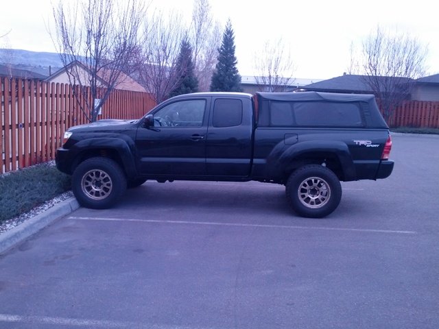

  20. Apr 9, 2014 at 9:08 PM
    #400
    BabyTaco
    BabyTaco Well-Known Member
    Jan 10, 2012
    #70380
    10,920
    Wyoming
    2011 RC Tacoma
    I am bored...soooo time to show off a bit
