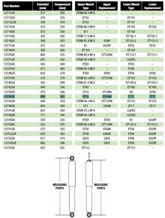

    Hey CowboyTaco,
    This is listed in our Suspension Catalogue on our website:
    http://www.ironman4x4.com/catalogues
    Cheers,
    Ironman 4x4 Australia

    Thank you, Matt. I looked in there, but I guess I didn't look far enough. That is exactly the information that I was after.
    I had to replace my leaf pack and wanted to make sure I was still good with my rear shocks. Looks like I'm all good!
