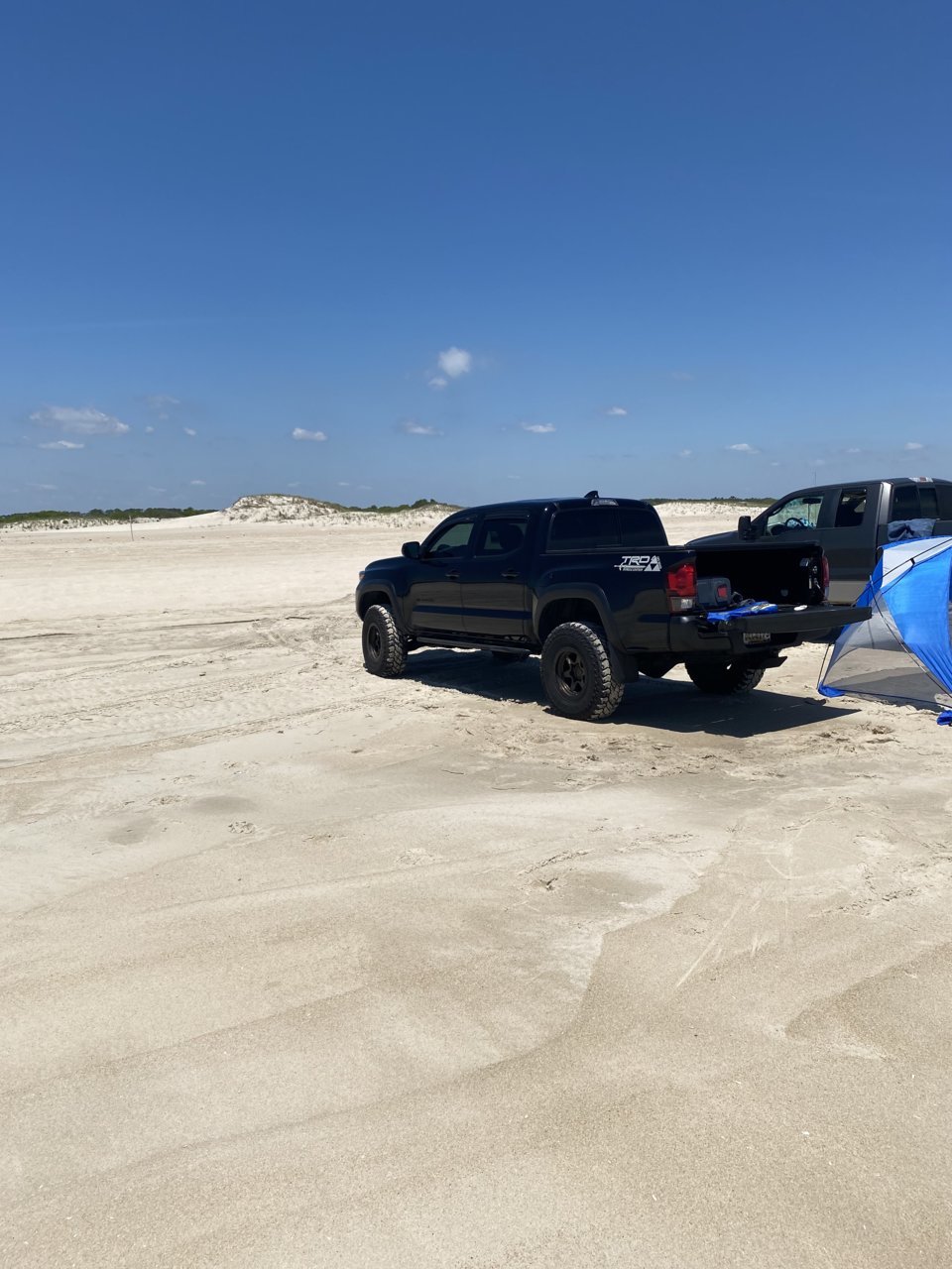

    Well, I built the coils here so it is not going to be the same height that yours will be set at.
    But that was from my initial set up with the 2.5 “B” springs. I’ve since swapped to the 3.0” A springs but still set them to lift my truck only 2.5” or so. I think it rides better with the lower rated springs and I don’t need to worry about my CV boot fins rubbing, causing more issues.
    Someone can correct me if I’m wrong but there is nothing wrong with lowering the height since they are adjustable, even with the longer springs.
    This is the most recent pic I have, as close to level. with the 3” springs set to about 2.5”. Again, those springs give a “softer” ride but are still stiff enough to be worlds better than the OEM suspension.
