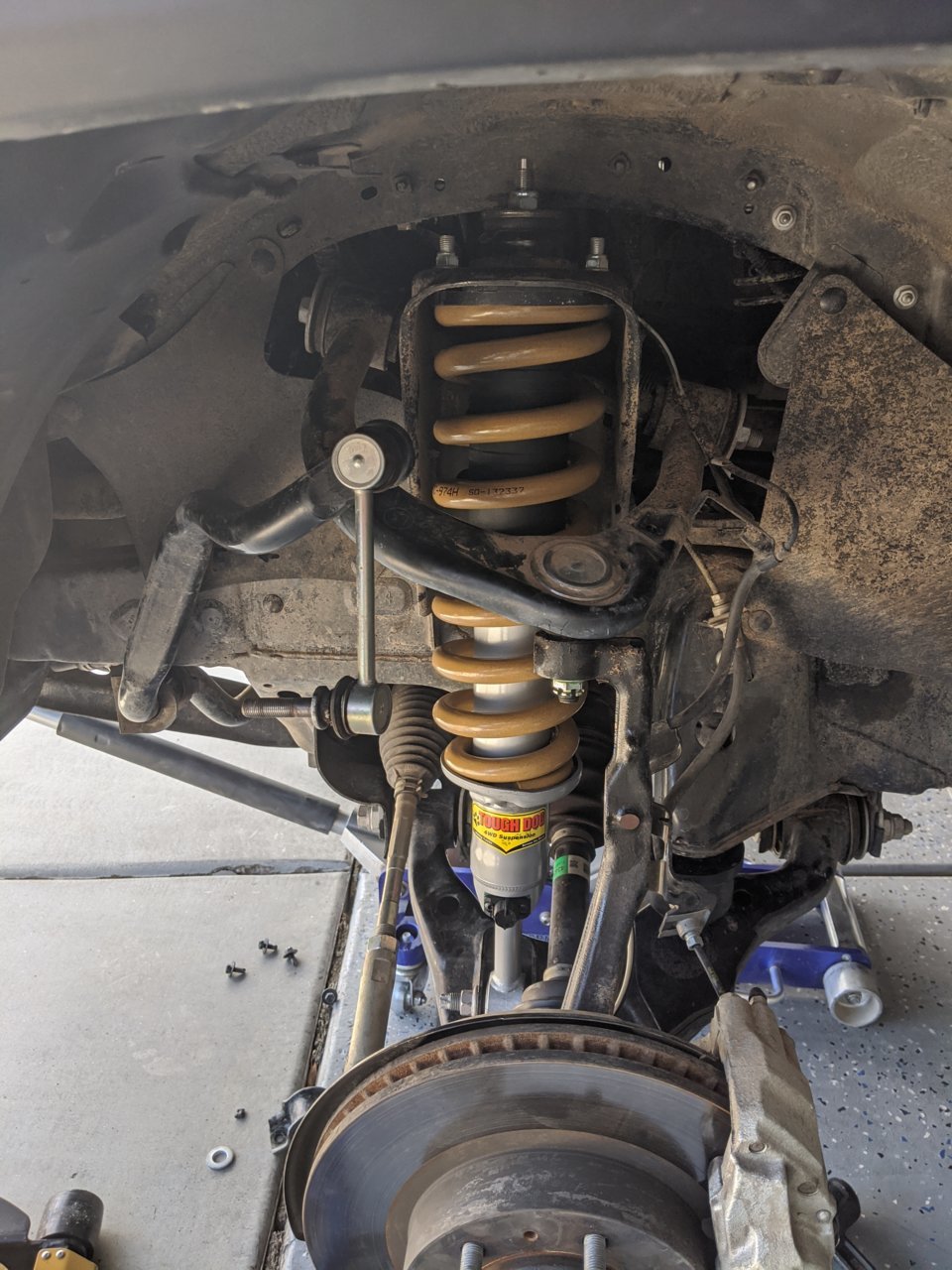

    I "joined the pack" today and I'm loving the kit. Tough Dogs can be acquired from Trail Tailor. Jason is a good dude and worked with Tough Dog and I to get this kit together for the Tacoma.

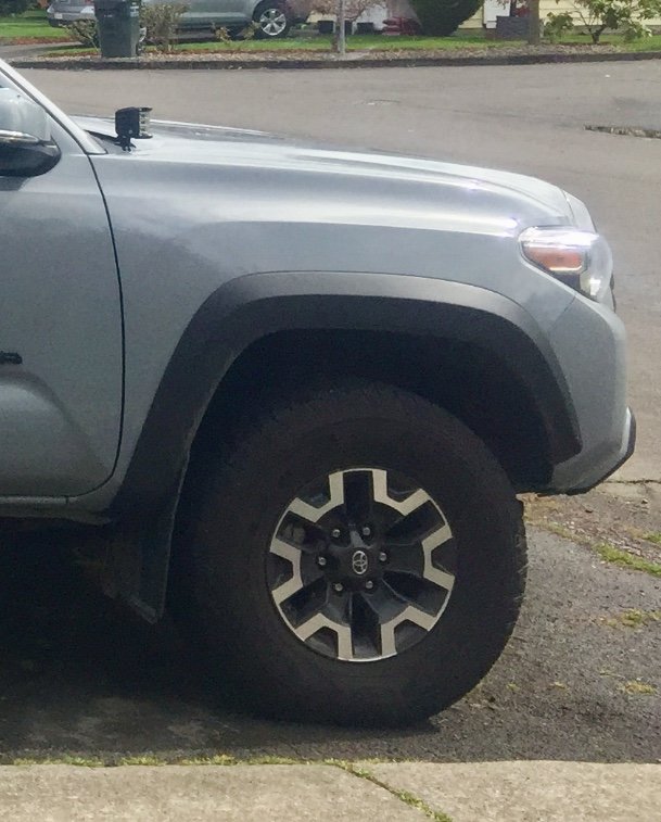

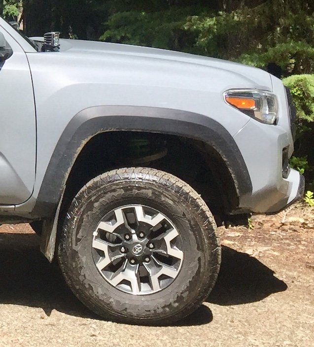

    For this of you who installed the Ironman pro foam cells. What type of lift did you get up front?
    I was parked next to some stock Tacoma’s today and looks like my front bumper is the same or even lower even though I’ve got the Ironman kit on.

    Thanks,
    Looks from the picture like maybe two inches higher than stock? At least 1.5?
    Here is mine between two stock tacos.
