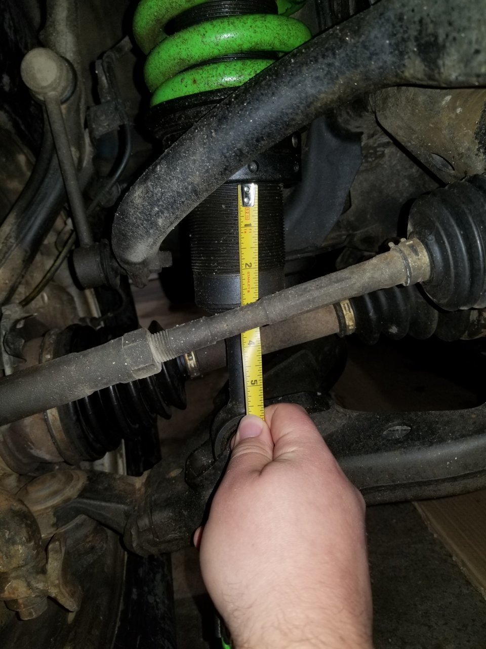

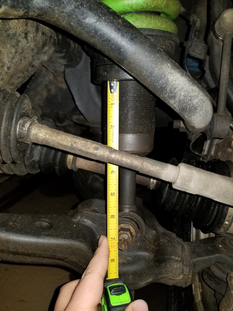

    Im about ready to assemble my coil overs, wish I had spent the extra $100 on the pre assembled coil overs, lesson learned.
    but where do I set the lock rings for the 2.5" lift with the constant load springs?

    I have the constant load springs and these are where mine are sitting at 22.25" hub to fender, so you might go an extra .125" or .25". Just went and took these, hope they help.

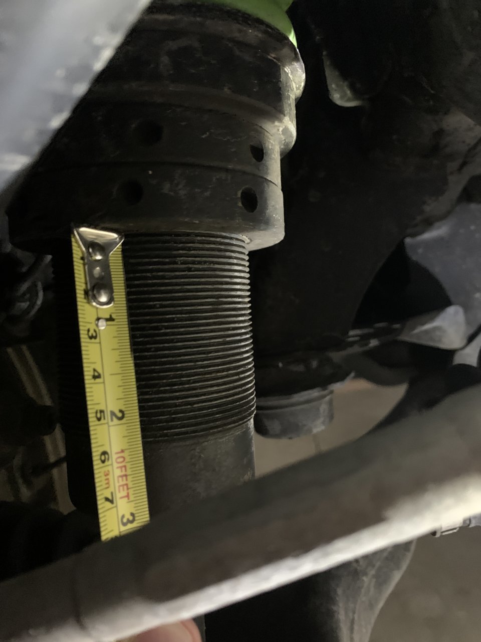

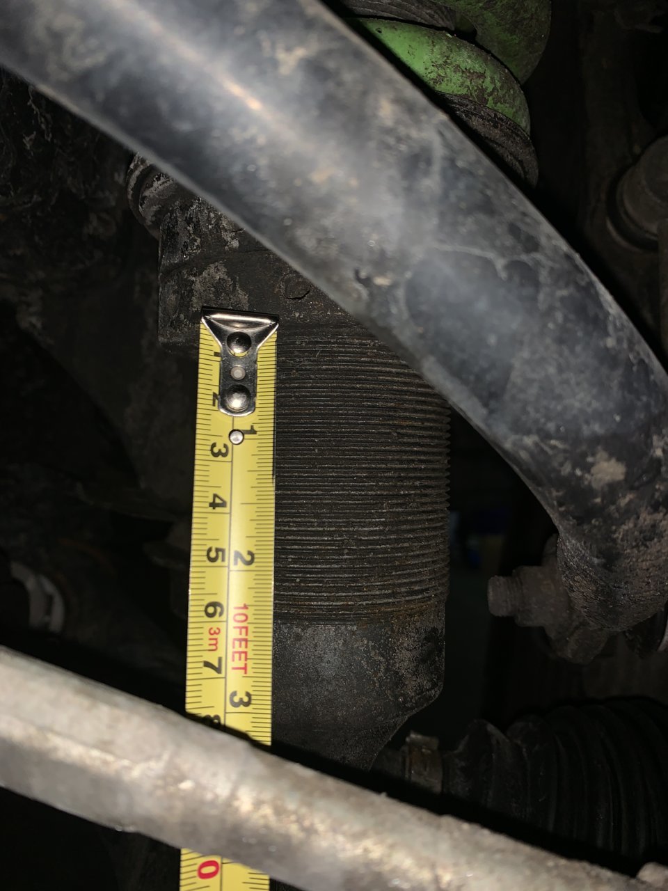

    Ironman FCP Stg 2 FN f(x) AT3W 285/70/17 RSI SmartCap
    These pictures and measurements are WAY easier when everything is laid out in the living room! HAHA
    Here is my contribution. Rough measurements from hub to fender are 22.5-23"
    After looking into it, I think my passenger side (2nd pic) is running about 1/2" higher than my driver side.
    Although the gas tank is near empty so that may be a bit of it. Didn't notice it until I started milling around with the tape measure...
    IMG_2913.jpg Driver
    IMG_2907.jpg Passenger
    Hope this helps! These are definitely worth the $100 to ship assembled, I learned the same thing...

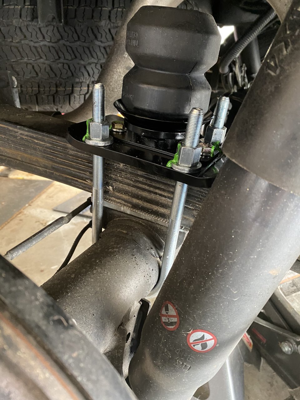

    How much excess is left with the timbren kit? I was looking for bump stops but the whole kit seems like a nice simple swap.

    I have the "performance" leafs, but there's plenty of extra threads. I don't have a pic, but if your looking at the timbren bumps, the threads stick out a little less than half the rubber (and no, I don't have any spots on the frame where the bolts impacted it). I did use U bolts from wheeler's though, so I'm not sure how long the U bolts are that come with the kit.

    here is the Timbren kit, I also got from Wheelers- I don’t have the axle shin in there anymore. Here is a video of them in action over several speed humps https://youtu.be/yja409Lhk7E
