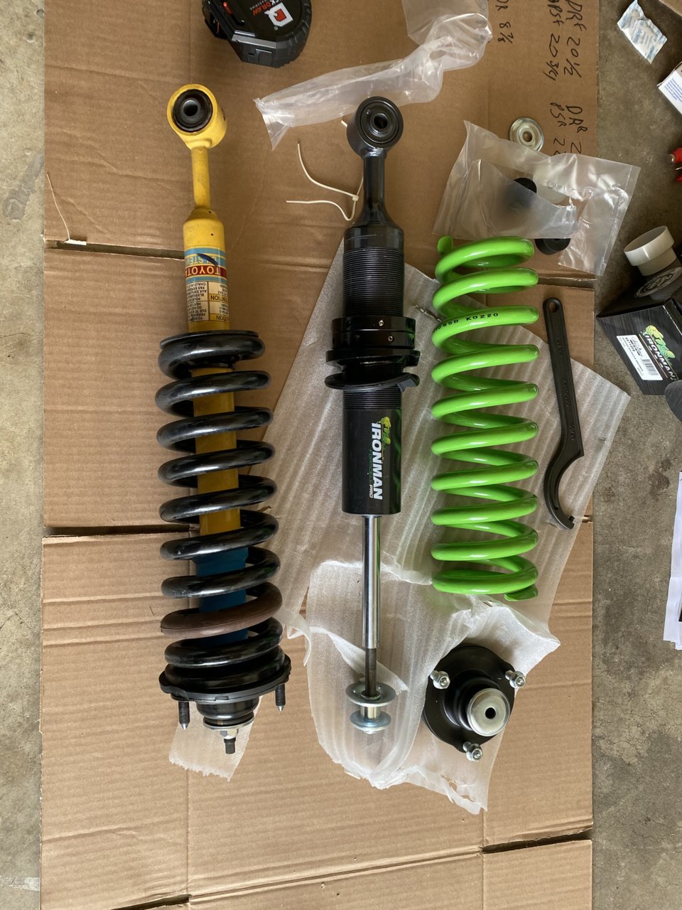

    I opened up my boxes to inspect the parts and the front struts are just covered in scratches and worn off paint from the piss poor packaging. Wow so glad I spent all of my money to get damaged goods. Sure it’s just the paint and anodizing but come on. This is pathetic.
    I had to do a Google search to find the spring seat settings for The 3rd Gen Tacoma. I guess it will apply to my 2nd gen. Thankfully someone here on TW was smart and put the document on a thread which IM doesn’t do on their page for the Tacoma kit.

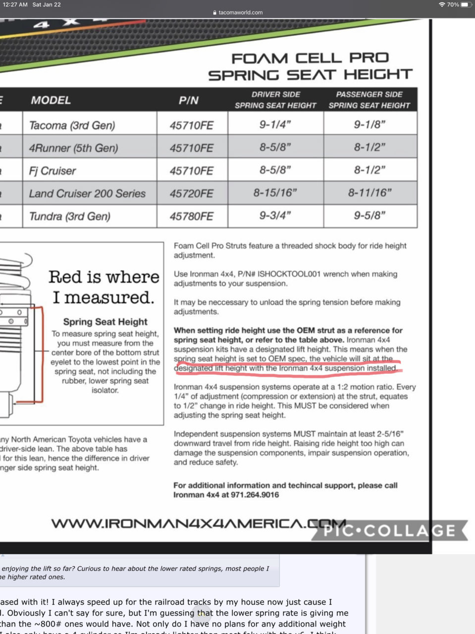

    Does this mean setting it at the height the table is showing it’ll give me 2.5 inch of lift??
    It says setting it at Oem setting it;l be at the designated lift height?

    Im actually, not sure… I didn’t compare mine to the oem at all, besides maybe a picture comparison. I used the sheet to set it.
    Your putting it on a pre runner? Is it double cab? You might want to reach out to IM and ask, since the weight difference might play a part in what setting you want. They should be able to help. Not sure though.
    From my pic, you can kinda see the seat heights look like a similar distance to the bolt hole.

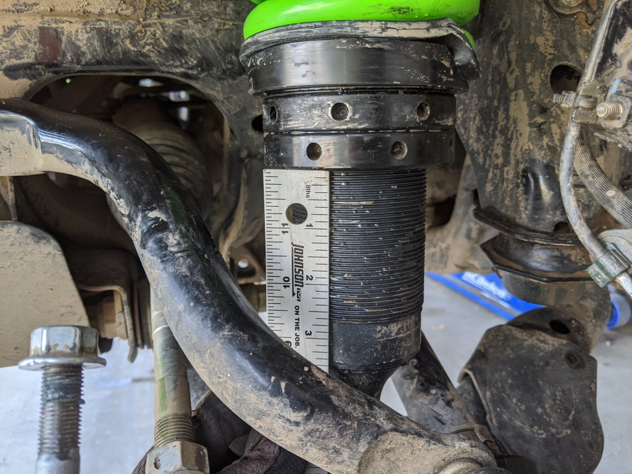

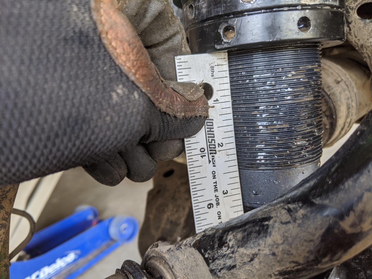

    IMG_20220118_092516_349.jpg So here's my measurements running foam cell pros don't really know my lift since I'm running with no flares plus cut fenders lol
    2.5" of thread on both sides

    This got me 3" in the front w/ plate steel bumper (driver side first pic)

    That's what I use to have it at but my front end was TOO STIFF so I brought it down 3 turns now it's a lot smoother actually feel like bringing it down another 3 turns because I'm just running a winch and a bumper that I built that weighs like 90 pounds lol
