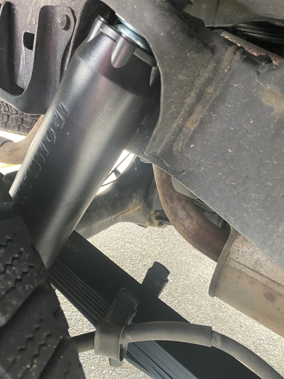

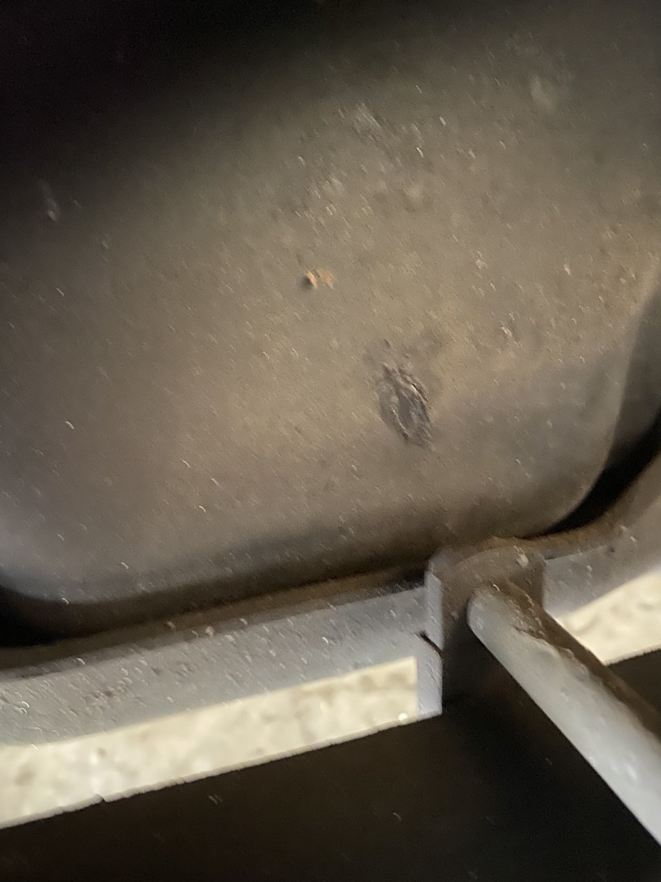

    Oh yea, just as a heads up, check the bolt on the drivers side leaf ?retainer? I’m not sure that movement/flexing made mine touch/dig into the gas skid or if the dealer did it when dropping the tank for the fuel pump recall. I’ll have to look and see if I have a pic in a little bit to post.
    I ended up putting some washers under the bolt head to move the end of the bolt away front the tank/skid

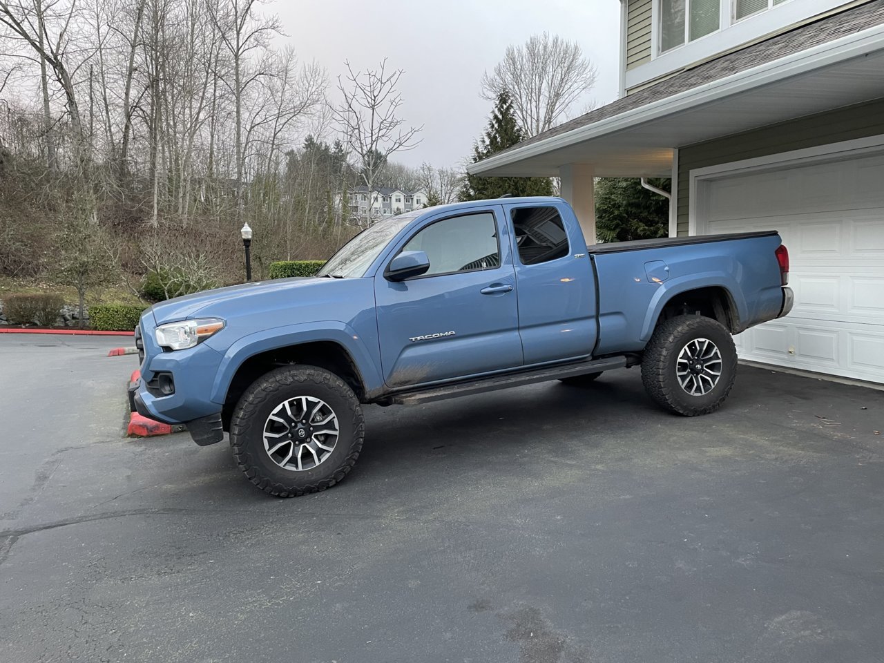

    Ended up taking the truck out today. Drove around a teeny little loop trail for about 10-15 minutes. A fairly smooth gravel road in and then a little twisty dirt track in a little wooded area. No massive ruts or potholes, but I’d say comparable to a nicer forest service road.
    The ride is a million times better than before. I only got up to about 17mph since the trail was really tiny with lots of turns, but with the stock suspension I probably would have taken this trail at a max of 10 or 12mph and still would’ve been bouncing around. I think a comfortable speed (w/ stock) would have been like…5-7mph. So cruising through at 15mph is a huge improvement! I wish the trail had been longer with more straight (or straighter) areas so I could see how fast I could comfortably go. Definitely a great little test run :yay:
    A wee bit of mud!

    You should turn that bolt around so the head is on the inside of the leaf pack near the gas tank and the threads are facing outward. All the bolts on the drivers side spring retainers should be facing outward to avoid possible interference. Pretty quick to do without jacking up the truck too.

    I think I tried that before I put the washers behind the bolt head. I just was not able to get the bolt in the other way.

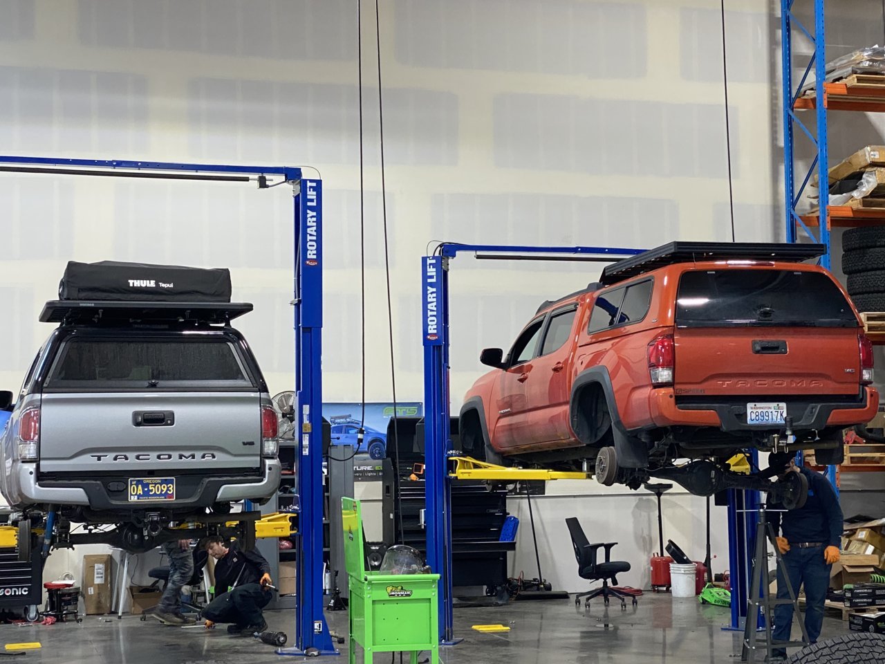

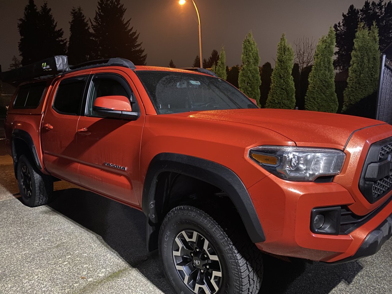

    Last week went into Portland for an appt. New legs for the Taco. Stage 2 Foam Cell Performance 2” lift.
    Did not measure prior so my measurements now would have to be compared to someone else’s or the dealer down the hill.
    Got a 270 degree awning, mounted that up yesterday.
    Haven’t gotten much off-road but did have some time up at the Summit at Snoqualmie parking lot (pot hole laden dirt), and the ride was night and day. Love the feel on road as well as off.
    Have a topper which does put weight on the rear. It leveled out how the truck sits as well as adding height. Haven’t changed the wheel/tire from stock size, not sure I will for a while.

    Curious, did you go to Ironman for the install? If so, do you mind saying how much did you end up paying for install?
    hyrule_trd likes this.
  18. Jan 25, 2022 at 10:16 PM
    #2038
    audiopudding
    audiopudding Well-Known Member
    Dec 9, 2017
    #238102
    171
    Republic of Cascadia
    2017 Inferno Tacoma Off-Road DCSB
    AVS in channel rain guards Bed matt Roof rails 3m Vinyl wrapped hood and mirrors Removed TRD Off Road bed stickers Snugtop Rebel canopy matching color http://www.snugtop.com/product/rebel Navigation screen protector https://www.amazon.com/gp/product/B073LM7KM4 A/C Drain mod fix Thanks to @Uptown2k https://www.tacomaworld.com/threads/rust-on-frame-with-a-c-drain-mod-fix.444138/ Bed cubby covers Thanks to @micwillia https://www.tacomaworld.com/threads/bed-cubby-covers-for-sale.491909/ Extended height fuse cover Thanks to @mesojdm (who will be thanks a lot, by a lot of people) https://mesocustoms.com/collections/toyota-tacoma-3rd-gen/products/extended-fuse-cover Ultimate Map Lights Thanks to @mesojdm https://mesocustoms.com/collections/toyota-tacoma-3rd-gen/products/ultimate-map-lights Ultimate Dome Light Thanks to @mesojdm https://mesocustoms.com/collections/toyota-tacoma-3rd-gen/products/ultimate-dome-light Total Tail Stage 1 Thanks to @mesojdm (wired my own but bought his for his for the custom designed switchback t10) https://mesocustoms.com/collections/toyota-tacoma-3rd-gen/products/stage-1-3rd-gen-tacoma Ultimate LED turn signals Again, thanks to @mesojdm https://mesocustoms.com/collections/toyota-tacoma-3rd-gen/products/ultimate-turn-signals Center console tray https://www.amazon.com/gp/product/B01KI3WG1O Truck bed header rail https://www.amazon.com/gp/product/B00DWVN9CK Total Chaos bed stiffeners http://www.chaosfab.com/2016-2017-Tacoma-Rear-Channel-Bed-Stiffeners-48676
    I did, purchased it from them over the phone to be held at their warehouse. It was just over 1k for the install. I purchased a set of lights on checkout so I'd have to take a look to quote the exact amount but it was close to $1100.
    They were really awesome, very informative and good hosts. I was working remote out of their lobby the entire time.

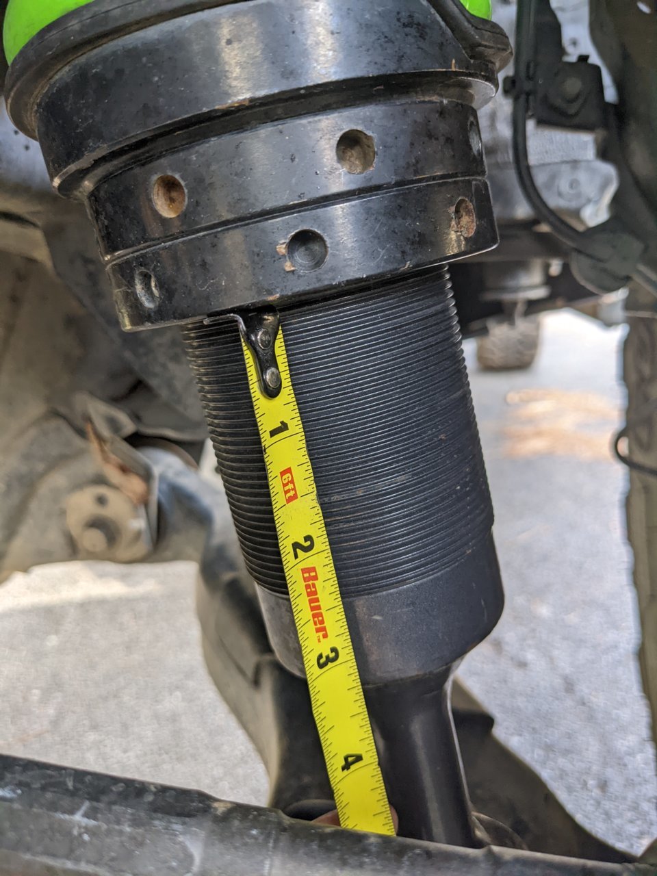

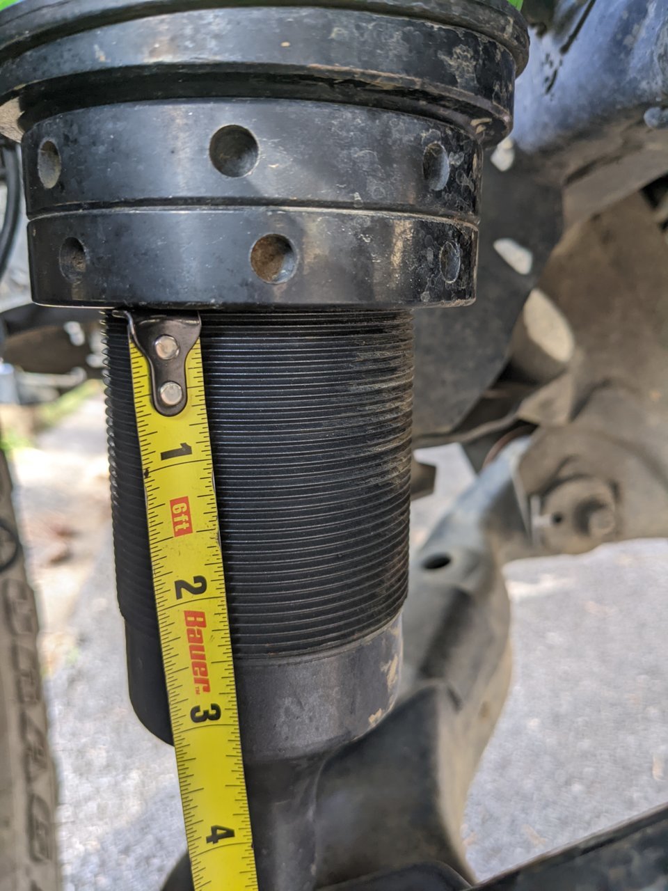

    Iron man shipped me a set of replacement front shocks since mine came with a ton of cosmetic damage. I also spoke with someone via email on the correct spring bucket height and he said the pdf I had found in Tacoma world has never crossed his eyes before.
    From Ironman 4x4 USA
    “set the coilovers at 8-7/8 driver side and 8-5/8 passenger side.”
    that’s with the TOY065C springs. So I’ll be going with this setting and adjust.
