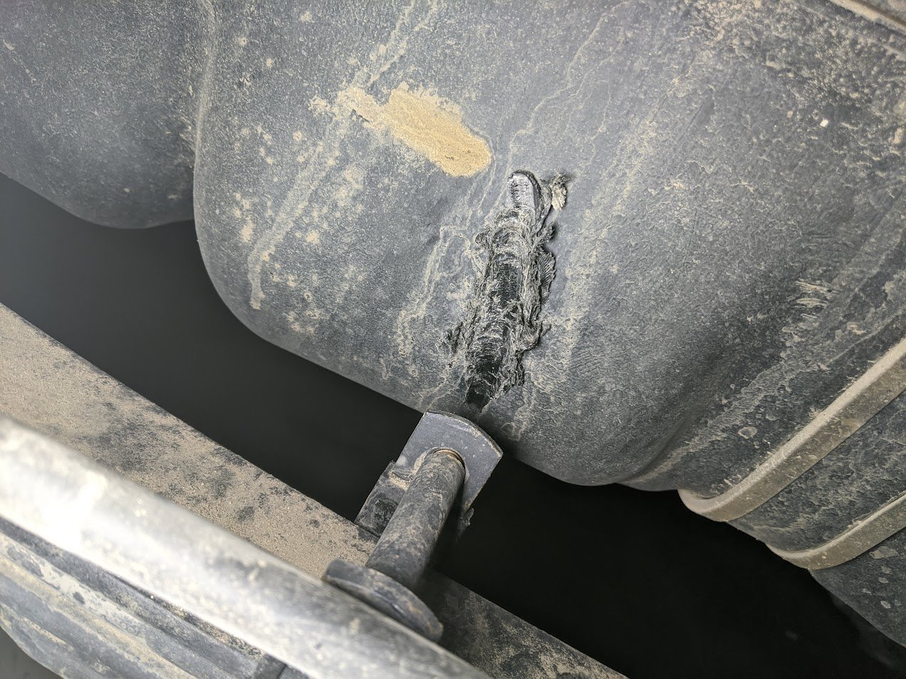

    Ironman Stage 1 Foam Cell Pro lift kit, 255/85/16 Cooper ST Maxx, SCS BR6 Wheels, SPC UCA, Heated seats, MESO TRD start button, Meso Total Tail v1, Meso V5 mirror white DRL turns, bed decal, ditch and hidden bumper lights, screen protech, RAV4 radio knobs, steering wheel anytime camera kit, dash cam, ECGS bushing, Timbren Active Off Road bump stops with Wheelers flip kit. 35% Xpel CS Ceramic Tint, KD Max Tune, SumoSprings front bump stops, RRW Sliders ‌ ‌ ▲ ▲‌ ▲

    Glad I popped on the thread this morning... holy shit. Guess I'd better figure this out. Why is this seemingly only a recent thing? I read through this entire thread a few months ago and never saw this before. I wonder if they changed something.

    Easy fix to anyone wanting to remedy. Floor jack on the pumpkin. Factory jack between the frame and leaf pack. (to clear the bolt on the tank so you can slide it out). Don't even need to remove tire. Just flip the bolt around.
    That said: I'm pretty pissed. Part of me feels like IM owes us new gas tanks. How safe is this shit with this gouge on my tank?

    Yours is definitely the worse I’ve seen, not that there have been many. Maybe it’s more widespread but people don’t know to look. I’d get in contact with them about it. I did message them on IG but mine is not bad.
    Thanks for sharing your fix!

    I sent them a message through the website. I've been a pretty big ambassador of this kit so far but this ain't cool... I hope they prove themselves as a company and pony up to make this right.

    Already heard back from Ironman which is cool considering it's the weekend... but because it's the weekend the response was pretty much "yikes. try and flip that bolt around and hopefully we'll have more for you on Monday." Understandable. Nice to get a response regardless.
