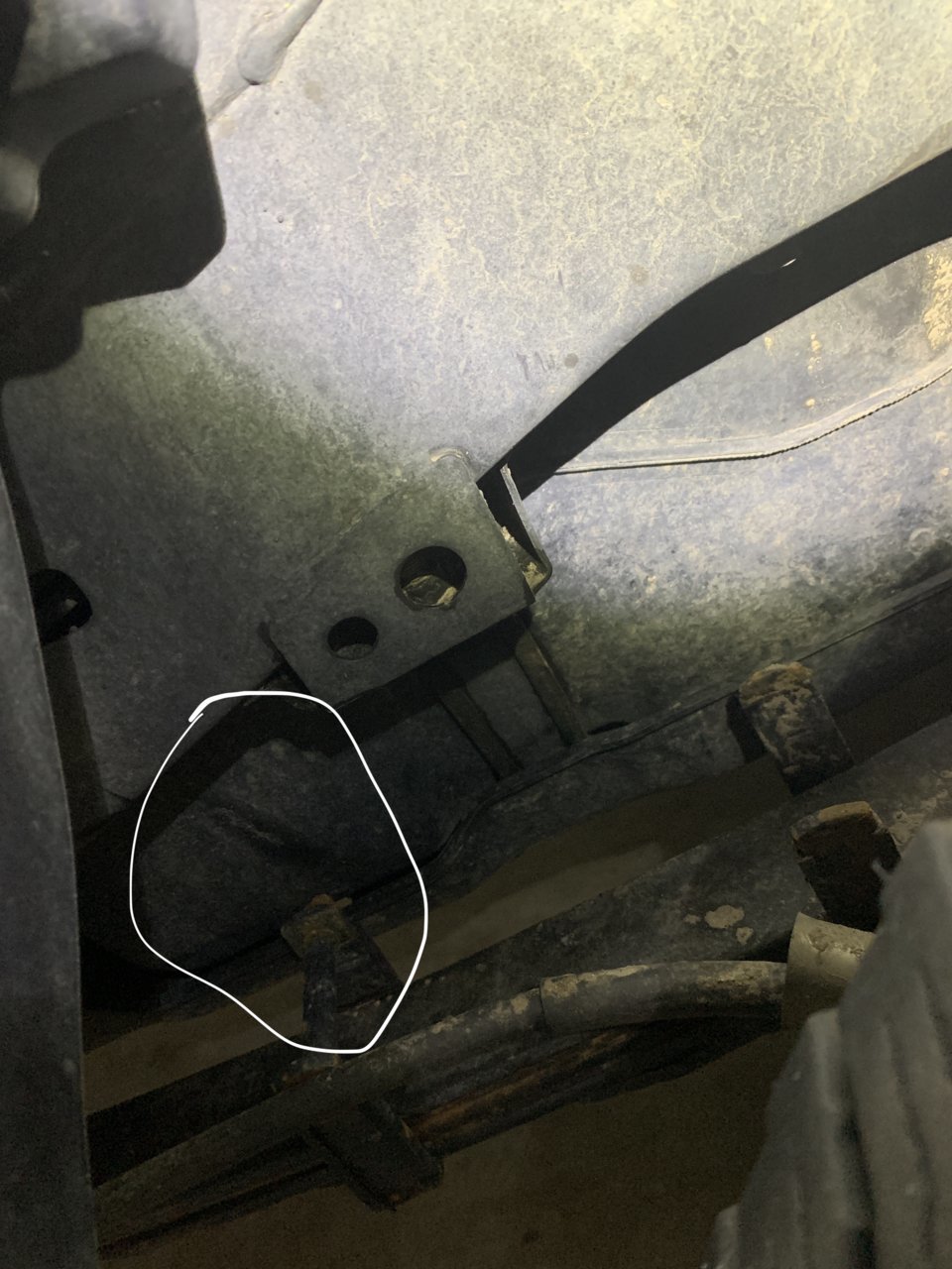

    That's a negative. The complaint here is that Ironman sent the bolt installed backwards and it gouged my gas tank.

    @the.shelbysaurus - I was searching the non-US Ironman sites. They seem to have more technical info on their pages. I saw other photos as well where the bolt head was facing the tank. It really seems as though there is a defect in the assembly - OR we're supposed to assume D/S is actually N/S here in the US as mentioned above.
    @LiquidArrogance - Thanks again for the photos. I was able to flip that bolt with your method. I had to pull the plastic cover off the fuel tank, but that was simple.
    Thanks to the person who first posted this issue. My tank is probably ok, although I'll probably have it checked out.

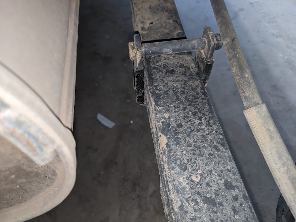

    oh, edit to add: @hyrule_trd I have the performance/comfort load pack and I just went to double check the bolt. My driver's side leaf pack is installed in the correct front/back orientation and the bolt head is on the inside. On the passenger side though, the bolt head is on the outside.

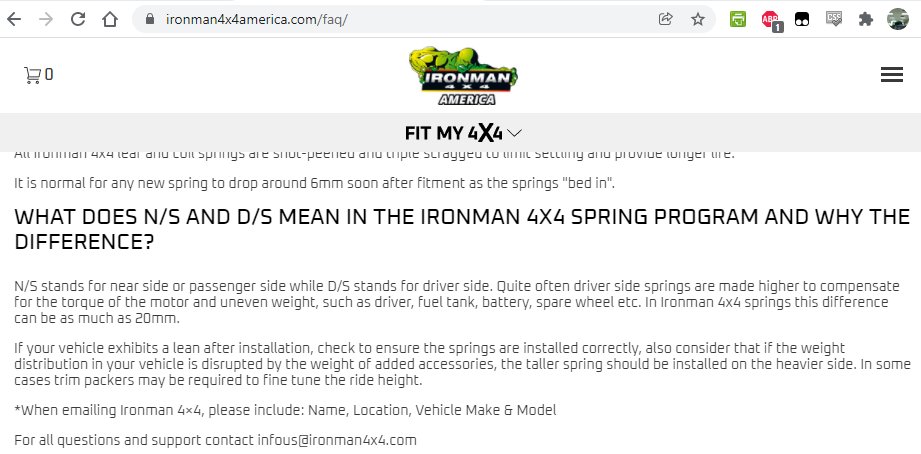

    Two problems with this theory.
    1: On the IM4x4 America website they specify d/s as driver side and therefore I put it on the driver side. If they wanted me to do the opposite they should have said so.
    2: Even if I HAD done the opposite... they still got it wrong! The bolts on my passenger side spring would ALSO be gouging the fuel tank if installed on the driver's side. The way they were shipped, every single bolt HEAD faces the driver's side of the truck when installed with the stenciling on the leaf spring toward the rear of the vehicle.

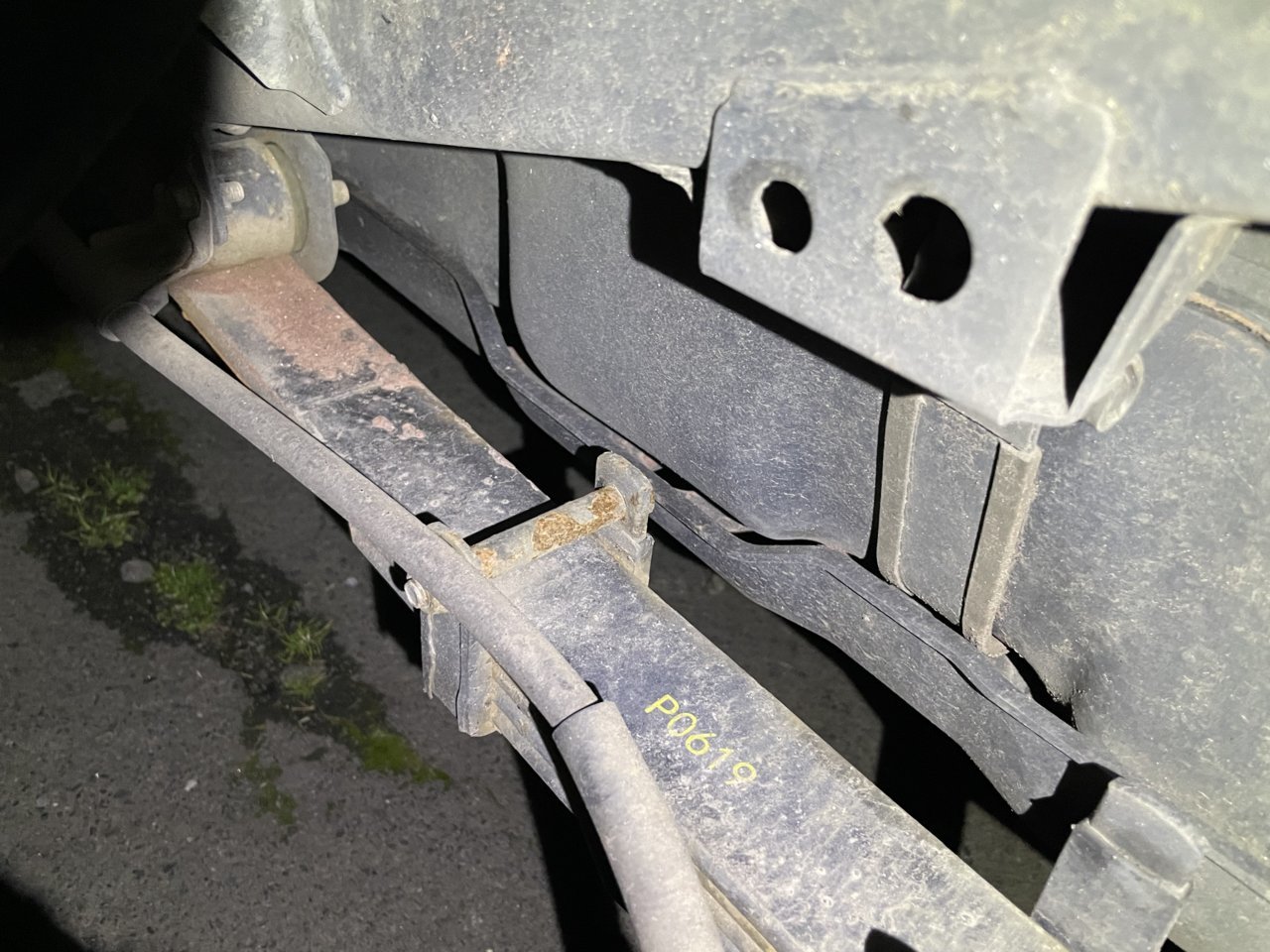

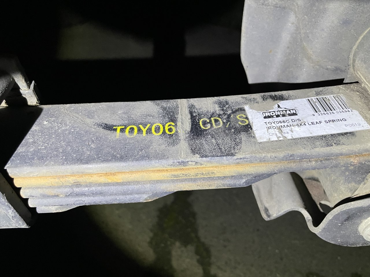

    I have the Constant Load leaf packs. I have the D/S installed on the driver's side and N/S on the passenger. (I recall emailing Ironman way back to confirm that by "D/S" that meant US driver's side and not the Aussie d/s. My back end came out pretty even in terms of minimal to no Taco lean.
    My D/S pack bolts were installed correctly with the bolt head on the tank side so there's no rubbing.
    I checked my N/S pack and the same bolt is installed with the bolt head facing outside.
    Does sound like somebody put the bolts on wrong with some of you guys. That blows. Hopefully there'll be a good outcome.
