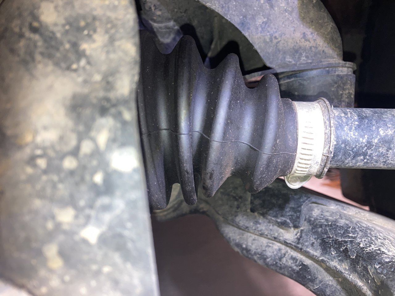

    those CV boots don’t look happy. You have that shock preloaded as F! 21” from top hat to lower center eye on the shock is about as much as you want for a good ride and longevity of components per Accutune’s recommendations

    Yea, my initial measurement/set was a lot higher than I wanted. I went from shorter/heavier springs to longer/lighter springs, and expected more spring compression than I got. Still dialing it down, I’d like to be just where those fins are not touching, or I can do the boot slide mod and use the special hose clamps I have that are designed to no tear into the rubber.
    I’m only dropping by 1/4” or so per attempt, since it’s easier to lower than raise it.

    those coils should settle after a 1000 miles or so. I went with extended 700# coils on my setup and it took about 1500 miles to settle

    Yea, I took a look at the cv boots after driving some more and I think they’ll be good, just slight rubbing. It’s still a little higher than I had with the heavier springs. I’m gonna get the alignment checked and drive it for a while, the ride is definitely better than it was. It’s a shame I couldn’t have gotten the lower related springs to begin with.

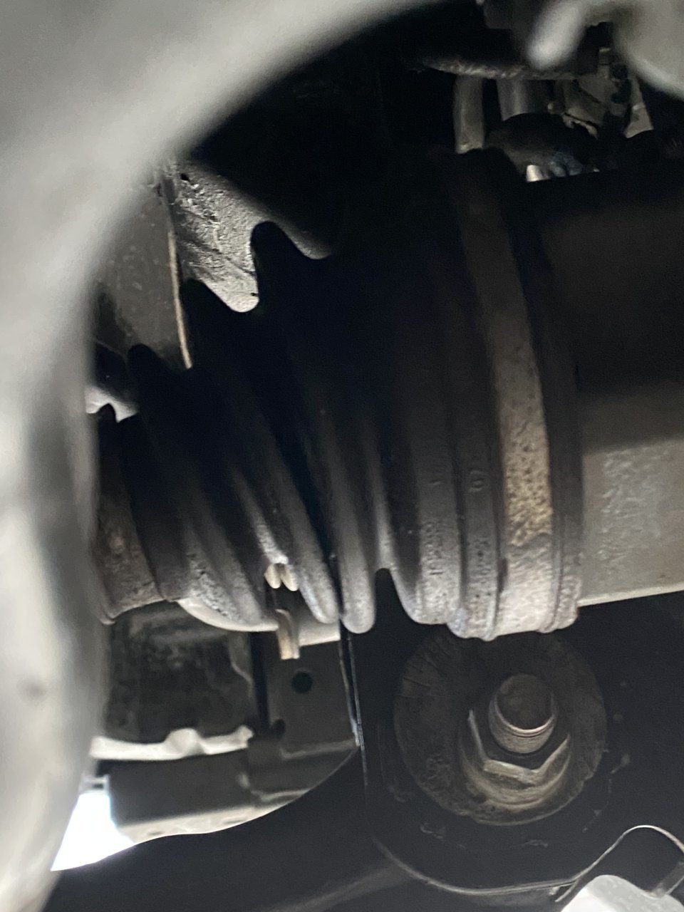

    i did the boot stretch mod. Zero shame :anonymous:
    been like this for years

    Boot stretch mod, you say????
    (have also read it can help to spray 'em down with silicone lube whenever you do an oil change.... the CV boots not cowboys!)
