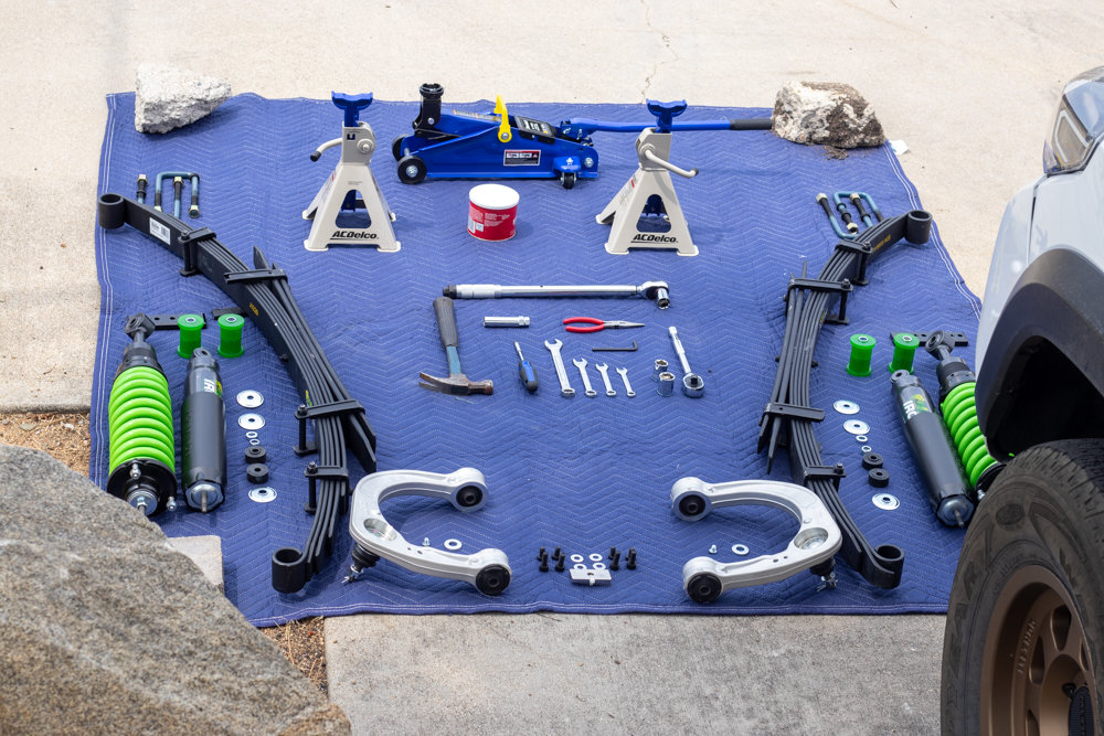

    I finally got around to getting my coil overs assembled and will install everything next week on my days off.
    set the drivers side coil overs to 8-7/8" and passenger side to 8-5/8" as per John L at iron man usa. I am curious about removing a leaf from the leaf pack so its not as stiff, if so which would I go about removing?

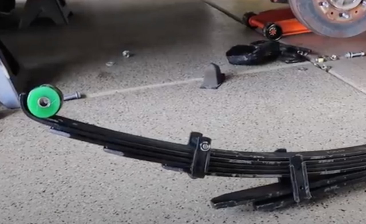

    @JMcFly Not sure which leaf pack you went with, but here is my experience with the constant load leaf pack. I pulled the 3rd and 5th spring (from the top) and am really happy with the ride. Currently running a RSI SmartCap and some knick-knacks in the bed. Nothing crazy, but rides good and looks level.
    If you're breaking down the leaf pack, I'd HIGHLY recommend scrubbing the leafs and re-painting/covering them. I've got chipping and rust which just doesn't look good. Since they're already pulled apart, take the time to respray.
    Also, based on recent finds, as you reassemble, double check your driver side leaf pack to make sure the bolt head faces in to prevent contact with the gas tank.
    Good luck with install, its pretty straight forward. Hardest part is UCA bolts, followed by the weight of the leafs. Share pics!!

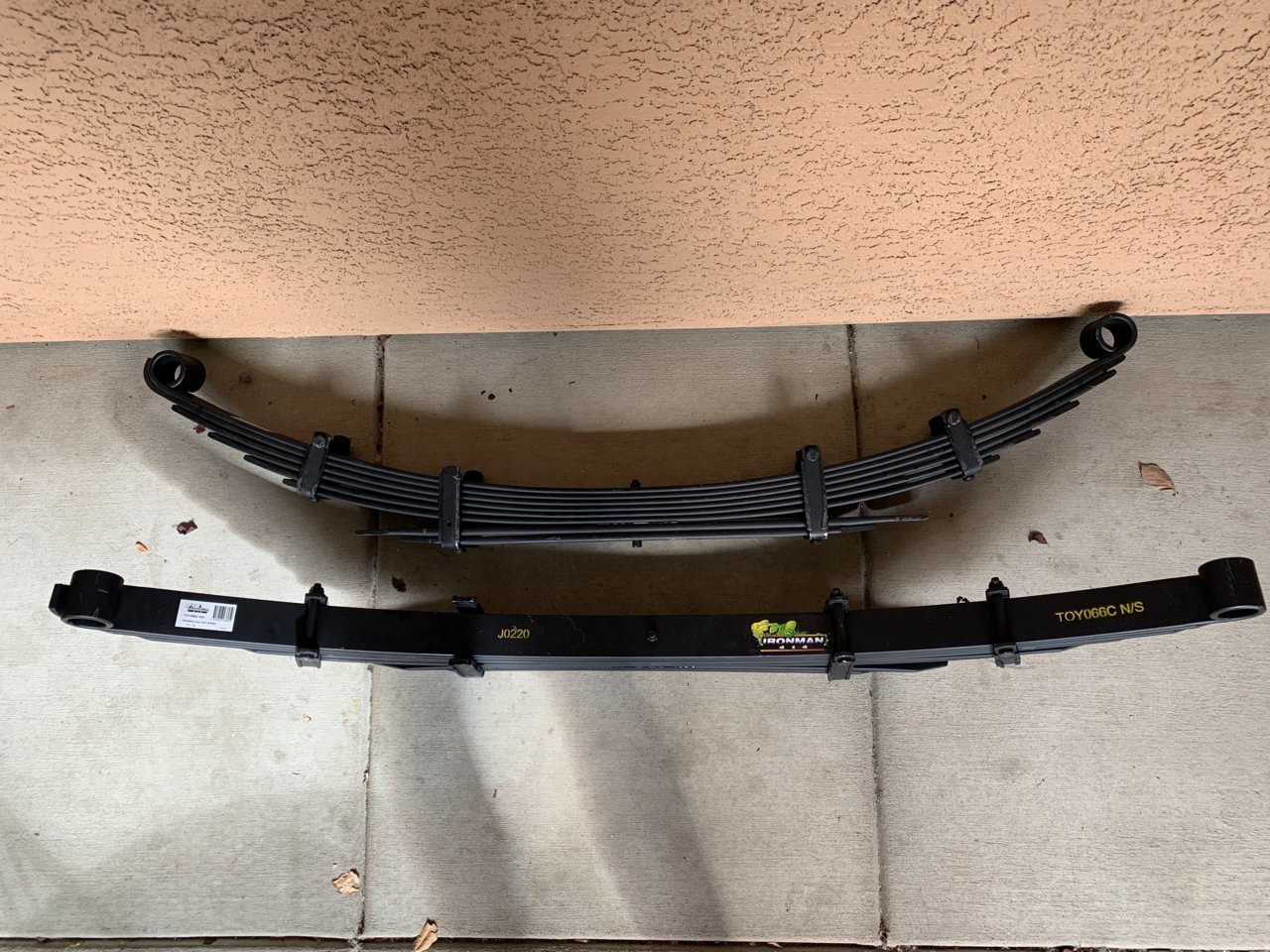

    Alrighty everyone. Super dumb question but the single bolt goes to the front of the of the truck while the two bolts go to the rear. And I saw I have a J code spring so on my D/S leaf I can just swap my bolt heads around? Still looking for a free weekend to install..
  8. Feb 19, 2022 at 5:50 PM
    #2208
    LiquidArrogance
    LiquidArrogance Well-Known Member
    Aug 25, 2021
    #375204
    777
    Streets of Bakersfield
    2021 SSM Sport 4x4
    Yes, double bolt (with TOY### part number stenciling) goes toward the rear. Make sure the bolt HEAD faces the fuel tank.

    I have constant load leafs. How difficult is it to remove a leaf?
  10. Feb 19, 2022 at 6:04 PM
    #2210
    LiquidArrogance
    Aug 25, 2021
    #375204
    777
    2021 SSM Sport 4x4
    Not hard at all. You'll want some c-clamps to hold everything together (it's not under load so it's not going to explode or anything it just helps to hold them while you get the bolt off and bolt them back together). Just take off all the nuts you see, remove the leaf(s) you want to remove and then put it all back together the way you found it (with the exception of making sure the bolt at the gas tank is the correct orientation).

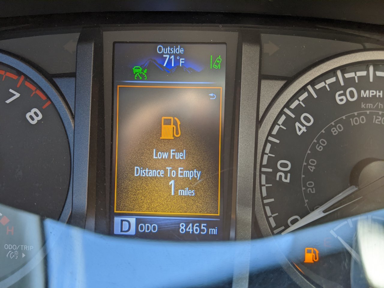

    Dropped at dealership for tank replacement this morning.
    PSA to be a bro and leave her empty if you ever need your tank dropped at the mechanic.

    I'm still a little impressed @LiquidArrogance made it with 1 mile to spare. I assume there is a 2 gallon or so reserve.

    Im very impressed as well. That’s pretty great planning there.
