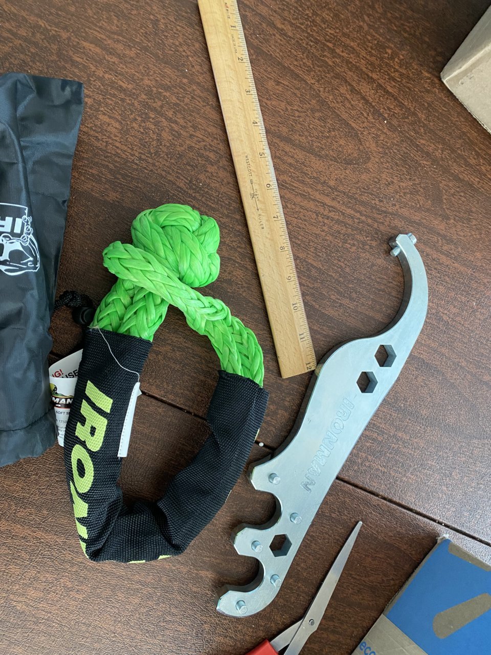

    Got the actual Ironman adjustment tool and larger rope shackle today. The tool is 1/2” thick steel/metal and pretty hearty. The little nubs are all the same so I guess if you break one you could swap it over if needed. I don’t know what I was expecting but it exceeded it. I also expected the shackle to be smaller. Both seem like high quality.
  17. Feb 28, 2022 at 12:37 PM
    #2277
    the.shelbysaurus
    the.shelbysaurus Well-Known Member
    Jun 21, 2021
    #369233
    313
    Colorado Springs, CO
    2019 Cavalry Blue SR5 4x4 ACLB
    Ironman 4x4 Foam Cell Pro, SPC UCAs, 285/70/17 KO2s, 1.25" Spidertrax spacers
    That thing is BEEFY!
