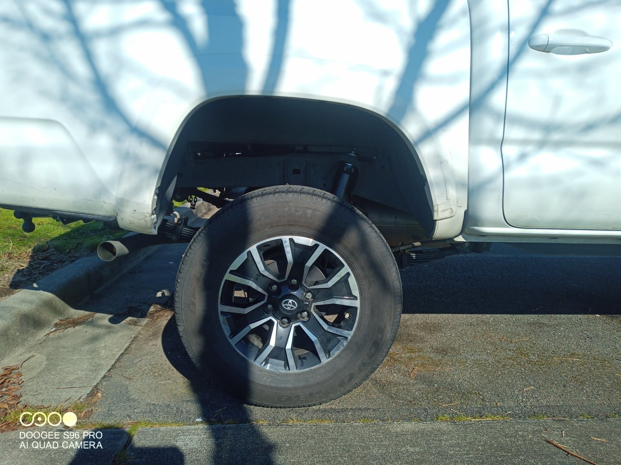

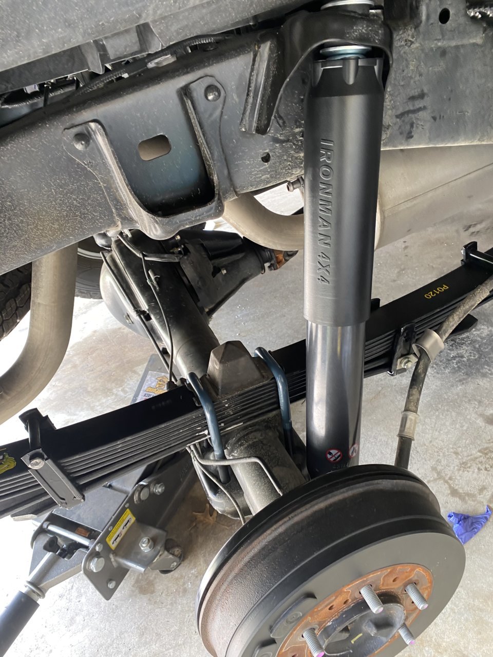

    Was installing my constant load IM kit yesterday. Almost done just need to torque the bolts today, mount the rear shocks, and some little things. Will look dumb with stock 265/65R17 lol bit on well till I get new tires. Kit was pretty easy so far. Hardest part was the UCA bolts and constant loads were a bear... I'll post pics later. Curious Im sure the are on right but I saw the front shock box have a d/s side and P/S side. Does that matter? The boxes were in a pile when I noticed.. also ditched that sway bar.

    It kinda matters. The drive side coilover should have a little more preload to compensate for the extra weight on that side due to battery, gas tank and driver. The DS shock usually has about 1/4” more preload. You can check by measuring the amount of exposed threads on each coilover.

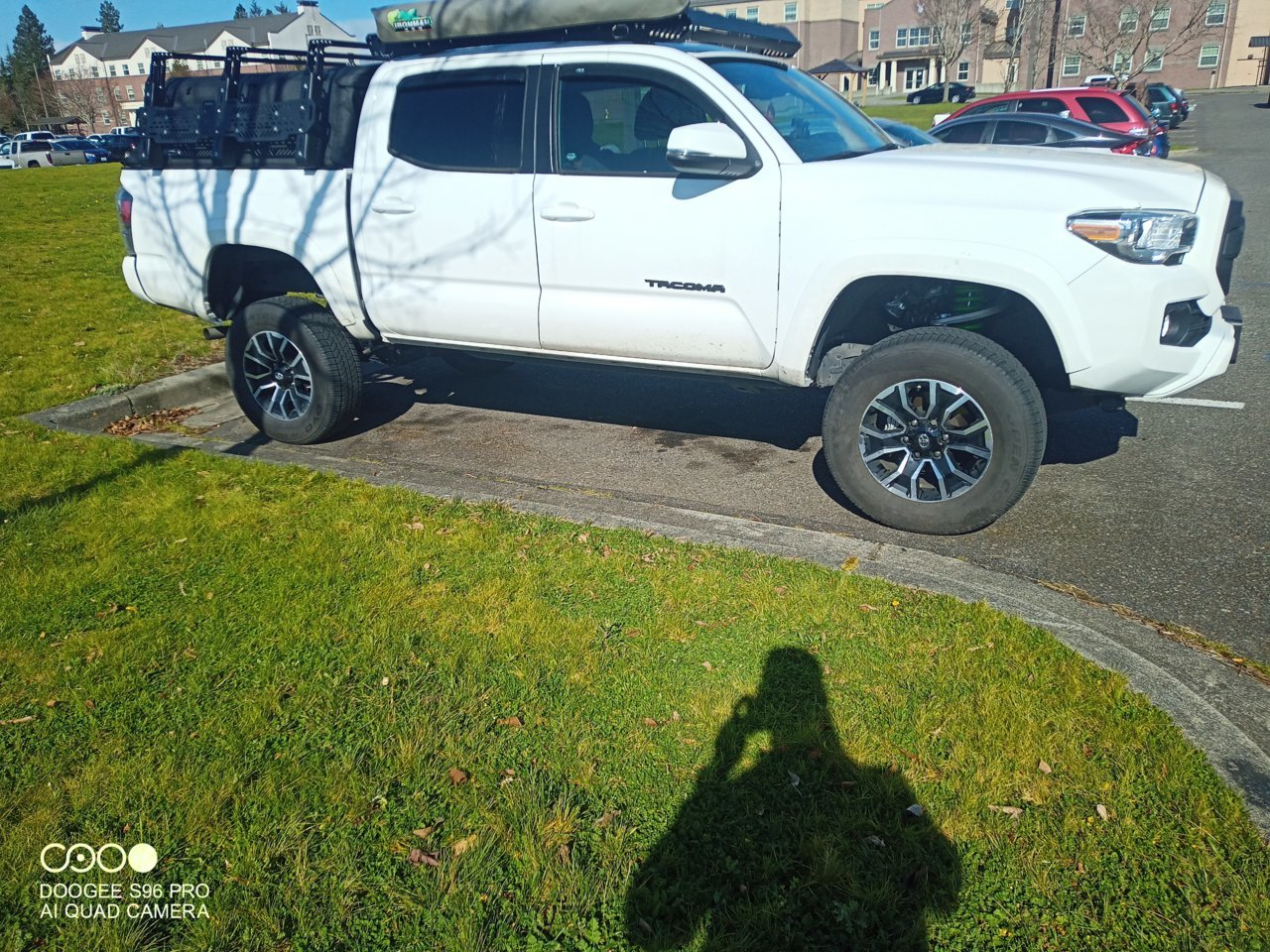

    Well, lift kit came out well. Later this week I'll have it aligned and soon I'll out on 32s or maybe some skinny 33s. Really happy with it and truck looks great besides the stock tire part.i have a small vibration in 1st to 2nd gear but goes away after 15mph. I would think it's because there's no alignment and or wheels/tires should be rotated and balanced. If this continues well ill ask questions here or just do a TW drive shaft.

    Definitely need bigger tires

    Question: I noticed when I buttoning up everything and checking the torque the ABS line bracket doesent fit back on the leaf. Even if it did; it looks like it would cause stress on the line. What worries me is that leaf spring bolt rubbing or getting caught on the line. Anyone else have this issue? I've thought about putting some type of foam around the line

    2020 Black TRD OR
    Ironman Stage 1 Foam Cell Pro lift kit, 255/85/16 Cooper ST Maxx, SCS BR6 Wheels, SPC UCA, Heated seats, MESO TRD start button, Meso Total Tail v1, Meso V5 mirror white DRL turns, bed decal, ditch and hidden bumper lights, screen protech, RAV4 radio knobs, steering wheel anytime camera kit, dash cam, ECGS bushing, Timbren Active Off Road bump stops with Wheelers flip kit. 35% Xpel CS Ceramic Tint, KD Max Tune, SumoSprings front bump stops, RRW Sliders ‌ ‌ ▲ ▲‌ ▲
    I’ll take a look at mine. I don’t remember having any issues or messing with that but that does not mean I didn’t.
    Could it be the ebrake cable and not the ABS?

    That’s kind of odd then. I don’t remember there being any other type of bracket there and I think that was just the stock bracket. Share a pic when you get a chance.

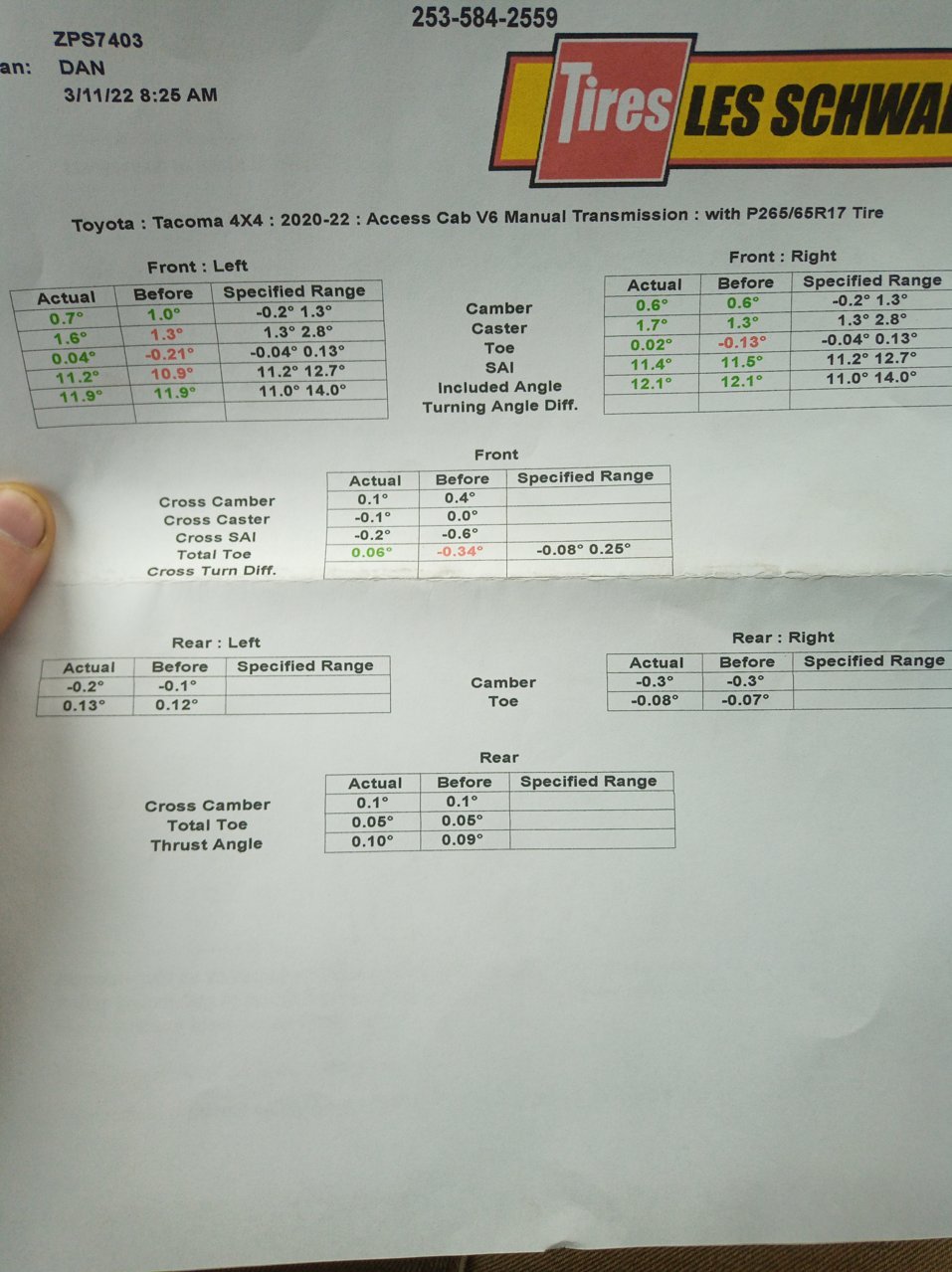

    Just had my truck alignment done. I have the specs I wanted but they couldn't get them maybe it's just Les schwab.. but are these specs good?

    Those look good, how does it feel when you drive it? Once you get bigger tires you’ll want to see about have the caster upped some. Maybe do that at home before you bring it in and ask them to keep it high even if it’s out of Toyota specs.

    Feels alot better ever since I had this done this morning and ripped off that sway bar. I get my new tires next Friday. I really wanted some big MTs like I had on my YJ but I have to remind myself I'm driving this back to WV from WA. A So I just did 265/70r17 Kenda klevers rts. Needless, IM 4x4 lift was easy.
