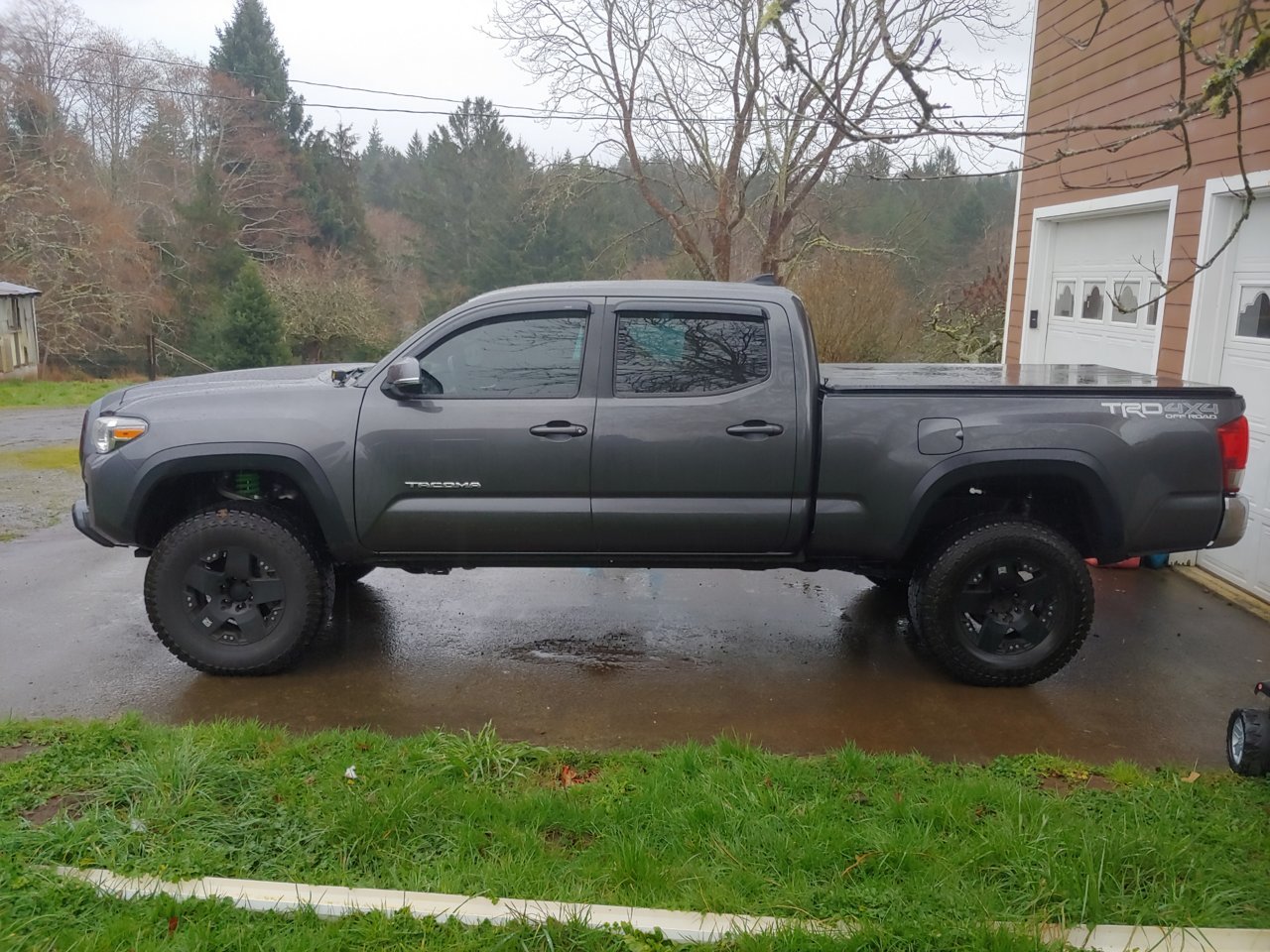

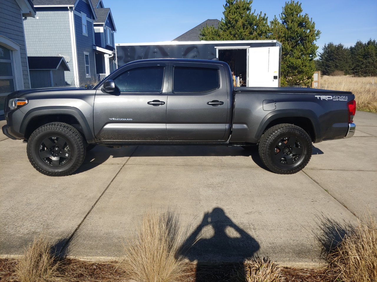

    Before and Afters. Also today hauled 3000 lbs of topsoil for a few separate trips. Suspension still felt great and I was sagging a bit of course but still had a few inches of travel before fear if really compressing to hard stop. Even with all that weight handled curves very consistently and controllably at 45ish on windey country (paved) roads. No bouncy, swaying sketchy stuff at all. I do realize that was quite overloaded passed payload rating. I really like the suspension.... But I didn't figure it would handle as well as it did with that load in it. I completely expected half sketchy and it wouldn't have even upset me if it was.... It wasn't. It was completely controlled.
    I realize this isn't quite scientific but imo another indication that this isn't a fluff suspension kit. These are Well valved shocks that really are heavy duty.
    On another note I got under truck other day to recheck torque. Glad I did cause passenger upper bolt was finger loose. Just a reminder to get back under there after install and some miles and double check everything.

    that’s a great looking truck!
    I definitely recommend checking torques as well (and locktite). If you have paint stripe for it, even better!

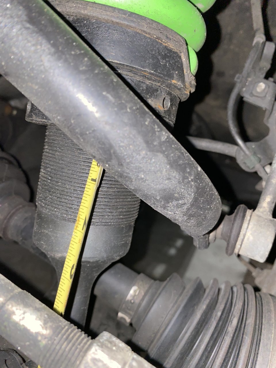

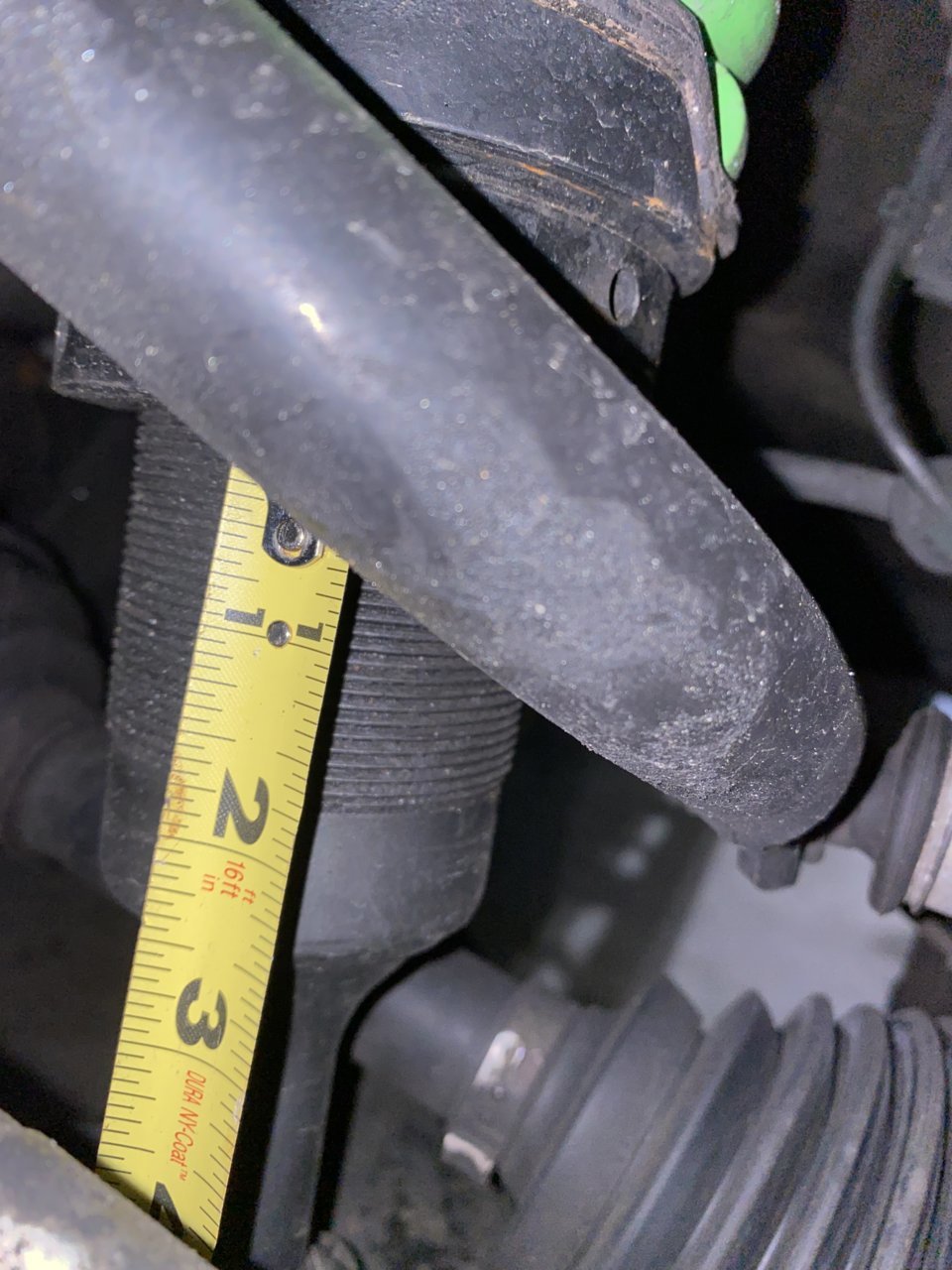

    Sorry if I missed this elsewhere, I've been skimming through trying to find it, but how much thread do you have showing now? I'm thinking of adjusting mine. I finally measured yesterday and have 2 1/8" of threads showing on both sides. Wondering if I can crank 'em up a little more while keeping my ride comfy.

    I’ll check next time I go out. I would think with non e rated tires you could go a little higher than I have mine and still be good too.
    Editing to say, my measurements might not help 100% I have about 200-260 extra lbs constant weight with sliders, engine skid and bed mat. I don’t know how much that’ll matter.

    Looks like about 1.5” of threads in one pic and closer to 1.75 I the other…. Both on the drivers side. That’s my truck from last week, it’s sitting about 23” from whee center to fender.

    Thanks man! Interesting, so mine are already cranked up more than yours (granted, not by that much on the one side). I might see if I can adjust 'em up a little more. I have a bit of a rake I'd like to get closer to level.
    When you adjust your shocks is this the way you're doing it? https://www.tacomaworld.com/threads/installing-5100s-without-a-spring-compressor-video.190159/

    Mine has about 1” difference from front to rear.
    I left them installed when I adjusted them. If I were to try and raise them I would still leave them installed, just remove the wheels, take the set screws out of the ring nuts, break them loose, by turning the bottom then try and move the top one. I’m not sure how tough it’ll be but it should be possible. The spring seat is separate from the ring nut and should not turn. If that does not work you might need to take them off, but then I’d try and find someplace with one of those wall mounted compressors and just compress the spring to adjust, if that makes sense.
