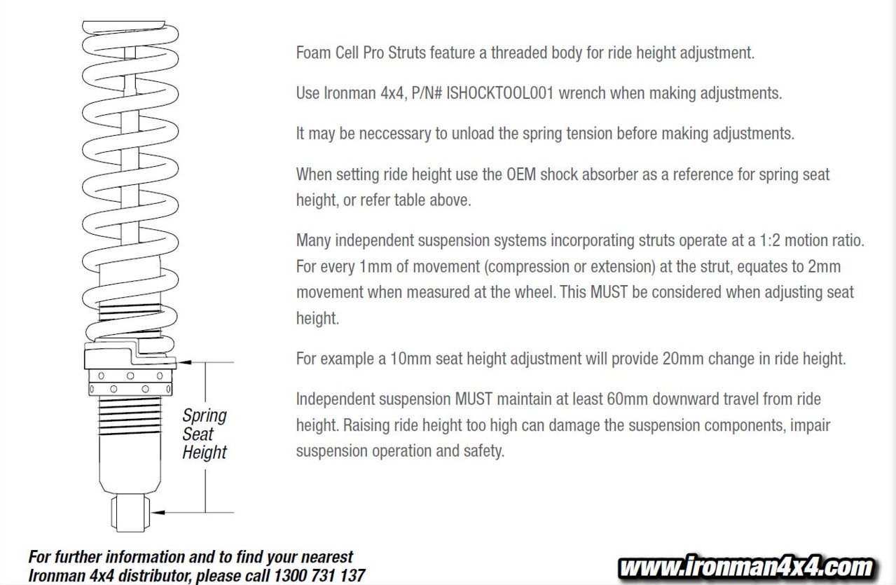

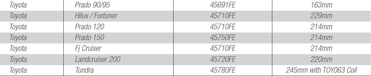

    I just installed mine, FCP stage 1...........the instructions says que spring seat to bolt center lenght be 9 1/64" o 229mm for tacoma, hilux and fortuner(boba says)......I was with a 2" front spacer lift, but now Im having harsh driving experience because it raised 1 1/4" more than before, so it's on a 3 1/4" front lift..........cv angles and all geometry to cranked up. What length did you guys used?

    not sure what is being asked here but, mine was set for a 3'' lift in front

    Refering to this setup on the perch for front shocks
