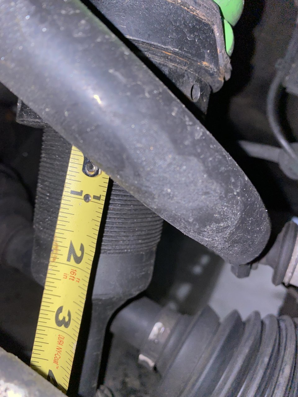

    So I was dumb. I thought that I could move the nuts up higher to start with more preload to compensate for my skid and sliders. That was wrong, I ended up with way too much.
    After several lowerings, while not very accurate, I’ve got about 1.75 threads showing on the drivers side and 1.5 on the passengers or from the spring seat sitting around 8.25” drivers side and 8.0” passenger side and had me at 2.5” lift. They have settled some and I’m thinking about raising them up a tad again. The tires rub a little again though the CV boots look like they’re at a good angle. These are old measurements and I’m not sure what they look like as of today. I’ll try and get out to measure again.
    Depending where your lift is at now, you might just try using the difference in spring height and lower it that much as a starting point.

    Sounds like you actually checked lol. I failed to check that and it’s where I went wrong. I checked my drivers side and from spring seat to middle of the bolt is 8” and I’m at 23.5” from center of wheel

    That was the toughest part and I’m sorry I didn’t even think about mentioning it. The first time I tried that method I failed… I read a lot more about the process and took it slow. I may have used a zip tie in there to help guide it.

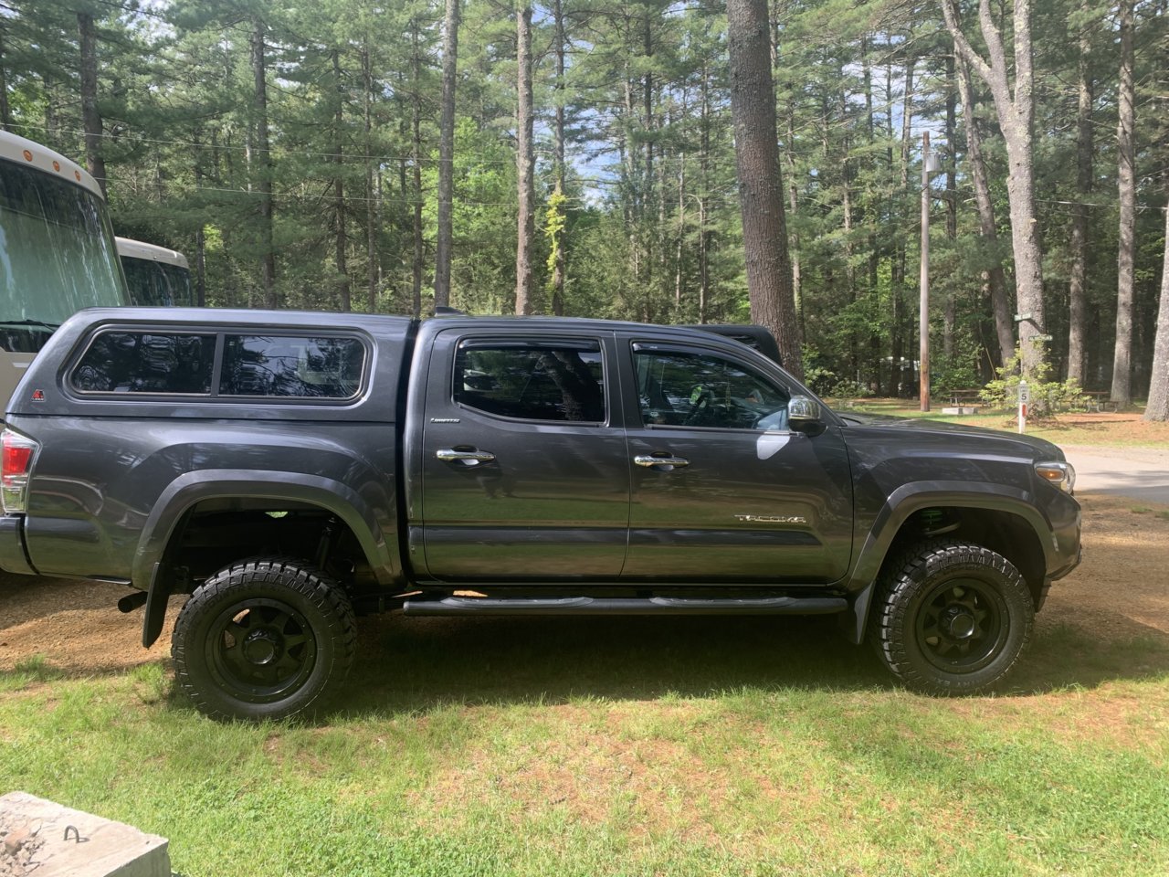

    What’s up everyone. I just installed the Foam Cell pro kit on my truck with 2.5 up front and the heavy leaf pack in rear. Rear is seriously higher than the front. I like the height in rear and would like to keep it that way. Ride is a great right now but the truck looks like it’s about to pounce on Mt. Everest. Any thoughts on somehow making the front work with the current height of the rear? Ironman recommends pulling 3 and/or 5 from the leaf pack or try raising the front but possibility of stiffening ride. This is my first Tacoma, just reaching out to see any solutions to the issue.

    Thats a nice looking truck! When you say heavy do you also have the heavier coils, the 820# set? If you do you could probably go up
    .25” without too much stiffness. Maybe if you ask them nicely, you could swap out the 820 for the 727# springs and go to about 3” up front. If you have normal LT tires, not E rated, I don’t think it’ll be that stiff but don’t quote me on that.
    Lastly, while you might like the back like that, you probably don’t have much down travel with it at that height. Might want to consider that too.

    Thanks @hyrule_trd. I did go with the heavier coils up front. I’ll be upgrading tires soon to a set of 285/70/17 Nitto Ridge Grapplers from the roller skates on them now 265/65/17 soon. I might use the truck for light off roading but mainly doing work on truck for looks (Use my 04’ TJ to run stuff over) I’ll check the down travel once I have tools (currently living in my RV before I move to VA). In addition I’ll be adding a swing out bumper at some point and not sure how much that will affect the rear height. I appreciate the info/ recommendations.

    Thanks, IM reps recommended the same. How much higher than the front are you sitting at? My wife has to drive my truck 600 miles next week and I don’t have the resources (tools/garage) to take the leafs out right now. I’m hoping I can find a shop in my area that can do it before she has to take the truck.
