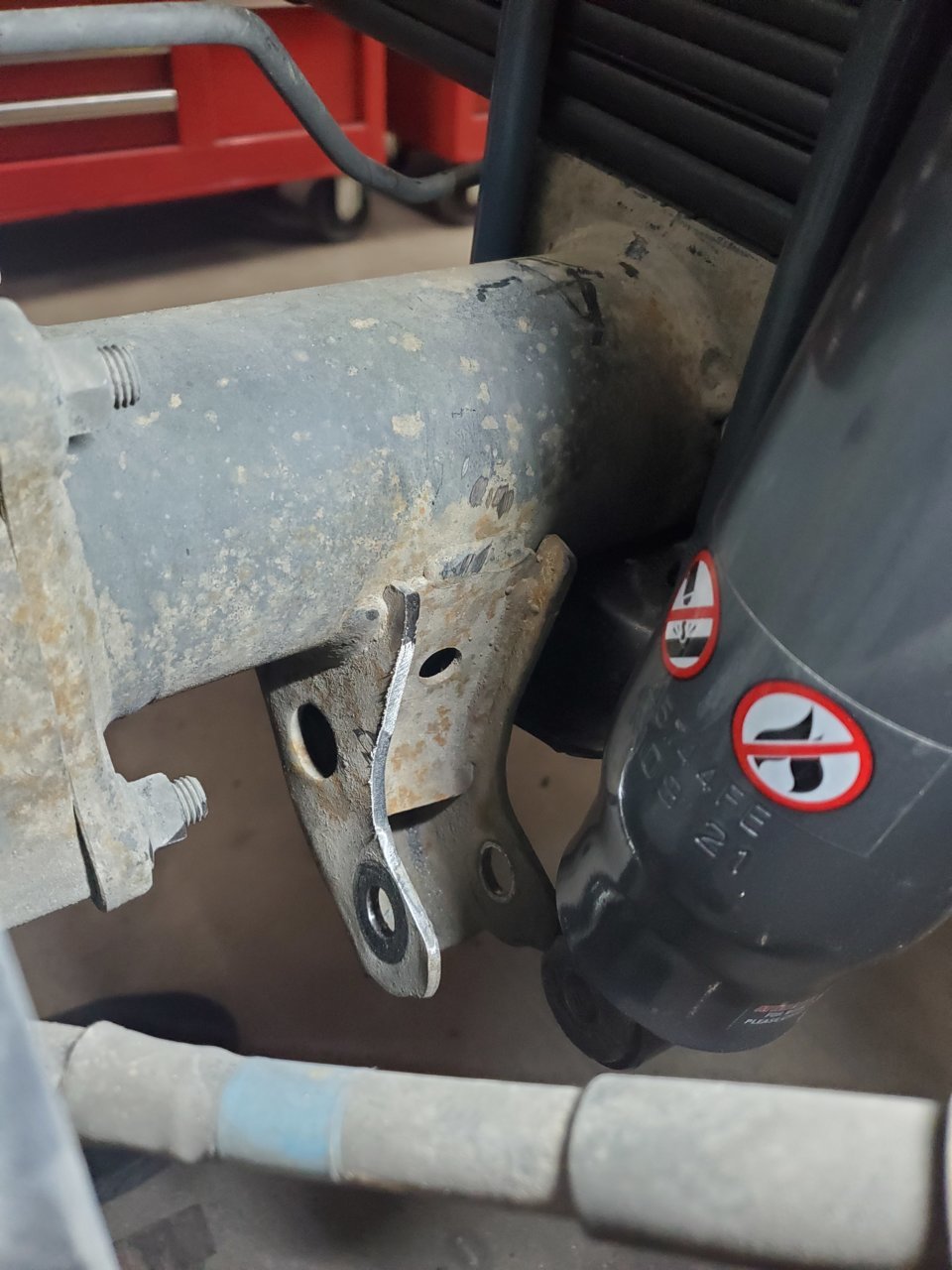

    Mine's a prerunner and I didn't have that issue. I do know a lot of people, myself included, that have the shocks sitting uncomfortably close to the tabs you trimmed. Did they actually interfere or did you do that preventatively because it looked close?

    Welcome to the club! Sorry to hear you’re having an issue. It sounds like you tried what I would suggest, swapping them side to side. On mine, the stickers were pointed inward and would only fit in a specific way. I think the bolt holes/eyes are slightly offset to clear in one position.
    I think that’s what you’re talking about. I don’t have any good pics of those on mine but good luck getting them to fit.

    Posting on behalf of my husband's '09 Prerunner
    RSI SmartCap, Ironman4X4 heavy duty suspension, awning and rooftop tent, solar panels, full custom kitchen set up, Black Rhino Armory wheels wrapped in Hercules Ventures. Full build coming soon to All Girls Garage, season 11, episode 9, airing 8/27/2022!!!!
    Ah thanks for the quick Prerunner response! Ours is long bed access cab. Not sure if that even matters, but for the sake of data and science!
    They *actually* interfered - they hit and flaked off a little bit of paint on the passenger side shock before I caught it the driver's side wouldn't even install (bolt hole wouldn't line up) without the slight shave, even with the transmission jack loading the suspension as much as I could before the truck started coming up off of my lift.
    I'm thinking that once we drive it home (1300 miles) the springs will settle more and perhaps the angle will open up a bit, but we only had one work day to install the full kit and so I just had to keep moving :/
    Yeah, same! I started with the stickers facing out, eventually landed with stickers in like yours. I tried every combo. I installed the darn things four times like a fool before giving up and shaving the brackets

    Lol, I can imagine, I did the same thing a few times before they fit. I’m guessing the rig they used to weld the bolt mounts could have been slightly off or maybe something else in play. Sorry I can’t recommend anything else to help. Hopefully you’ve got it in a good spot now though with clearing a little material out of the way.
    The only other though I could even have is the axle being rotated slightly, but seeing in that pic it’s snug to the leaf pack and no shim, I’m pretty sure that’s impossible.

    You're not alone! Mine is also a long bed access cab and I had this same issue, but only on my driver's side. Tried the shocks in different orientations, swapped sides, everything I could think of before grinding it down.

    The shop had my lift done at(they’re one of the best off road shops in Portland and work closely with Ironman as they’re 20 minutes from the headquarters) pretty strongly recommended the SPCs over the IM. They said the IM UCAs are good, but the SPCs are just better.
