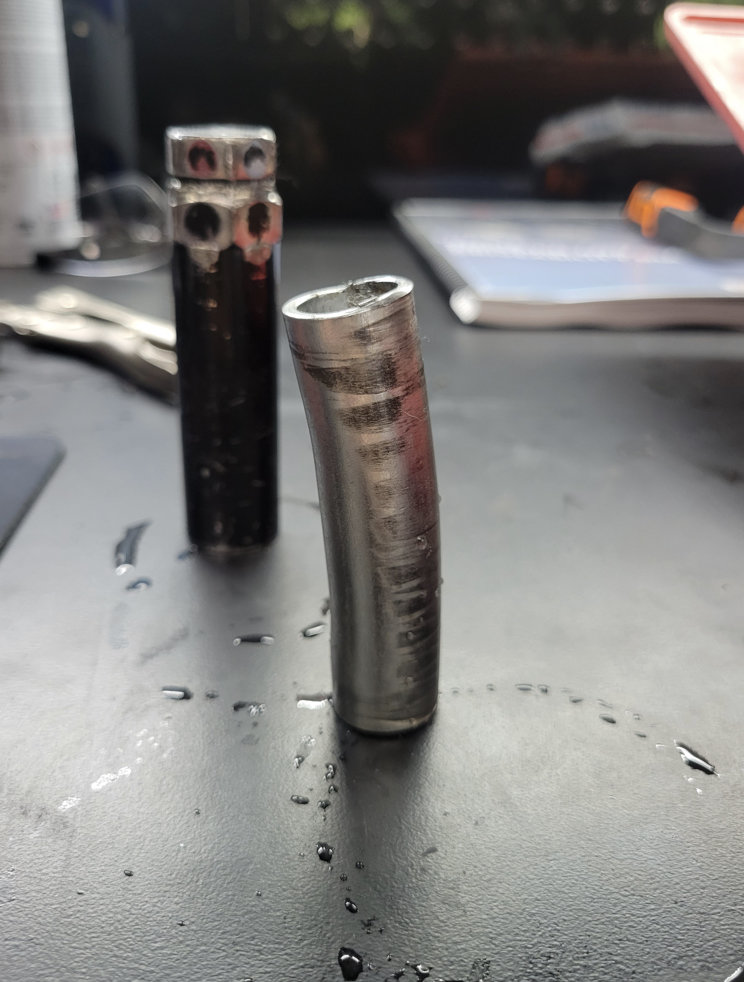

    Sadly, this didn't fix my squeaking... Not sure how the center sleeve would bend like that when torqued to the correct spec. Ended up having to air hammer out the bolt and retap it. My plan is to remove them once more and regrease the crap out of everything... if that doesn't work I'm going with a different leaf pack.

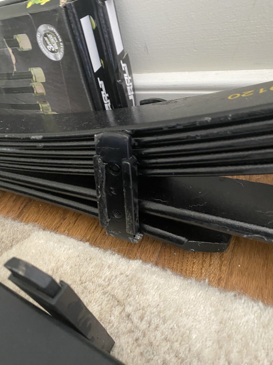

    Might not help at all but I’ve seen a few posts about the saddles (not sure real names) touching the leaf packs and causing the squeak. Try a few hammer hits to see if that helps. Good luck!
    Superhulk LB[QUOTED] likes this.

    I’ll have to investigate and see what it looks like around those “saddles”.

    I've loosened the bolt and greased between the "saddles" as well. My noise is definitely coming from the bushings.
