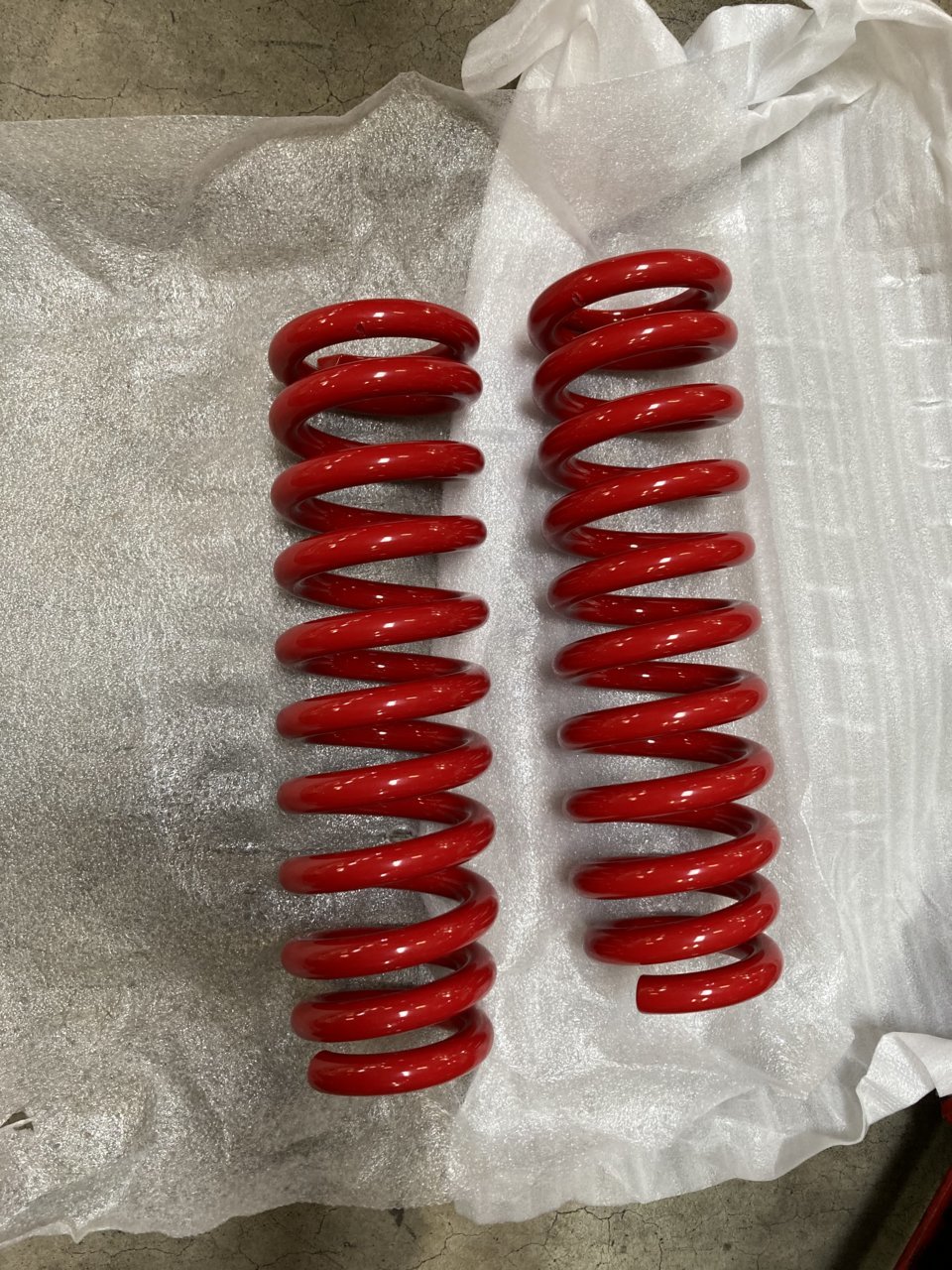

    Powder coated “TRD red” because I thought green wouldn’t look all that great with the wheels.

    Those look good with the red TRD on those wheels!

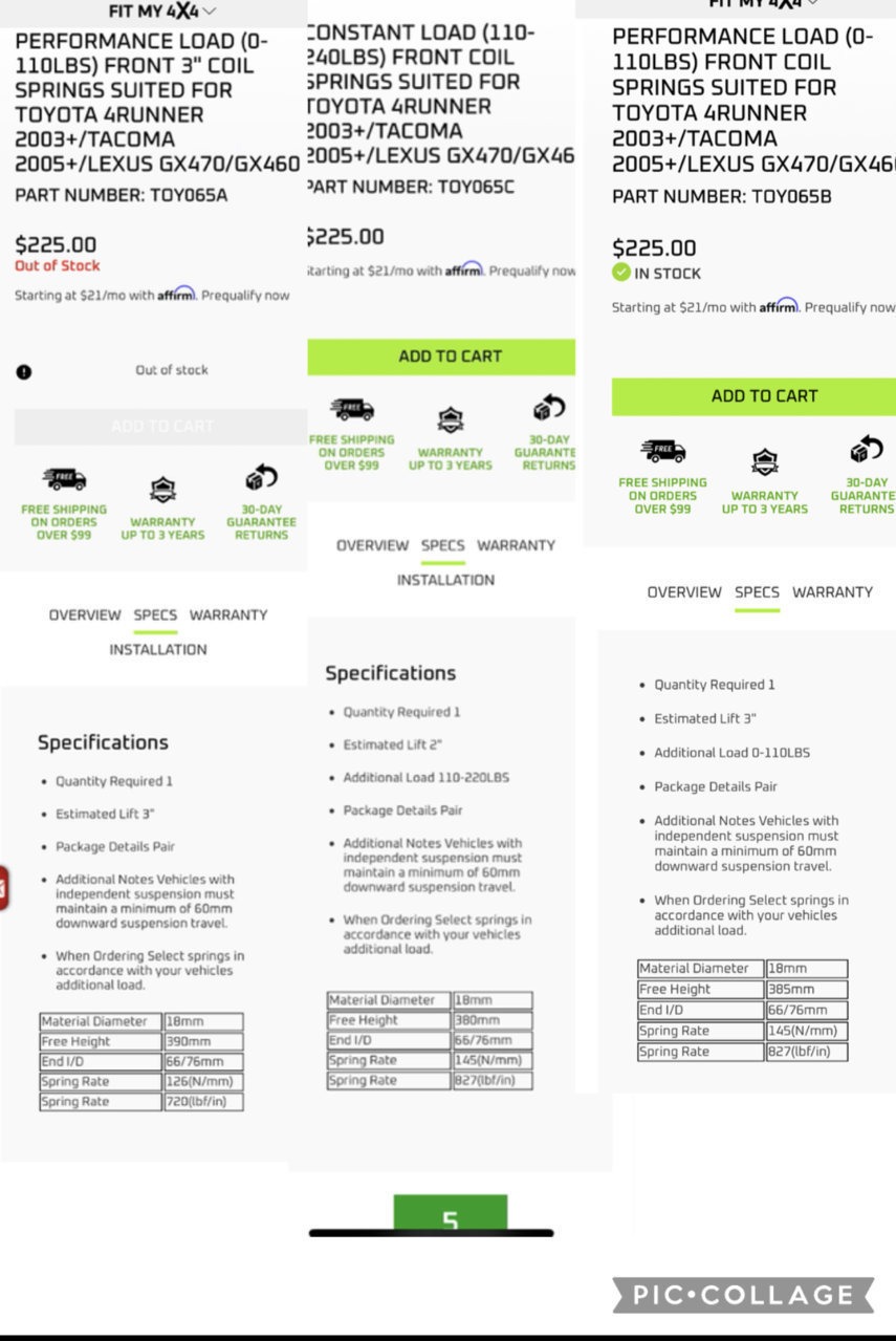

    My questions may have been covered but....
    I'm strongly considering the Ironman shocks for my 2008 Tacoma but have a question on the spring rates listed for the springs. It looks like all the springs for the tacoma are listed with the same spring rate at 827 (lb/in), this doesn't make sense. There should be a difference between the Medium load 0-110lb and Heavy load 110-220 lb. I assume this is listing error. I thought the stock Tacoma OR gen 2 had 600 lb/in coilsprings, I could be mistaken and they might be 700 lb/in. Accutune page suggest it is 600. 827lb/in is huge.
    1. Is there a light or 0 addition weight but 2.5' lift coil spring? If what is the spring rate?
    2. What are the spring rates of the various springs that fit the FCP shock for the Tacoma?
    3. what are the spring rate and lengthen options?
    4. would other springs fit? Specs on the page post End I/D:66/76mm. Has anyone used other company's springs on the FCP? it would also be nice to stay away from the green.
    Heavy coil spring:
    https://ironman4x4america.com/heavy...t-coil-springs-suited-for-2005-toyota-tacoma/
    Medium:
    https://ironman4x4america.com/front...-load-0-110lbs-suited-for-2005-toyota-tacoma/

    I pulled this from the other thread. I would go with that 720 pound coil, I believe its the lowest one that they offer.
    hyrule_trd and Wile_E_RedDog like this.

    For some reason you’d need to search on their page with the part number to find the lower rated springs. I started with the heavier and ended up putting the lighter ones on and have been really happy.
    It would be tough to use other manufactures springs on the IM. IM has a flat top and curved bottom. Most others are flat on top and bottom. With the spring perch on the IM, they won’t sit flat. Could you remove the perch and have them sit on the top of those two lock nuts? If you’re confident nothing will happen. I had looked for an isolator that had an inward curve and was going to try if I could find cheap springs. After reading and thinking it just wasn’t worth it. I’m not sure what the 2ng Gen are but the 3rd Gen OR coils are around 730 as tested by @Toytec Lifts
    Last bit, several people have gotten the springs powder coated a different color, with @RTweet being the most recent I can remember. If you look for threads by my name, I have my review and then a megathread I started for the lift.

    LOL, thanks. I had initially missed that option while searching the site.
